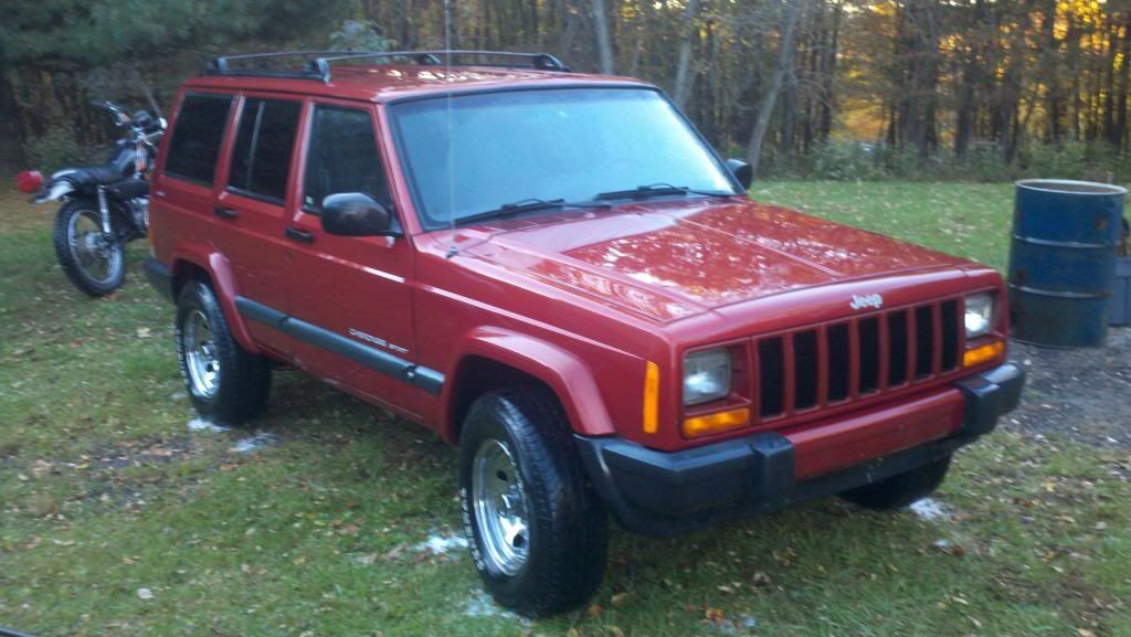

So here's the start of a mild build thread of my 99 xj. Last October I found myself in need of a new vehicle. My last ride was a 95 yj (which sadly succumbing to rust from the PA winters) was not going to be inspectable due to frame holes. I found Ruby on craigslist south of Pittsburgh for $1500 in non running condition. I got it for $1300 pretty much knowing I'd be in for at least a head job. Only reason I paid that much was that the PO had receipts for $1900 in a new exhaust, new tires, brakes, tie rod, and ball joints.

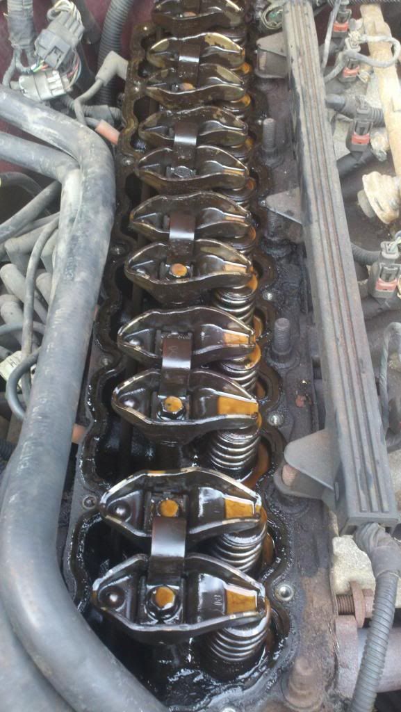

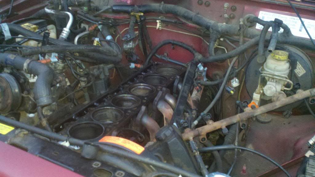

Thanks guys! I actually wanted a firebird but the cherokee was the more practical choice. lol. Now first on the agenda was to see if I could get the jeep running so I picked up a used starter from Davey's Jeeps for $25. Here the battery was dead because the jeep sat not running on the side of the road for 6 months. It ran good with a little loopy idle but the oil pressure was at 60 so that was my main concern. I checked the oil cap right after and found the oil all coffee colored so my bad head suspicions were correct.
So soon after:

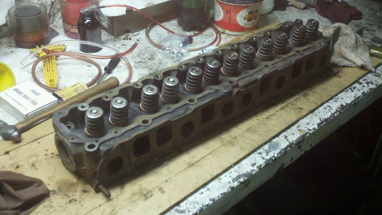

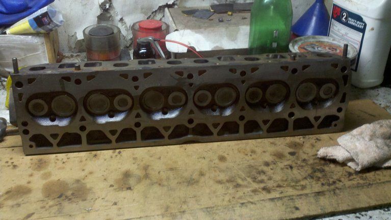

So the head on it was badly overheated and hopelessly warped and cracked in numerous places. Dang 0331 head. So I lucked out big time and found a 0630 head for $20 on craigslist. That one checked out good and got the overhaul treatment with some touching up of the valve seats and new seals with a light truing up of the head deck. Only difference was to plug up the temp hole in the back of the head. My only other concern was the new intake/exhaust gasket had a lot of overlap. I didn't trim it due to the 35-40 degree temps outside and no garage, plus I needed it together because my inspection for the wrangler was up in December.
I give all the credit to Bolland machine for doing a good job with the head work. They even saved me a little cash by saving my old valve springs by shimming them up.

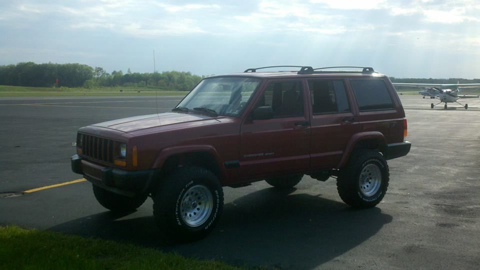

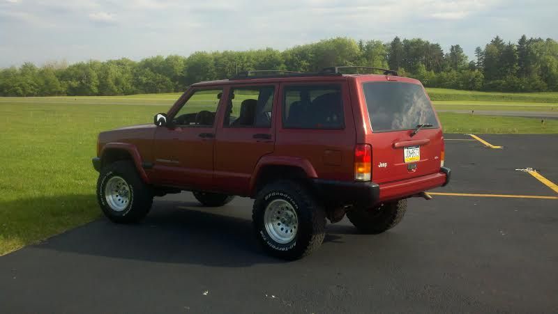

Well the end of 2012 finished with me parking my old buddy the Yj. I felt really bad parking my daily driver of 10 years but necessity for a reliable daily driver takes premise. I will get my wrangler back but only when the xj is able to take on the load of driving me back and forth to work reliably. A couple shine up pics of Ruby in my outdoor garage, spring of 2013.

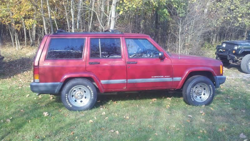

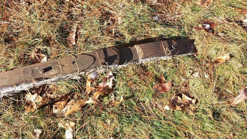

So my rear springs were all sagging and some of the leafs were missing chunks and cracked. I weighed the options of replacing factory springs to a lift and found that the trailmaster 3" kit was only $75 more.
You can see how bad the springs really were. I had to cut off the main eye for the front of the leafs to get them off. The whole lift took about a day to do. I broke every rear shock mount bolt off too. I got way more lift than I wanted. The back ended up at about 4.5" while the front was the advertised 3". I put some more coil spring isolators on the front to level it out. It looked dumb with the 235's so I stole the 31" BFG AT's from the wrangler. Dang jeep is growing faster than my wallet again.
