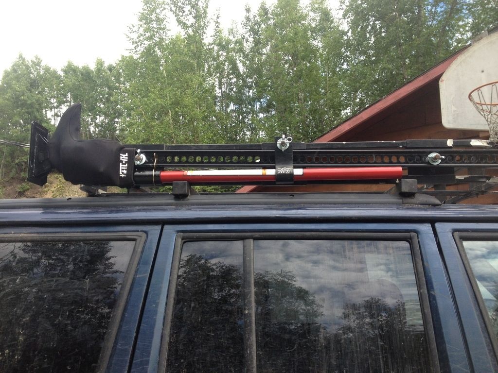

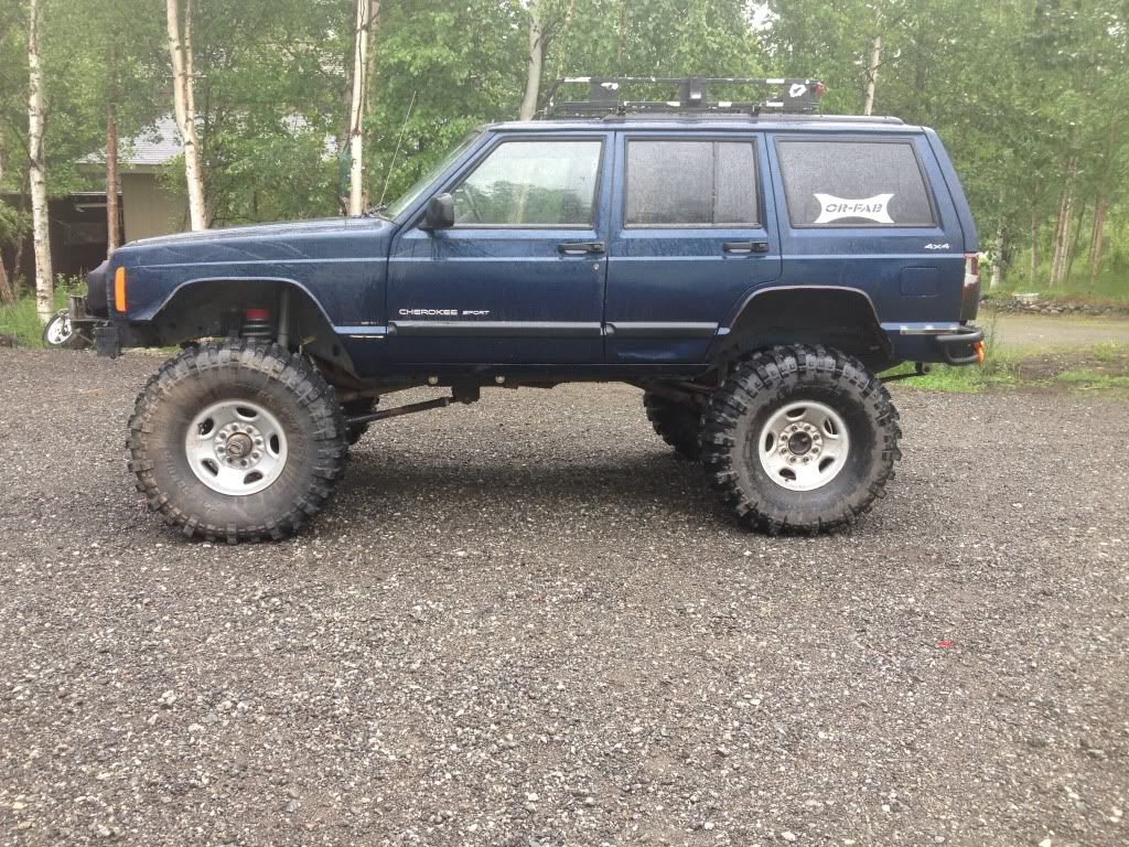

I removed the two sliding bars on my stock rack and mounted my Surco rack directly to the fixed rails of the stock rack. There are ten 6mm threaded inserts and screws holding the fixed rails to the roof. I used 80mm X 6mm cap screws to bolt my Surco rack directly to the roof.
This option gets your rack much lower to the roof and you don't need those unsightly gutter rail brackets that are prone to damage if you wheel a lot in tree'd areas.
this method has proven to be very durable.
Not the best pictures but looks like this.

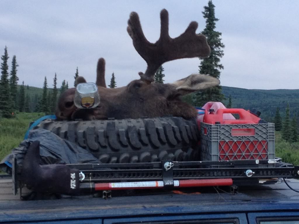

I mounted the rack a little more forward than many others so I could keep the weight more toward the center of the vehicle. I normally carry 150lbs on the rack at all times and it routinely sees in excess of 350lbs.
Here it is all loaded up. Obviously for a stock or slightly modified suspension this is way too much weight on the roof of your XJ but the way mine is set up it works great.
Spare Tire - 110lbs
15 Gallons of fuel - 90lbs
Moose Head - 75lbs
Moose Hide and Guts - 50lbs
High Lift Jack - 35lbs
Axe, Shovel and Light Bar - 20lbs
Total 380lbs

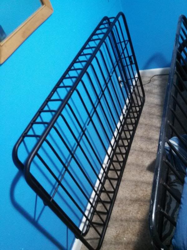

Check out this place www.discountramps.com they are kind of cheap but I don't need to carry a lot of weight just some folding chairs and stuff for camping . Mine was $99 and I grabbed a cargo net for it also just one thing to remember with any of these tubular racks coat the inside of the tubing if you can they always rust from the inside out . and of coarse the one I bought is on sale !!!

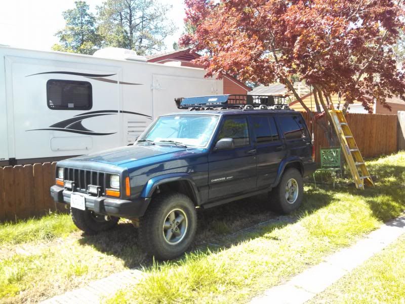

That curt rack the silver XJ ad earlier is what i have and with 4 cross bars it is VERY sturdy! and you can flip the Air Dam like i have

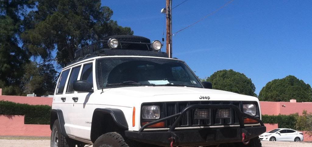

Here's one

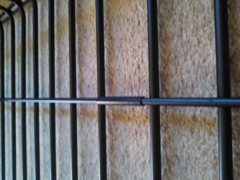

I didn't like how the extension for the Curt basket didn't full integrate so I bought some 1/2" steel tubing and made sleeves to fully fit the 3 pieces together.
Mounted it a few days ago.
Used the thick plastic mounting blocks between the bars to make my Hi-Lift mount.
