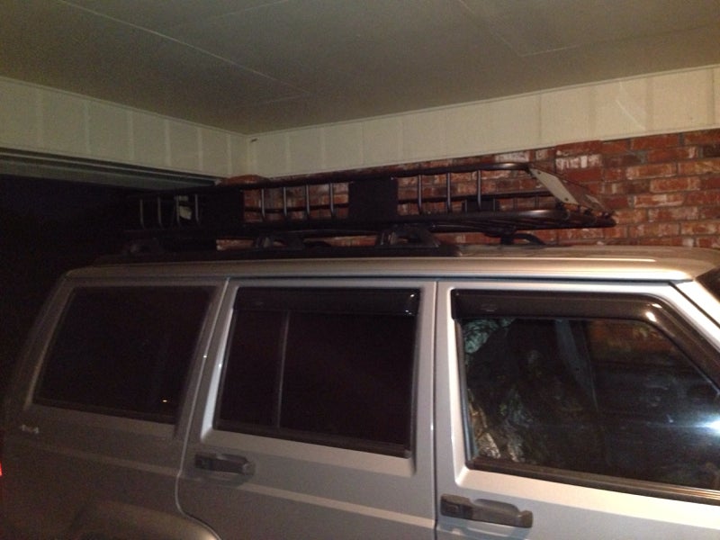

I just put the Curt rack on my XJ. I bought the rack and the extension. In fact the extension just showed up today. I am going to use Three of the stock Jeep cross rails. I've put an 80 pound kayak on two rails and it didn't even flex. Adding another cross rail with the Curt rack should increase my structural weight limit by a small amount. I am going to see how much it will hold for sure. I made a video showing the unboxing and me putting it together. Not hard at all. It looks great and from amazon.com I paid $130 shipped for the rack and extension. Can't beat that. I'll post video on YouTube later and post it up here.

Just finished installing mine A few minutes ago! Freakin Sick!!!

Very nice! How much did it cost you out the door?

$130 shipped to my front door. Got them from Amazon.com
