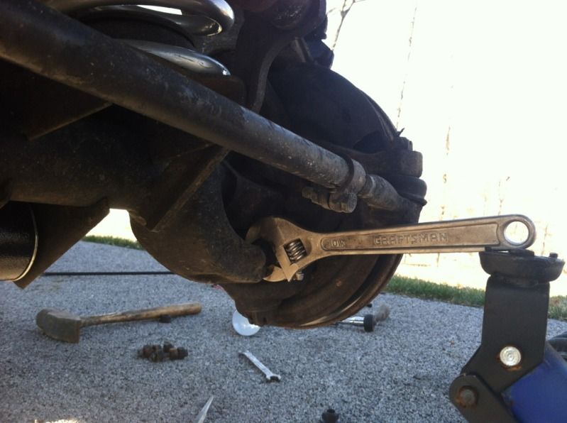

I use kind of a ghetto way, but works great. Bottle jack to push axle forward, jack under the wrench to keep caster in line. Pictures make more sense:

I like that way, Vegas. I've always done it with ratchet straps or comealongs but it's such a pain. I very well may try your way
