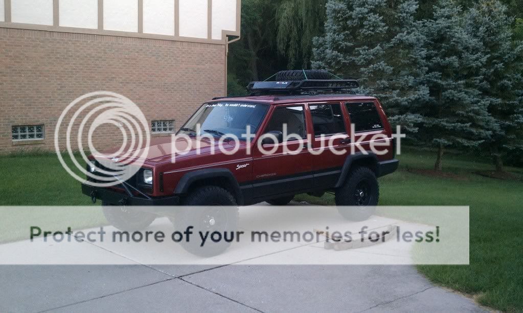

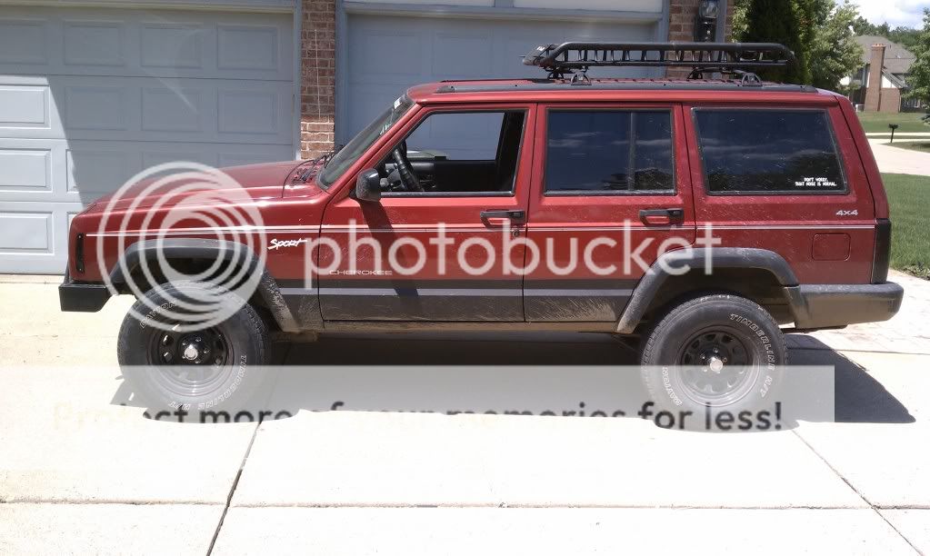

2" and a bit bigger tire wont really do much to your gas mileage. i averaged 20 driving across the country with 30" tires and 2" lift. 29's will look just fine, i'll give you pics of my jeep with the 29's and then the 30's
with the 235's (brand new leaf springs are a little stiff still in the rear for these pics)
with 30's
