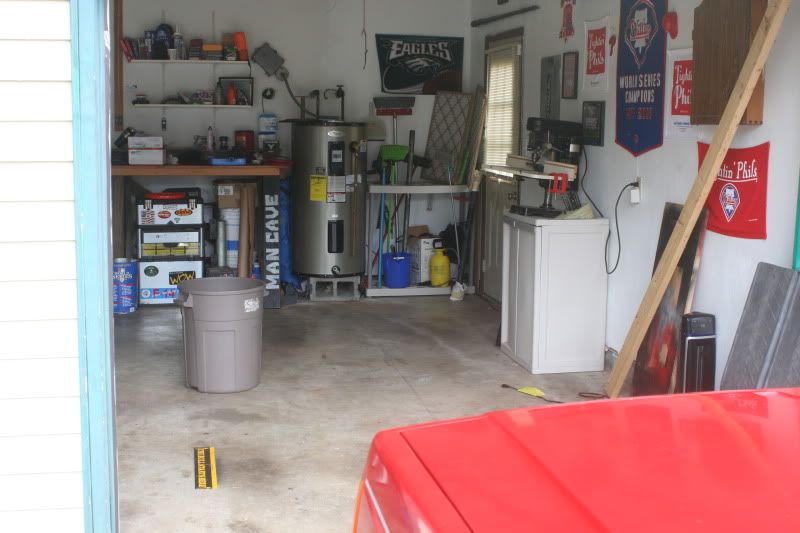

Got a little done today. Mainly a houskeeping day and ordered a new muffler.
Its so much nicer to have it all cleaned out.
