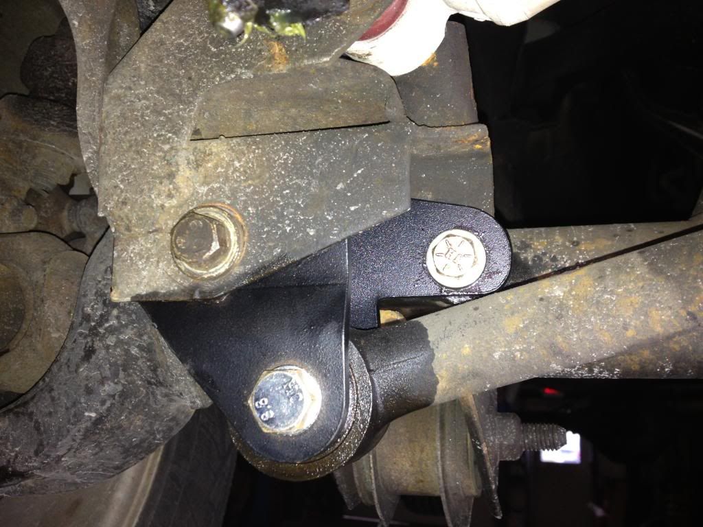

Got a dropped track bar bracket from Fat Bob's Garage, installed that and new rear driveshaft U Joints. The front axle is now centered!

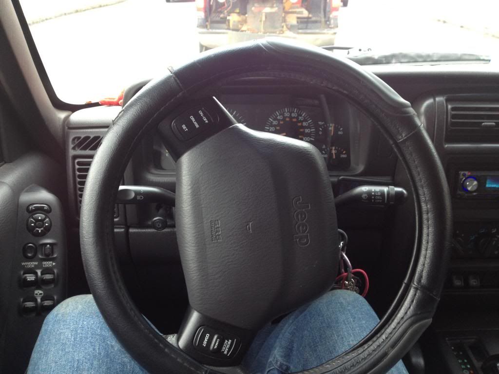

The wheel is turned like this, until I go for an alignment

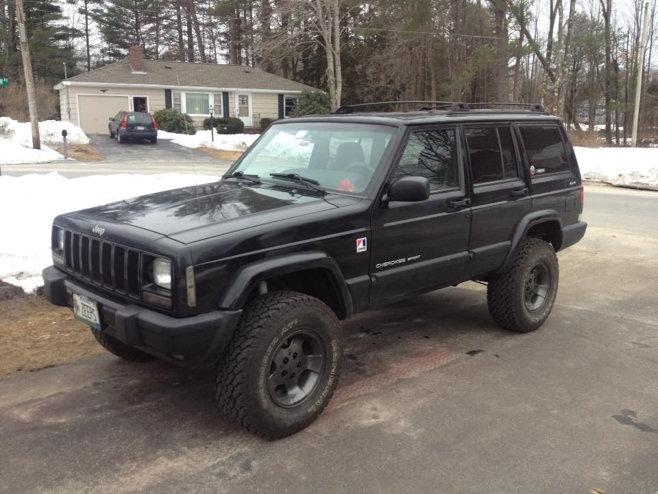

Wheels and tires are here today!
Alignment at 6pm (friend at big name tire shop doing it for $20)!
The rear end has settled down some, so it doesn't look ridiculous anymore.

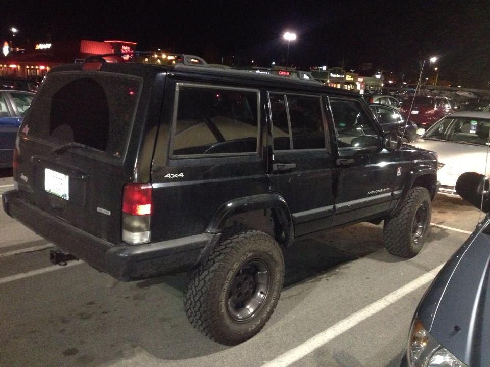

And it rides great too!
Alignment done, wheels on.
Quick pics before it got dark, better ones tomorrow.

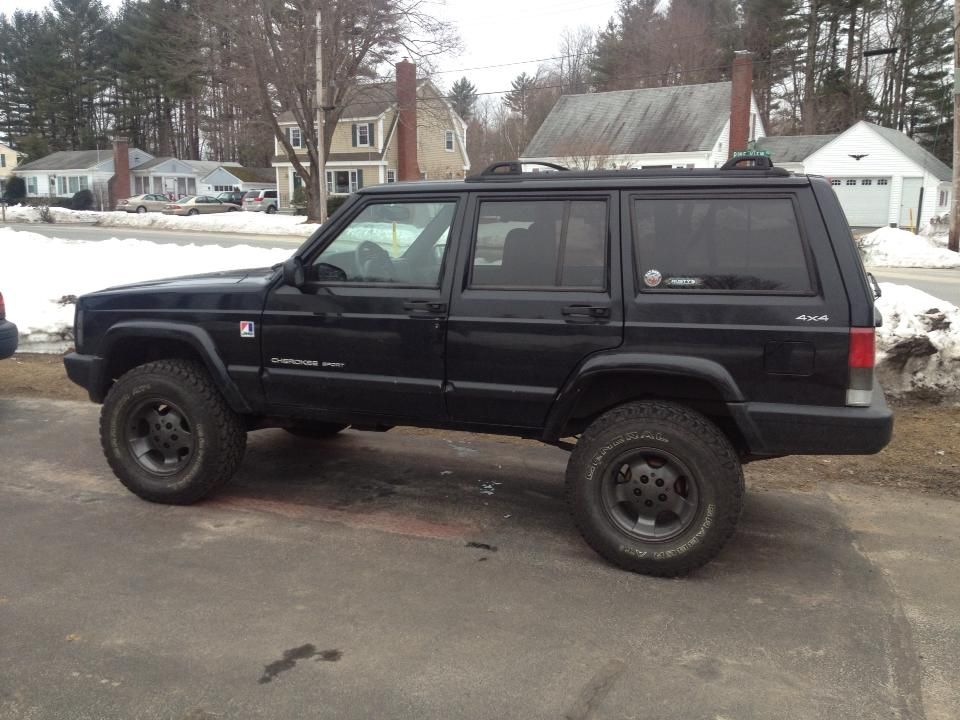

Thanks, me too! Here's how it sits now:
Lift your jeep up on jack stands
2 5/8 bolts and a pipe wrench adjust the drag link sleeve till your wheel is centered.
Profit.
