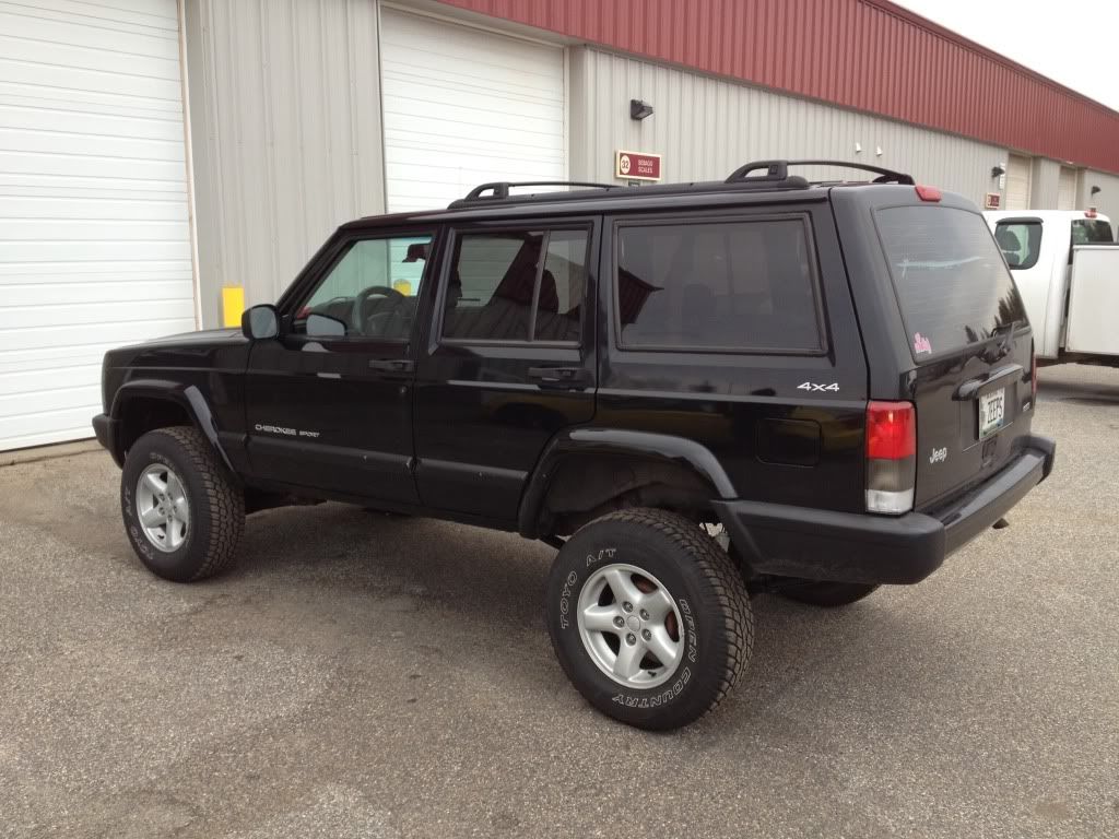

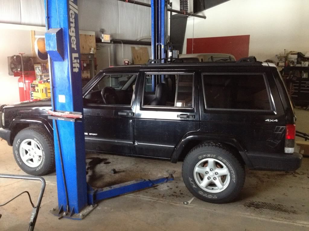

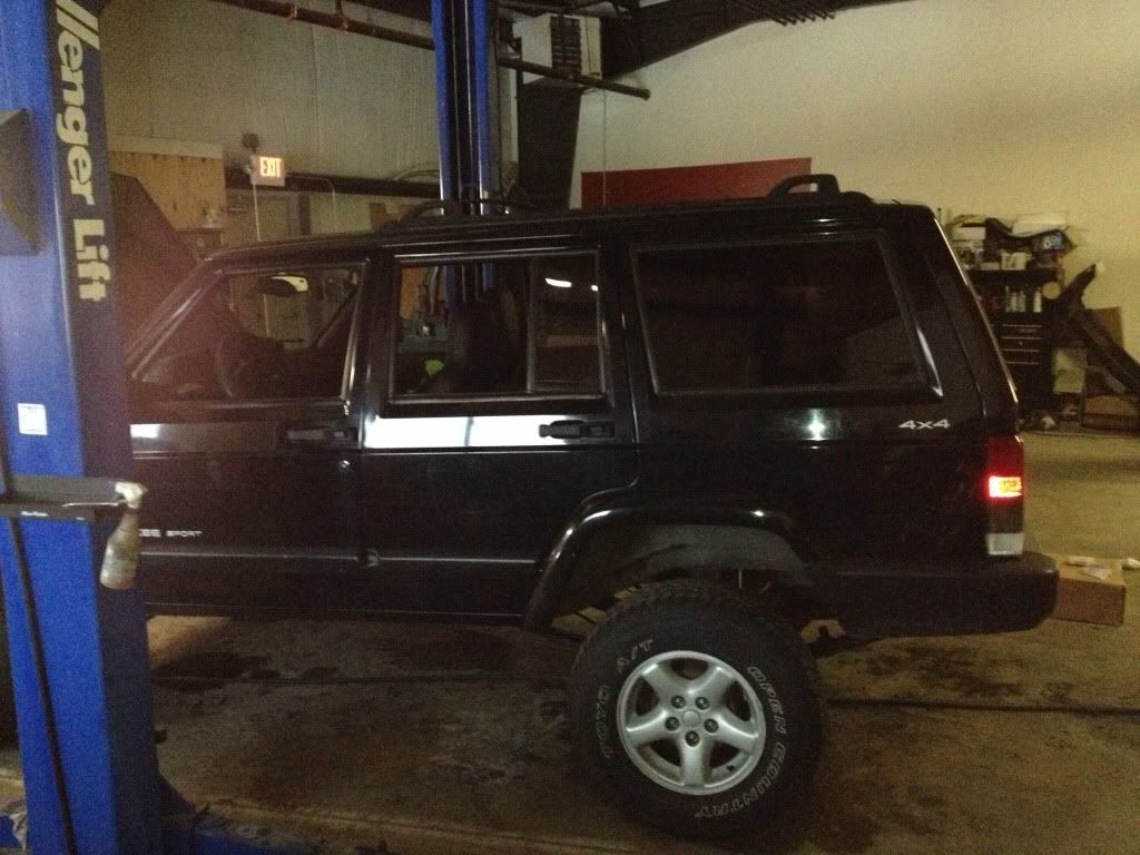

Got to the shop today to put in the lift. What a ***** that was to do!
Considering this Jeep is 99.9% rust free, I was hoping it would be easier.
The top shock mount bolts in the rear were all broken and someone tried to fix them, the left rear lower shock mount stud was/is stripped. We had to cut the front mount of the left rear spring apart to get the damn sleeve out. The front springs were a BASTARD to get in. It's all together though.

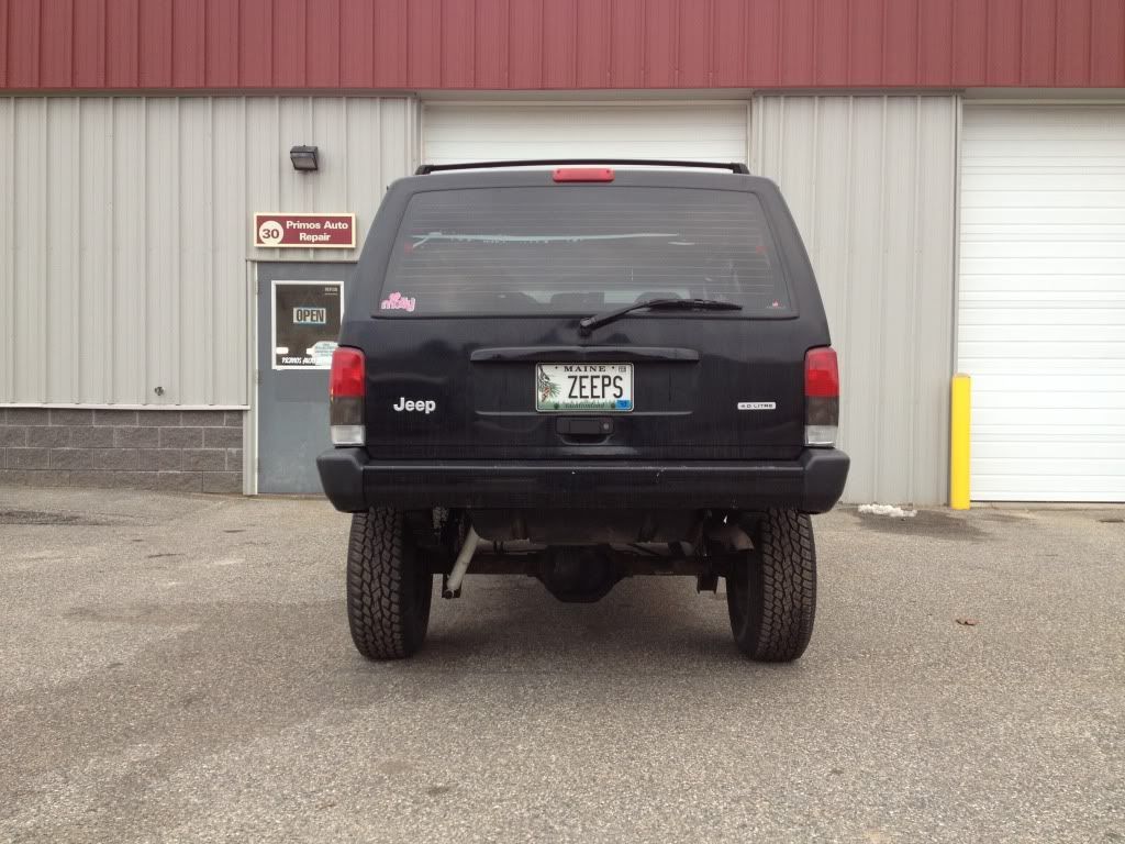

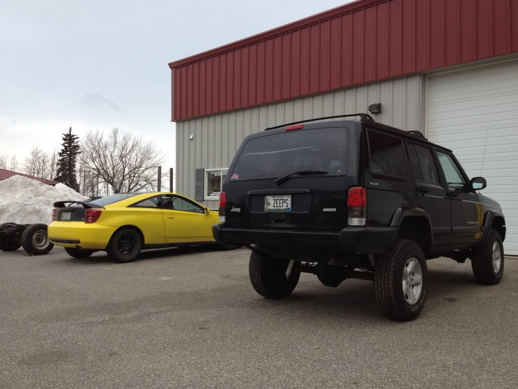

Start of the day, I measured from the floor to the middle of the fender flares. front was 31 inches and rear was 30.5 inches. End of the day, front was at 34 inches, rear was at 36.5 inches. SIX INCH GAIN in the rear?! Did I get the wrong leaf packs? I know it will settle some, but even with the 1" transfer case drop, there are driveline vibrations from 0 to about 35mph, but I haven't gone over 50mph yet. Something doesn't seem right...
Before:
After:
Does that look right? Ideas on how much it will settle?

Maybe they sent the wrong leafs? Look for a part number and check it out. Jeep looks good tho. I love black cars
April 2014 & 2015 COTM
MOBBiN is offline
post #11 of 46 Old 02-21-2013, 04:19 PM
Motorcharge
Posts: 13,733
God damn, definitely the wrong leaves haha.
I wouldn't even bother sending them back. Keep and buy the right ones. You can save some money later if you go bigger or sell them for more than the ones you need cost.

A quick email to Rusty's confirmed that they sent the correct ones. During the installation process, I was stupid and tightened the rear leaf points while in the air, and forgot to crack them loose and settle the suspension down and tighten them. I did that today and it brought the back down a bit, and will settle 1.5 to 2" over the next week. I am going to put new U-Joints in the rear driveshaft on Wednesday for good measure.

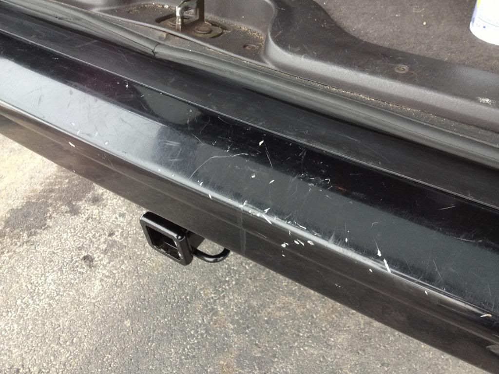

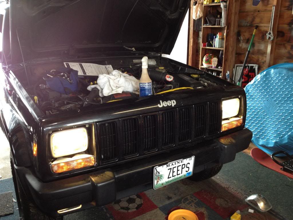

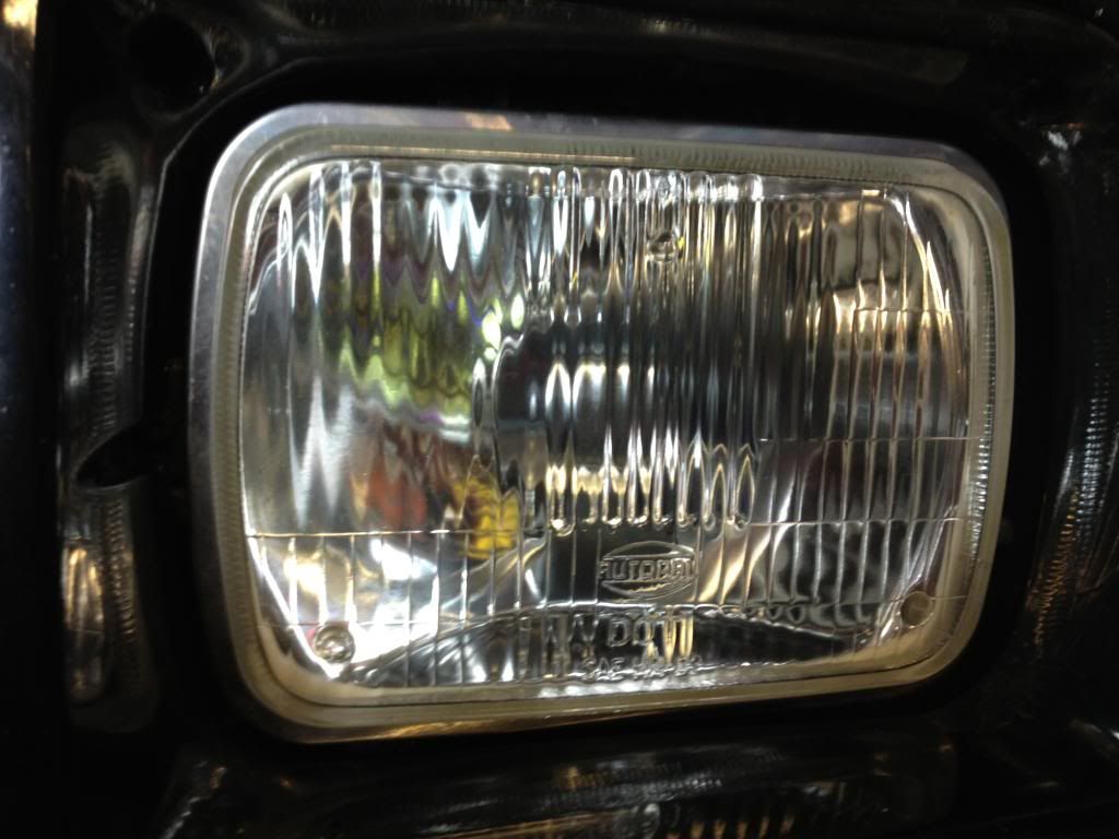

The temp was higher than freezing today so I got busy installing the Putco Harness and AutoPal lights, with Hella Yellowstar bulbs. Took about an hour, not very hard to do. The difference in light output is astonishing. I should have done this a year ago!
Also bought a 2" receiver for the trailer hitch, and realized I didn't like the way the back bumper looked so I Plasti-Dipped it.
Before:
After:
