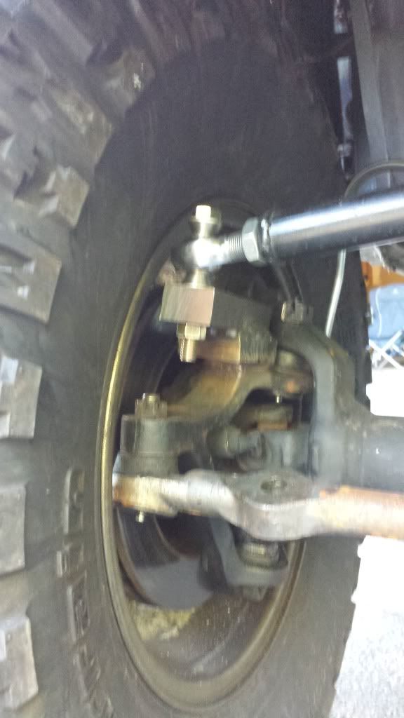

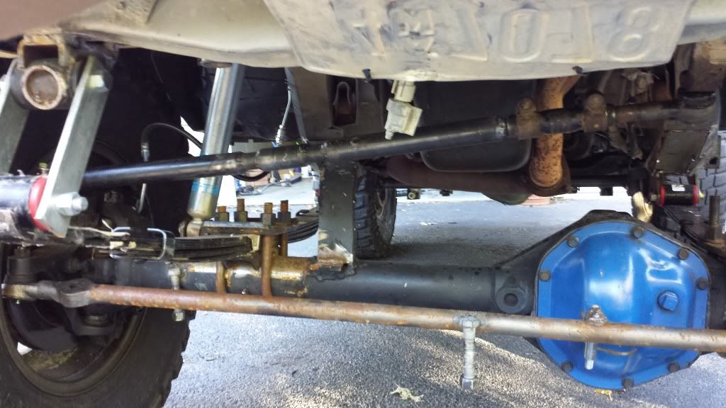

What's the toe set at? That can cause wandering. And take more pictures
i just had the toe aligned. if i can find the papers ill tell you exactly. but its not a toe in kind of wander. that would be like a darty feel. its like bumpsteer where the wheel turns itself. i dont think its actually bumpsteer though because it does it even on smooth roads not just on bumps. and only when i get to around 45 mph and higher. at slower speeds it handles like a dream. and i blasted through my yard a couple times over some bumps and for the most part the steering wheel stayed straight. im just confused on what could be the cause. i took some pics that im about to upload to photobucket then ill post them. the only other thing i can think of is the whole axle moving left to right but thats not common with leaf springs. unless theres a force pushing the axle. like turning when your tire is up against a rock or something.

Draglink is temporary until I can get some 11/4 .25 wall dom.

No offense but your front end terrifies me.
Lol none taken. It is scary right now. I need to cut the 3rd link mount off. Make a proper draglink. Paint it. And I knew the hi steer wad going to scare alot of people.
Oh and the 2 bolts for a stabalizer mount was also temporary. Just to see if a stabalizer helped at all.
Steering links could be bigger but I don't see what's scary...
I think shi tty would be the correct word. Lol I rigged everything up to get it working properly then im gonna make a bigger better draglink and paint everything to look nice
