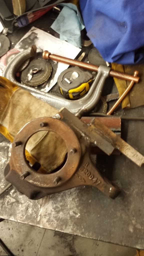

shortly after that pic i trimmed the rest of the autozone shackles off in the front. i used the first hole which was 5" from hole to hole. rides soft and well. im very happy with the front leaves. im taking my steering knuckle to school tomorrow so i can weld on a high steer arm in welding. i may use 3/4" inch instead of 1". i think our plasma cutter can cut 3/4" but not 1". hopefully my teacher will cut me out an arm cuz i dont know how to use that ****. lol i thought it was cast steel but it may be cast iron so ill just tack the arm on, heat em up good and use a nickel rod. maybe even just mig it. ill see what my teacher thinks. or do any of you have any advice? dont say dont weld it because im going to.

Homemade highsteer. Looks pretty redneck but I dont care. I think it will hold though. Pre heated and welded the first piece to the cast with 7018 then the arm that comes out I welded with a mig. Im gonna drill the hole today and hopefully put it all back together tomorrow. Anybody know what size reamer I need for a 79 f150 drag link tre?
