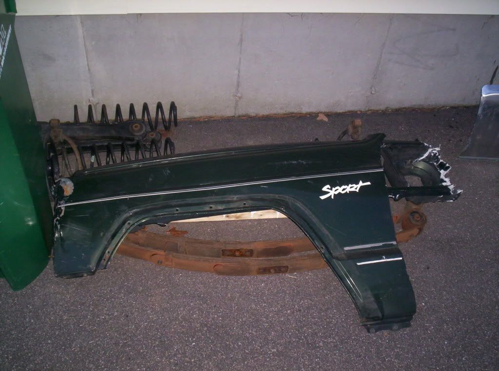

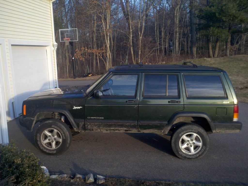

Well, I found my old digital camera and snapped a few pics for you guys
Old Parts
To do list:
-Transfercase Drop
-Steering Stabilizer
-Mount Tires
-Alignment
Hopefully I can accomplish all this by the end of this weekend
Also, my friend that rolled his first cherokee got a new one a couple weeks ago, and yes, he does have a parking violation in this picture

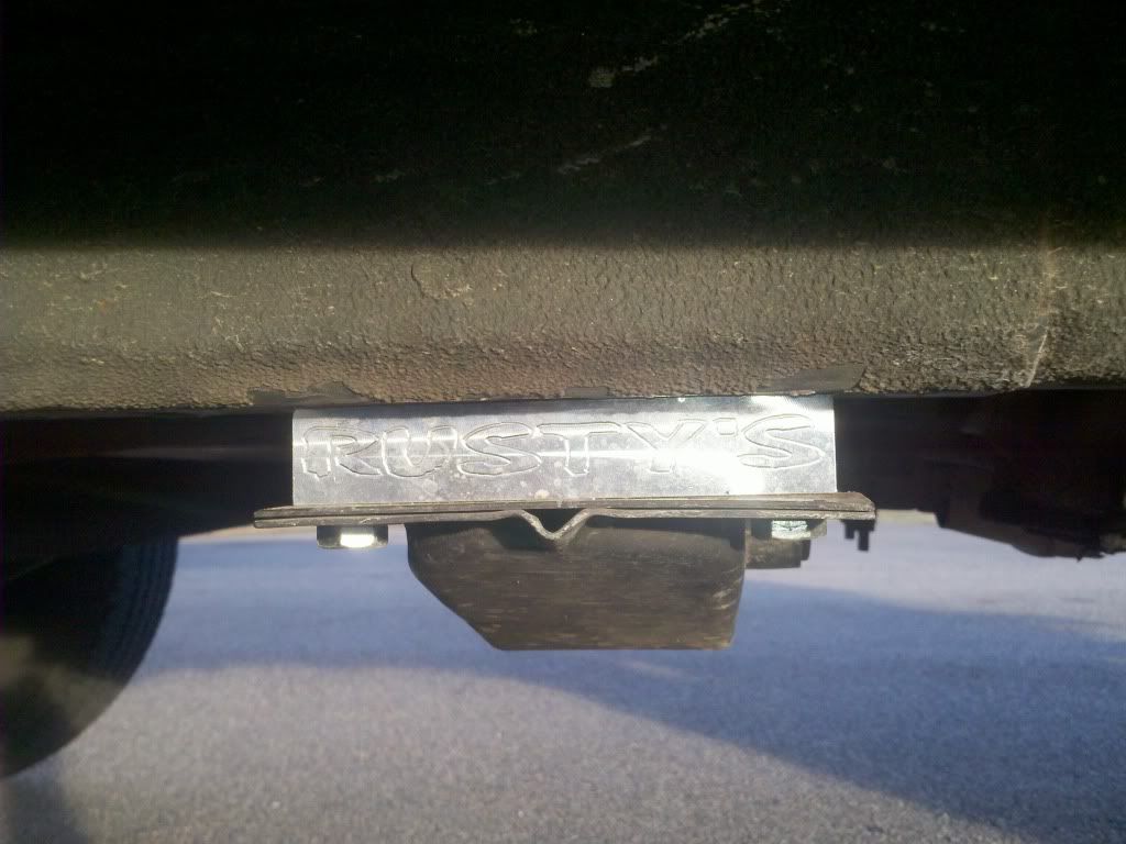

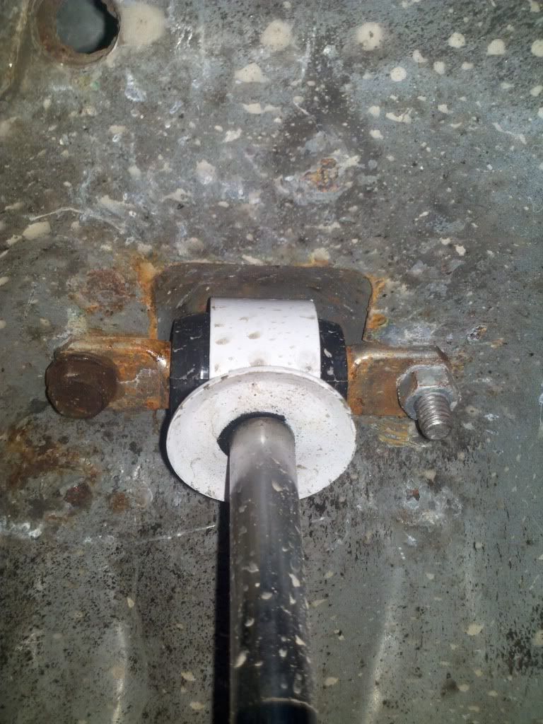

The rear shock bolts were brutal, I broke the forward-most bolt on each side, heres what i ended up with:
Transfer-case drop

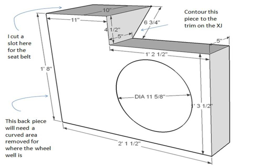

Heres another pic of the box
Some dimensions + info

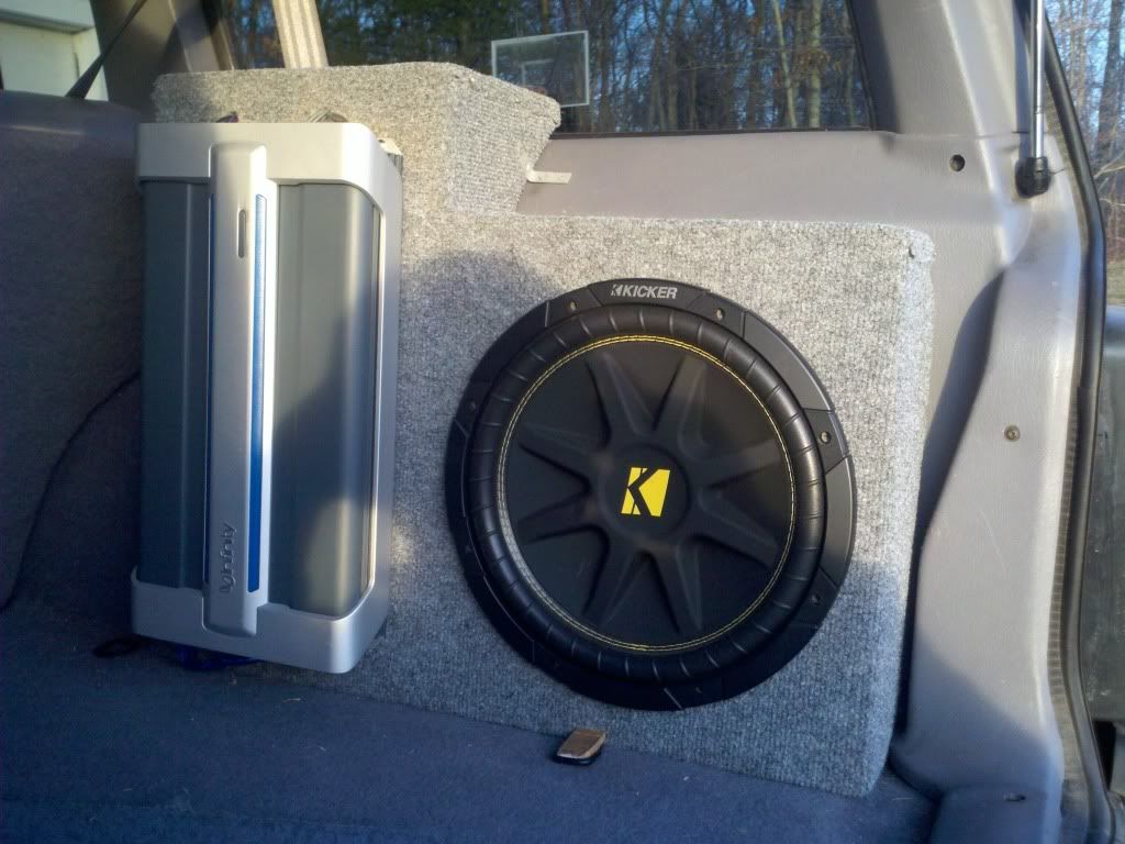

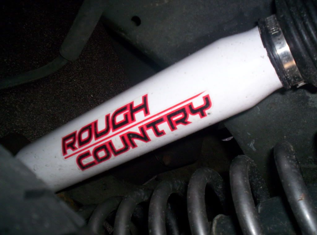

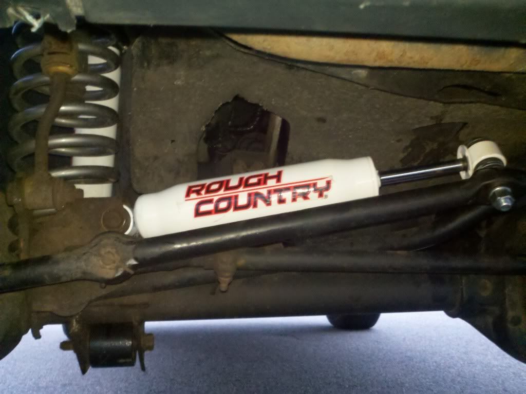

KM2s!!!!!!!!!!!
Steering Stabilizer
http://www.jeepforum.com/forum/f177/nmiller015-build-thread-1170102/
nmiller015 is offline

Broke them in

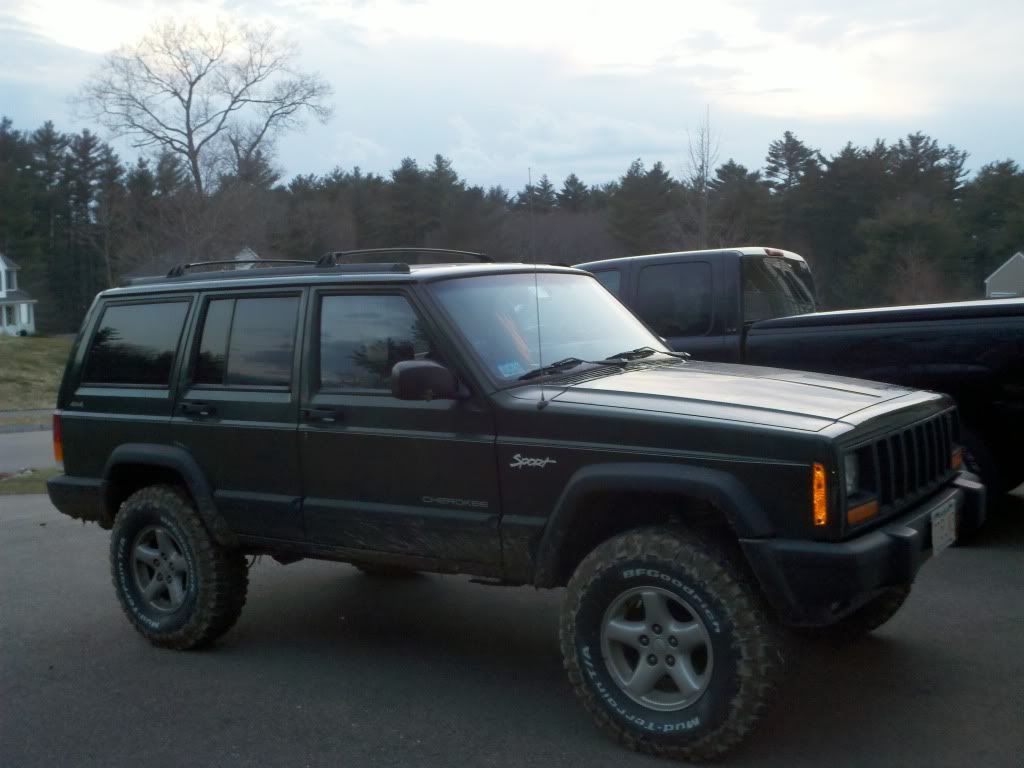

Wow looks good not usually a fan of green but yours looks great with the tires and wheels.
