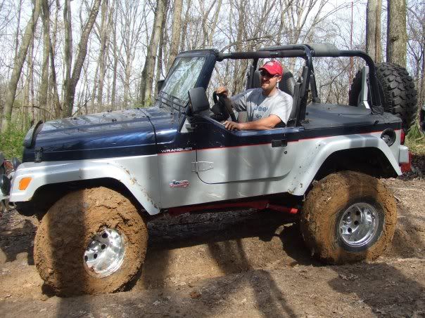

How do you figure an XJ 44 would be an easier swap than an 8.8? Or are you referring to a TJ 44? If it's a TJ 44 then yes, easiest and a lot of support for it. 8.8's are great candidates too.
(EDIT) - I was only looking at your picture and saw a TJ and was very confused. Then I remembered what forum I was in. I say try to find an XJ44 if you can. If not, then the 8.8.

BTW..... I know that TJ in your avatar, you didn't happen to buy that off of a guy on here by the name of red_smoke did you?
He liked the look of that jeep so much, he kind of copied it on his new rig
"cept this one has a diesel swap

Yes sir! It was red_smoke's TJ. My dad bought it from him. I have a xj and he has the TJ. His new rig is looking pretty awesome. I really envy the diesel swap.
We've done some work to that TJ. Started with the interior though because everything else was pretty stout. Herculined the floors, painted the dash, quadratec floormats, and nice Iggee (sp?) seat covers. Its looking real nice. still have yet to put it through some real tests but I feel that will be soon. I love spring.
It's still in loving hands and part of the Jeep forum community.
