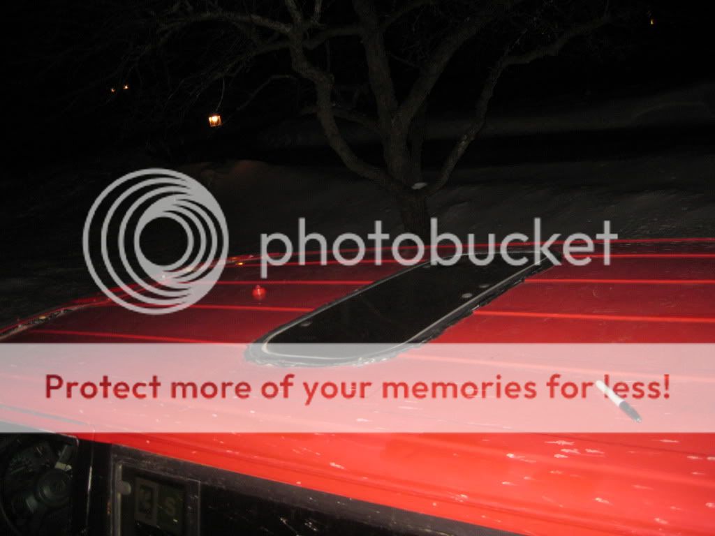

Heres a pic to show about how big it will be. That sharpie line in the bottom right corner is about where it will end.
