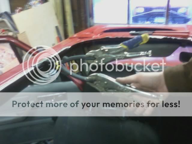

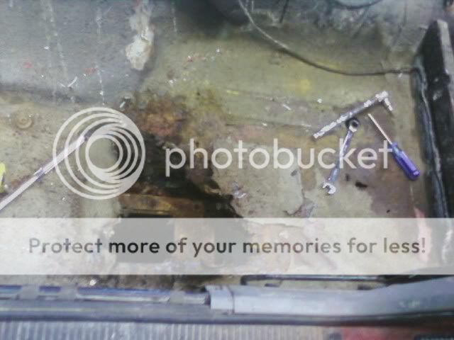

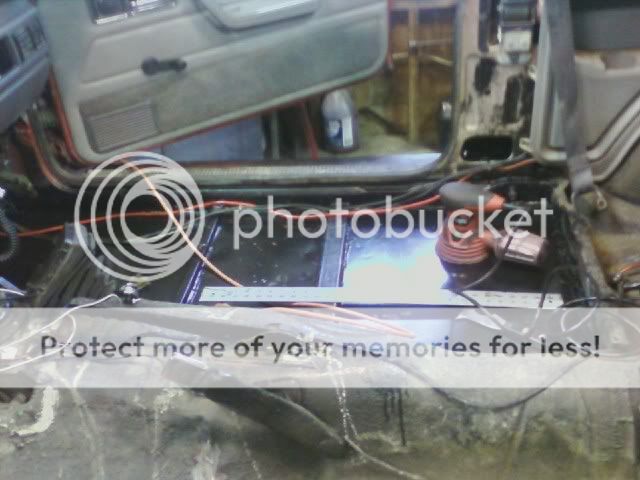

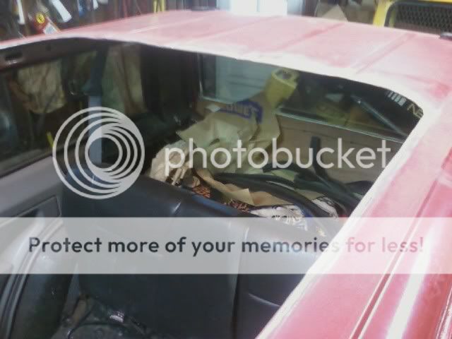

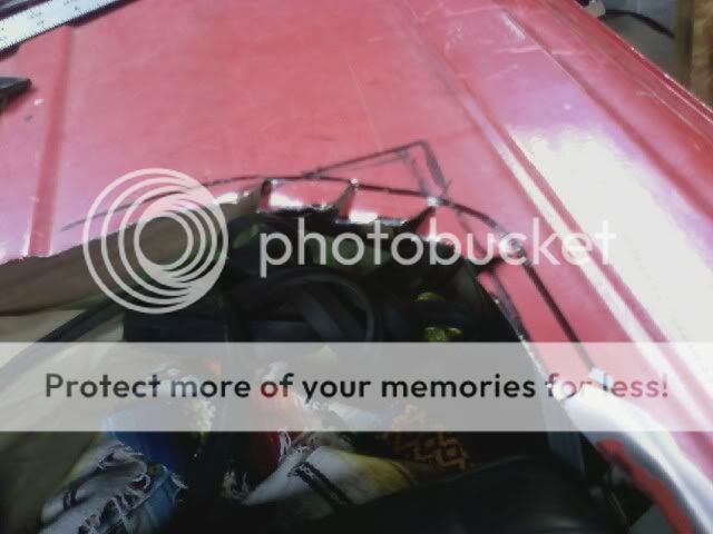

Havent got much done in the last two days, folded the sheetmetal around the opening and prepped it for paint. Finished the passanger side floors but I need to give the drivers side some attention as well .
floors done
Rot on drivers side
Sniped
Bending it over (like my improve?, worked VERY well)
Finished edge
Test fit

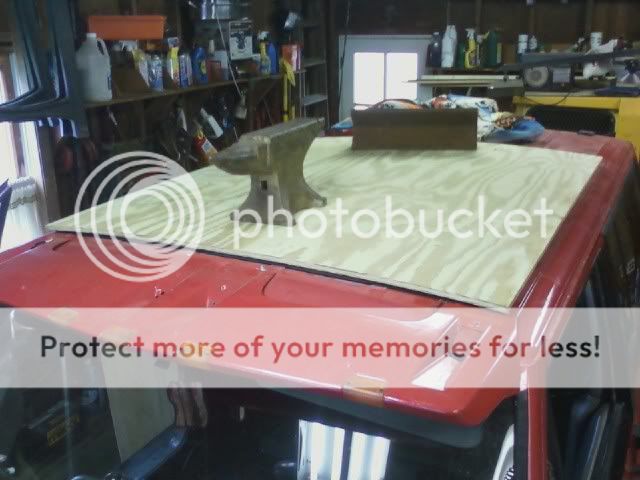

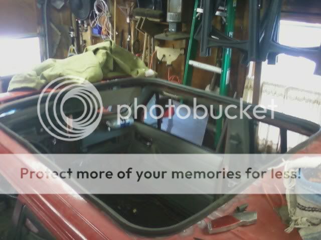

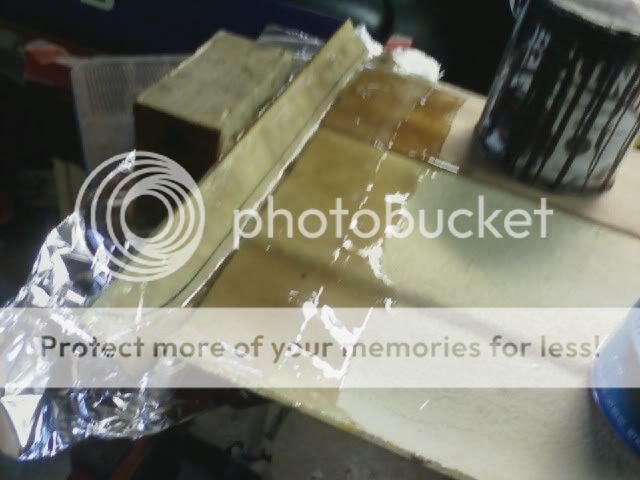

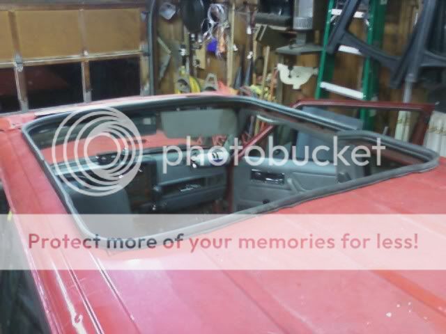

Got my floors finished, started working on the top a little, wanted to test for strength, didnt even budge!
Final seal fit.
Testing seal compression
Started fiber-glassing the top
