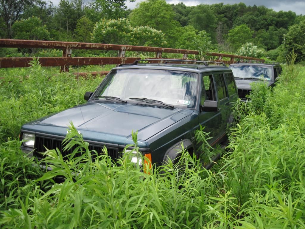

Here is a photo recap of the jeep-related parts of a long weekend spent exploring a friend's private property in lower NY state.
Day 1: Cut access through brush and small trees to jeep camp in the old access road.
Day 2: Bushwhacking a jeep trail through the brush, a recently dry creek bed, and a large overgrown field.
And the 1996 with saggy springs got stuck... dug out with a shovel and pick axe. The 2000 got through no problem!
After crossing the creek bed we hopped up onto a flat and started navigating through a large field.
It felt like a scene from Jurrasic Park...
From there we carefully jeep-plowed a figure eight loop through the field and packed it down well.
That night we left the jeeps and backpacked across a river to camp on the nearby mountain.
We hope to venture across the shallow river in the future when we have at least one winch among the group.
