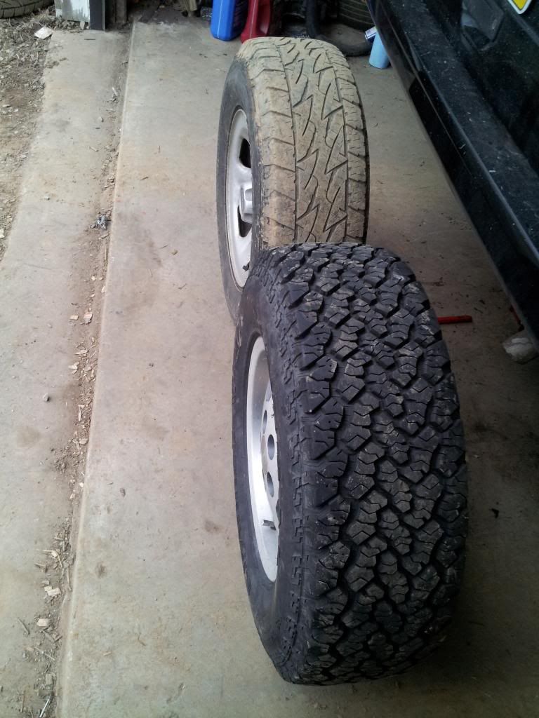

Picked up some gently used 235/75/15 General Grabbers and took a run through a mud pit. Excellent.

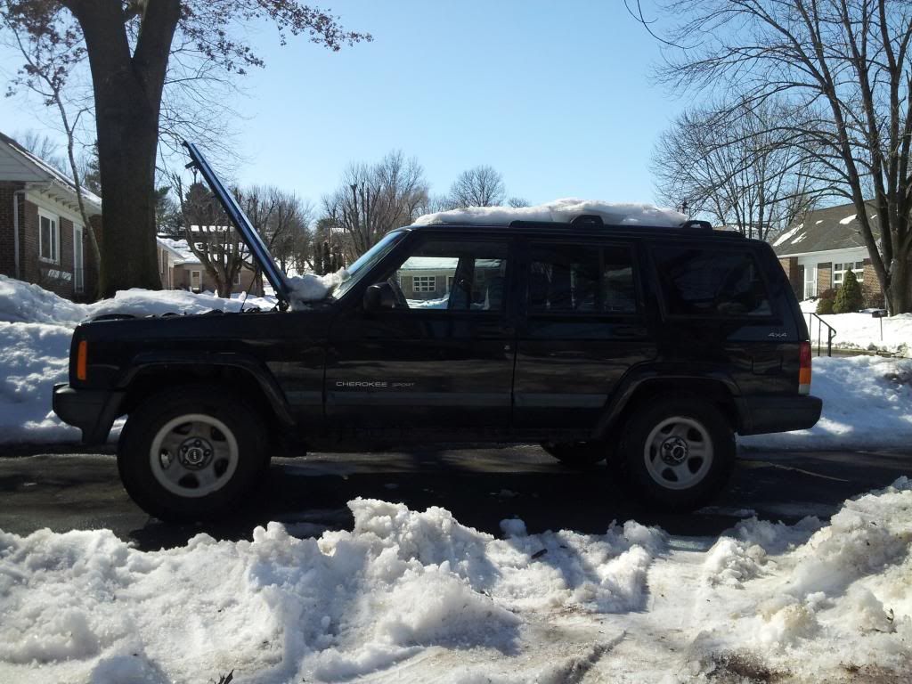

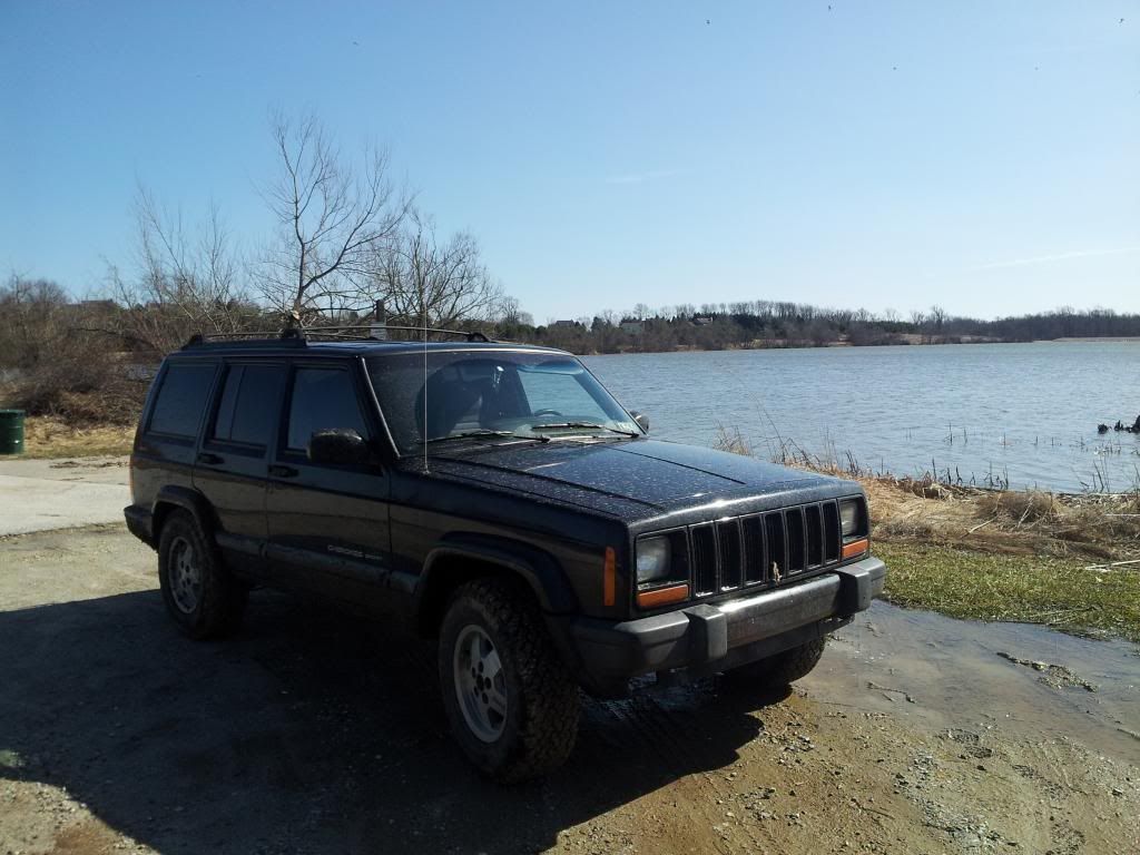

OK, let's try and throw up some pics...
As I got it:

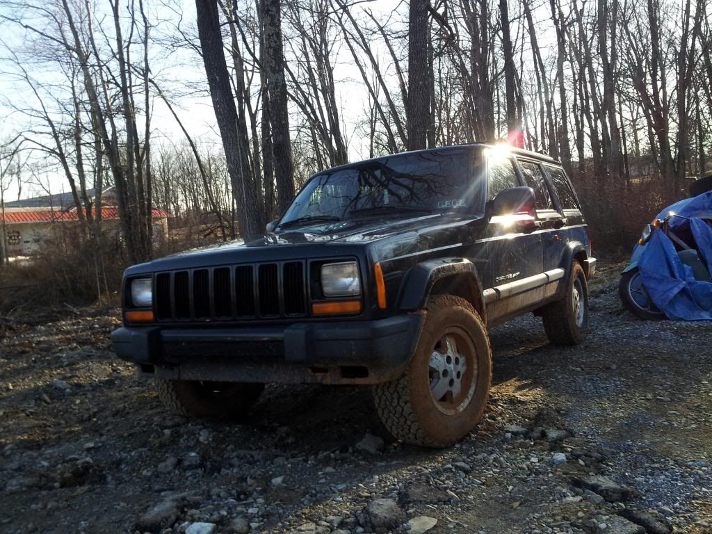

Old & new tires/rims:
Standing on new shoes:

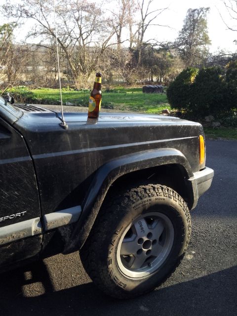

Oh, and no chances to wheel yet, but a few good puddles.
The jeep is good at holding my beer as I work on a neglected car.

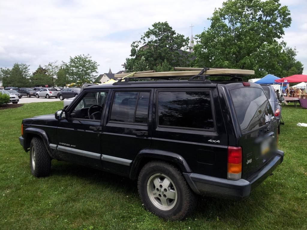

I can't sleep, so may as well upload some jeep photos.
High Knob Vista
Sharp's Point Vista
Loaded with event stuff... There was a 10' pop-up tent next to my face while driving. This is what you get when 2 other SUVS drop off things, and 1 picks them up. If only I had more ratchet straps!
Taking a two-cherokee caravan to explore in NY for the holiday. The plan is to find a camping area the first night, then work on clearing a jeep trail across a field, creek, and maybe uphill. Lots of hand tools, a chainsaw and 3 spares between us.
