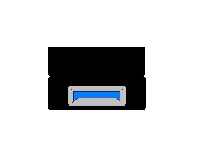

Thanks! The visors were actually pretty easy. Without retyping everything here, look back earlier in the thread and you'll see how I took them apart. Under the fabric, you will find that the visor is a black plastic "clamshell" type of contraption that is hinged at the top where it pivots. After getting it apart, I simply unfolded it, removed all hardware (like mirrors, pivots, etc.) layed it out flat, and cut a piece of fabric that was a couple inches larger on all sides than the visor. Next, I arranged the fabric and visor base on my prep table, with the surface to be glued facing up. You will notice that there is that little flexible flappy-thing on the end of the visor - I didn't think it would work well if I glued the crap out of something that is supposed to flex, so I ran a strip of masking tape over that fold line on the visor. Next, I sprayed a coat of adhesive on the visor, a coat on the fabric, and another coat on the visor and then walked away for about 5 minutes to let the glue tack up. Then, working the long edge of the visor opposite the mirror cutout, I grasped the corners of the fabric closest to the visor and began to roll it over (don't forget to leave that couple inches of overhang!) and then slowly and gently rolled it onto the visor, smoothing it out as I went. Smooth it all out and press it down with even pressure all around.
Next step was to trim the fabric. I placed it on a large plastic cutting board and, using a fresh utility knife blade, I trimmed the excess fabric all around, leaving about 3/4" of overhang. After this is trimmed, I went back to my prep table and sprayed a thin and narrow bead of adhesive on this exposed overhanging fabric and the inside of the visor where that piece of fabric will fold in. Let that sit for a few moments to tack-up. Now, simply roll and press that fabric over all the way around. You will have to probably do some creative 'trial and error' trimming, cutting and folding where the pivot rod inserts and also where the little stub on the opposite side inserts. Shouldn't be too tough to see how it will need to be trimmed and rolled as soon as you see it laid out in front of you.
You have probably noticed that your mirror opening is covered with fabric...here we go! Back to the cutting board with it. With the visor up and fabric down on the cutting board, the long edge of the visor facing you (the half with the mirror opening!), take up your sharp utility blade. Beginning in the lower left corner, approx 1/4" from the corner, make a cut at a 45 degree angle toward the center of the mirror opening. Do the same for the lower right corner. Same thing for the opposite corners. This sketch may help to see what we're shooting for...of course, if you still have the original piece of fabric that came off the visor, you would have a template! Looks something like this:
(In the little sketch, the area in blue will be gone altogether)
Now, go ahead and get the mirror back in place, tucking the little flaps you just cut behind the mirror. Take note of how the original fabric was tucked and you'll see exactly how to do this. The rod/pivot arm simply snaps into place. Now you're ready to fold it back together!
Warning: it is tough to fold! A combination of a tougher fabric and glued surfaces make it not want to yield easily. Rest assured, with some patience and persistence it will fold up nicely and everything will snap closed and it will be beautiful. Last, just push, twist, and slide that little stub in the opposite side of the pivot and then go install it before moving on to the last step...as follows:
