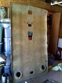

After a few weeks of thinking, "How hard could it be?", I finally got up the nerve to yank the saggy headliner out of my '98 XJ Limited and make it unique. Off we go! First things first, pull it, peel it, take a scrub brush to the deteriorating foam, and then let it take up space in your garage...

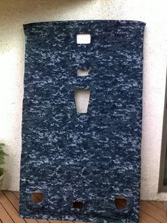

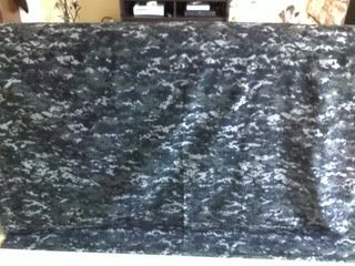

...while waiting on delivery of this! Three yards of the US Navy's blue digital camo:
Didn't know it when I ordered it, but it even has the Navy logo scattered around the pattern:

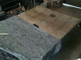

Adhesive applied - Point of no return!
Fours cans of headliner adhesive later...Voila!

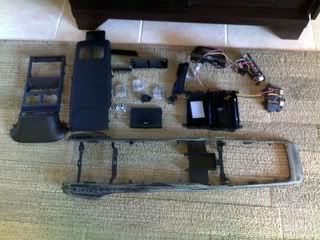

What the heck...let's do the visors, too. Plus, I was able to get the console back together! Here, after install:

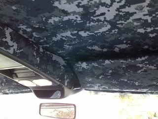

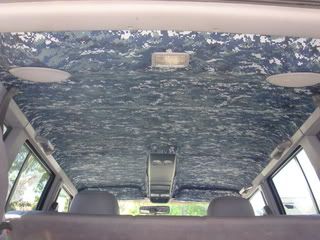

My very first mod, all done flying solo, in its final state:
I love the way the blue, gray and black of the pattern really go with the colors of my XJ. Living in a town with a Naval Air Station in one direction and the Naval Port in the other direction, I see these fine folks in their fatigues all the time and it hit me that the fabric would be perfect as a headliner for the 'N2Fix'. Luckily, I was able to find some in a 60" width, so I didn't have to seam it down the middle. Thanks to the Jeep Forum - wouldn't have been able to do this without it!

Where'd you order that headliner from? I've been looking for digi camo for awhile and can't find anything good.

Looks nice! Just curious, what kind of adhesive did you use?

Thanks again for the compliments! The fabric came from Fashion Fabrics Club and they had a big selection, even other colors of digital camo. It now looks as though the wife's KJ is going to get a headliner facelift...something in pink. Imagine that...I may have created a monster!
The adhesive I used came from Advance Auto Parts. It is the Permatex carpet and headliner adhesive, $11 per can at my store. According to the technical data sheet, it should hold up to the Florida heat - fingers crossed!
Now, let me share some tips for doing the visors: Remove the fabric first! If you just pry and pull to unfold the plastic clamshell base of the visor you will be rewarded with very loud cracks and showered with little broken plastic pieces. Found that out when doing the passenger side. When doing the driver side, I cut and pulled the fabric off first, as best I could, which allowed me to see the places where it clips shut. Then I could get a screwdriver in there to release the clip and it all opens nicely. Also, pull the short plastic stub (opposite side from the point that it attaches to the roof) out of the visor. With a little pulling and twisting, it will slide straight out. If you don't pull it before opening the visor, guess what happens? Yep, more cracking and flying plastic! Looking back, I should have taken more pictures of the visor disassembly and recovering because I'm sure someone would have benefited from them.

As for the amount of glue, my tally came up to nearly 3.5 cans to just do the headliner. I don't think I was stingy with the application of glue! Also, I applied it to both the board and the fabric.
