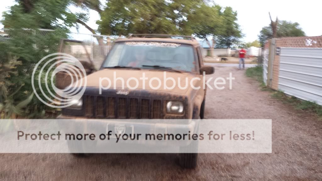

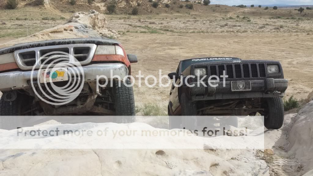

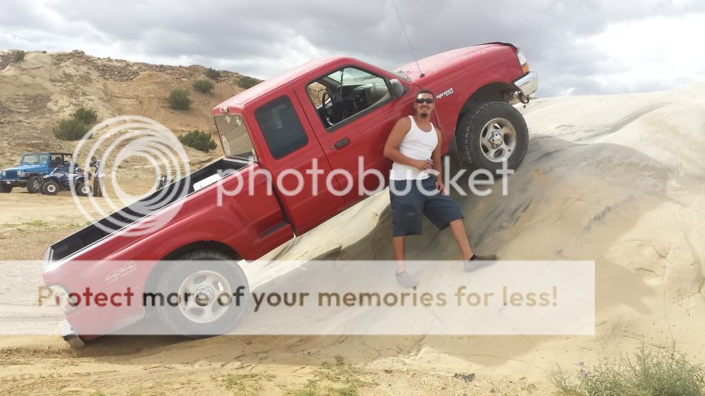

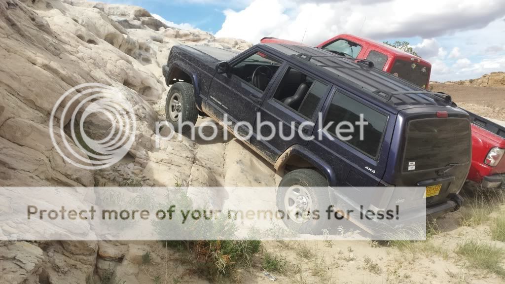

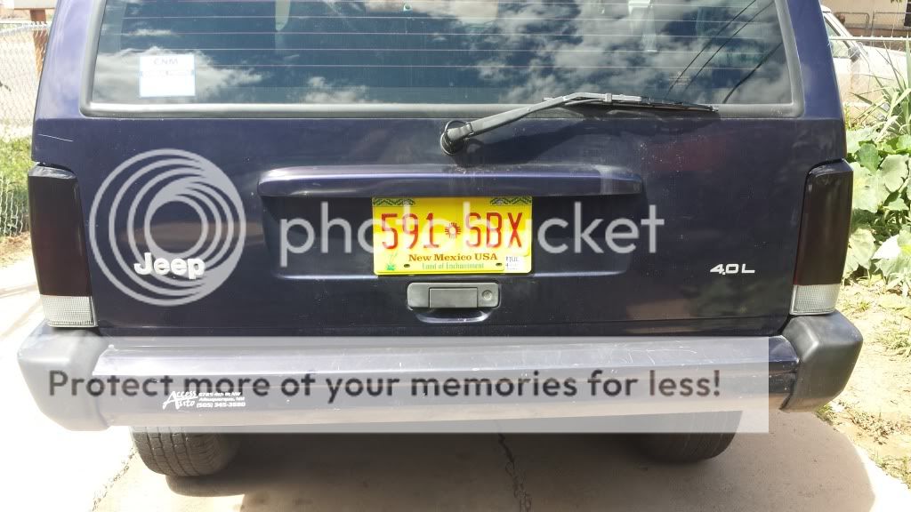

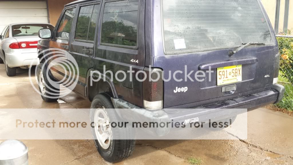

Tinted the tails, side markers and front markers this morning

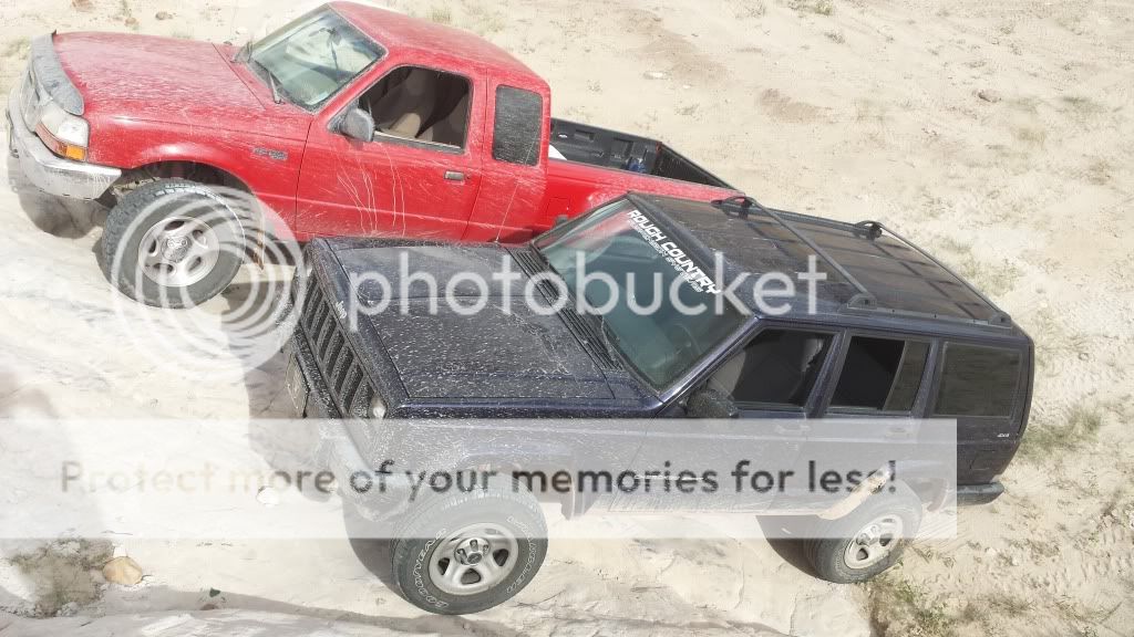

Then me and a buddy headed to puerco and had some fun. Didn't get stuck even on these crappy tires and the only thing that stopped me and my buddy was a steep *** Sand Hill

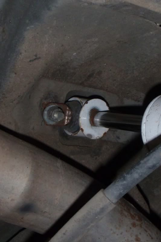

No not yet, I dont know how to get the bolts out, and a mech wants to charge 200 to do it
The nuts are just tack welded in up there. A punch and a 3lb hammer will knock them right out with a few hits. Thats what I did on my last XJ, then used some wire to fish new bolts in from the top and bolt everything back up. Easy as pie.
The upper rear shock mounts
Yes. Buddy of mine cut his floor to get them out before we started doing it the easy way. No need in doing all that. My current XJ is done the same way but bolts are tacked in now, so my upper rear shock mounts are "studs" and I just put the shocks on and secure them with nuts.

When I do it, how do I re attach them
After u knock the old nuts out, there will be just a hole there. Using some wire wrapped around the head of a bolt, u can fish new bolts in from the top. Then u just put the shock on and secure it with a nut. My bolts are welded in but you can get a wrench up there if thats not an option.
Heres a photo of end result.
When I broke both bolts on one side, I did this method and it went so smooth I was hoping the other side would break so I could do it the same way.

Gonna do the bolts this week sometimes, think I can use a butterfly bolt and just push it through? If not how do I feed it through the top, where at?

Got the bolts out and the shocks mounted, feels great to not have to take bumps at 5 lol. Still need to get the death wobbles figured out. Im just clueless with suspension
