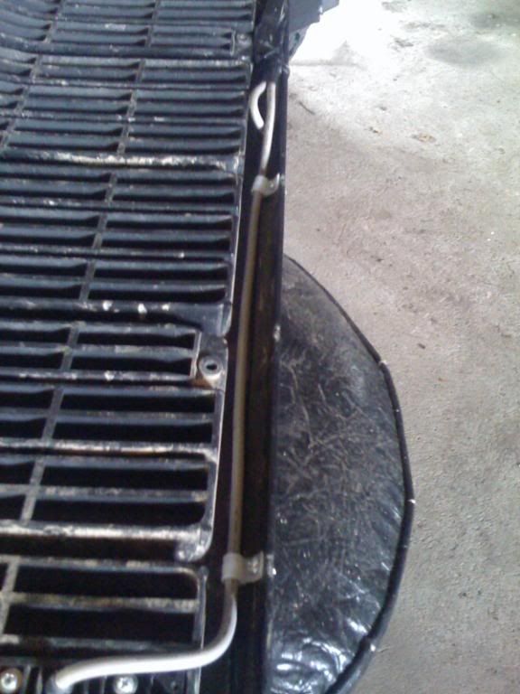

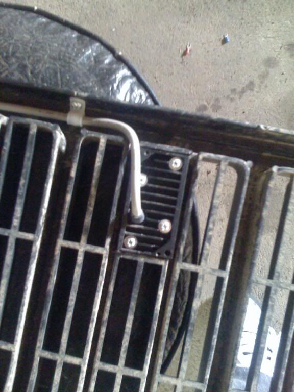

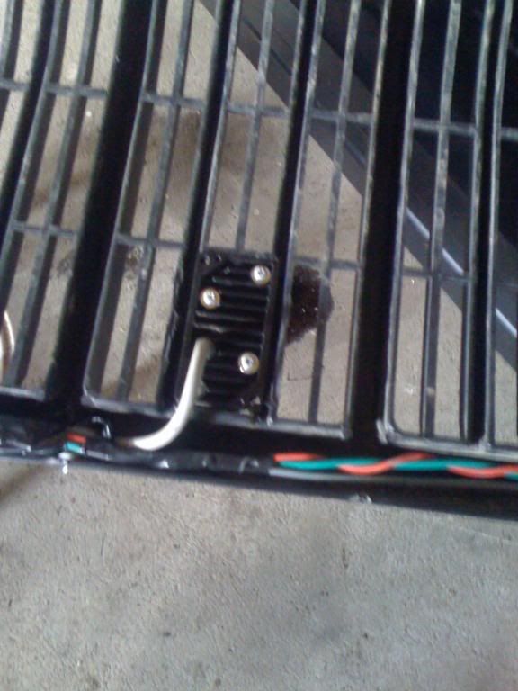

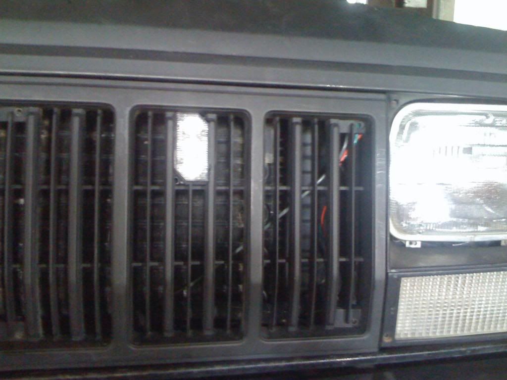

ok so heres my little light write up that pic heave so be prepared.
ok i wish i could have taken a pic of the grill without the lights in, but there in there so well that they arnt coming out. but thats a good thing considering i didnt screw them in or anything. all i did was take a die grinder with a bur tip and cut out the little piece that went where the light is.

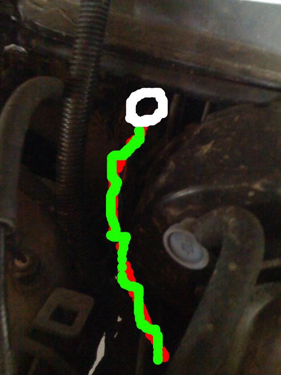

then when both the lights were in i ran the wires on the top part of the grill (very very much room up there)
then i ran the wire around the radiator and connected the gray wire to the frame for ground. then i ran the green and red wires up around the airbox.
then on the firewall there was a conveniently placed hole that i ran the wires through and into the cab.

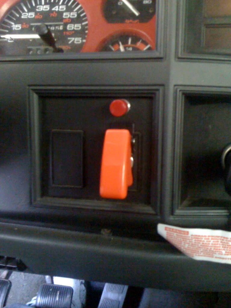

and on the dash i had a switch that i was planning on using for lights (like piaa's or kc's) but instead i wired the grill lights up to it and took some power from the sig lighter. and the little button above the switch is so i can change the pattern that they flash, and all i had to wire that up to was ground so that was easy.
and all together the only wires that you can see is a very little amount behind the right side of the grill.
