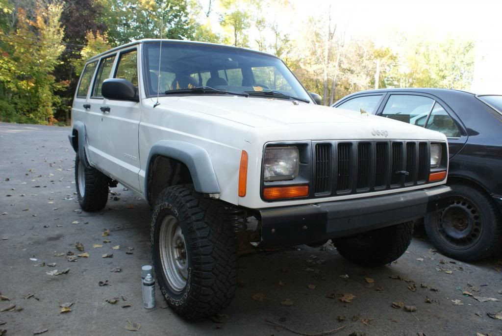

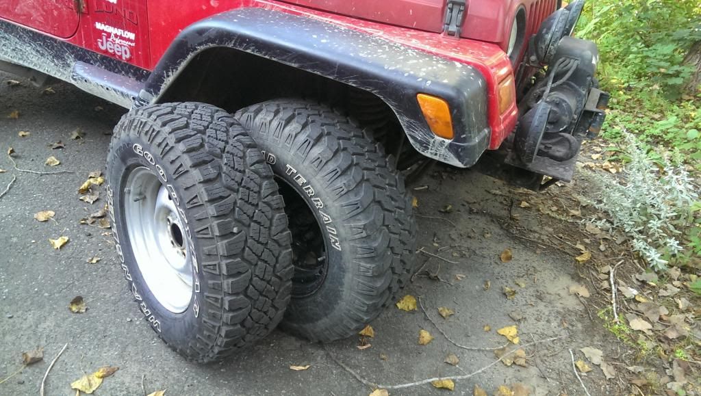

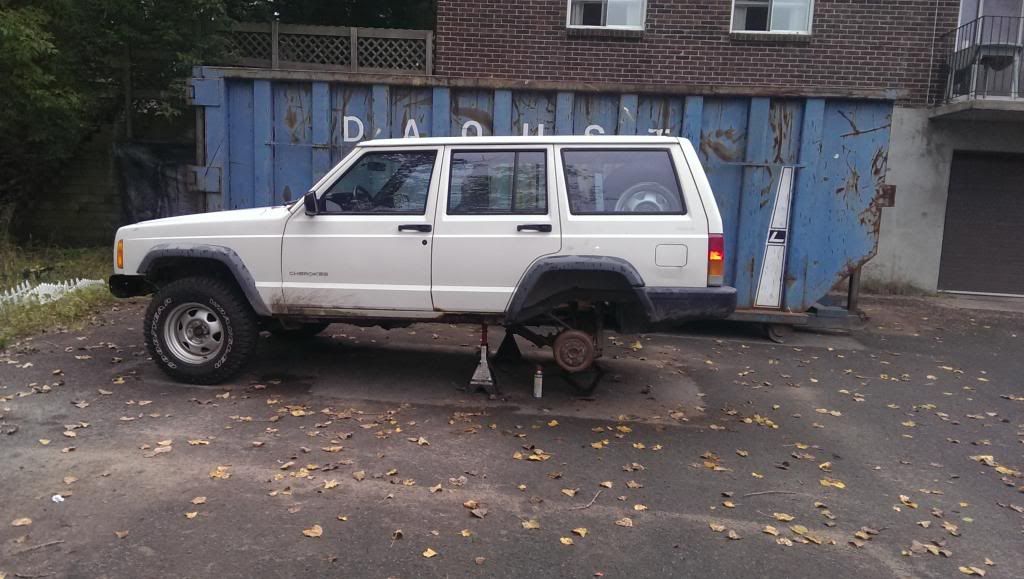

When i got it it had sagging springs in the back, and pretty much the largest tires you could fit on a stock xj
Compared to the 31" tires on my TJ
So I went ahead and ordered a lift kit for it. its a basic rough country 3"

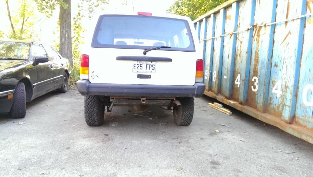

I put that in, but had issues with the rear leaf bolt. It was a real pain. The front lift went fine.

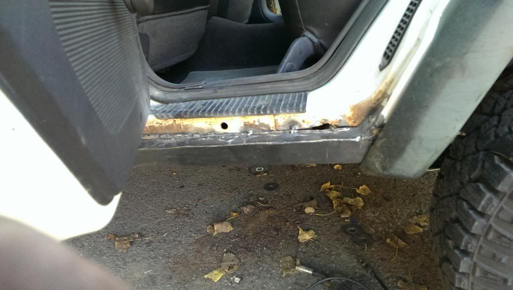

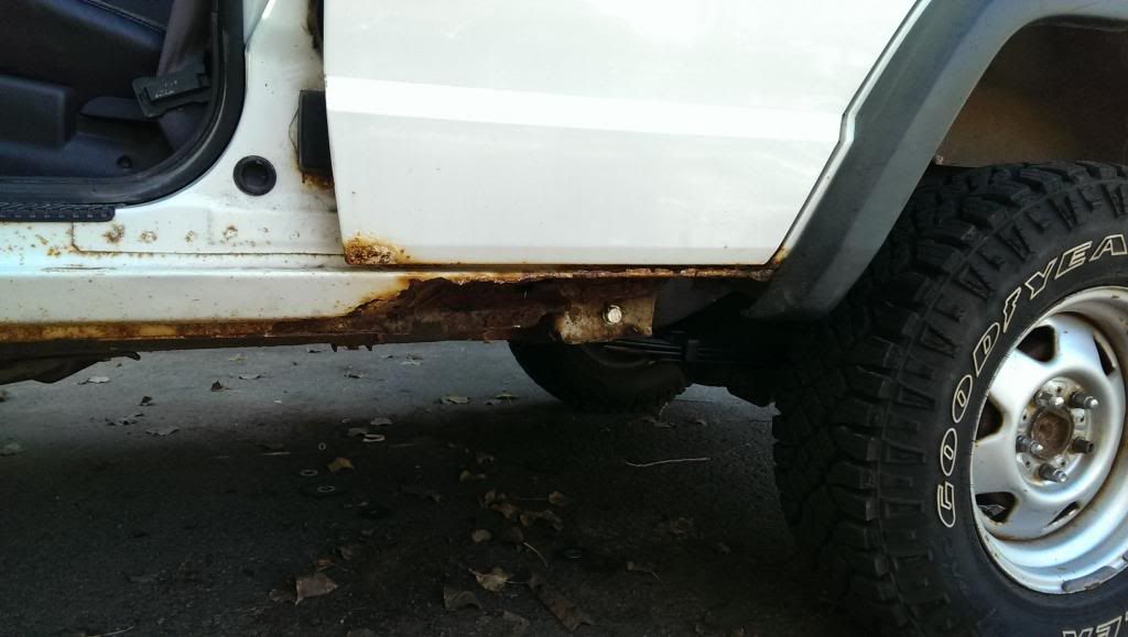

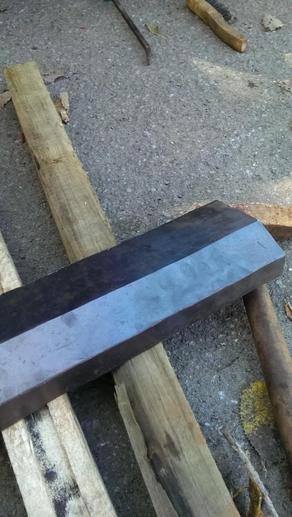

I then started addressing the rocker rust issue, its the only place were the rust is real bad, so out came the welder and grinder.
Fabbed up some replacement rocker segments

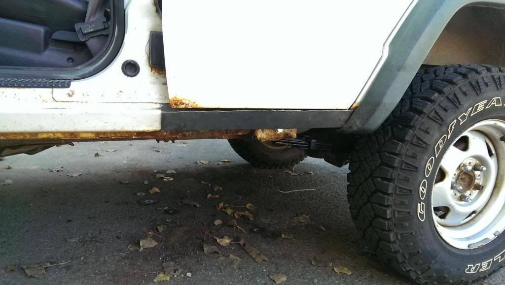

Tacked it in, my welding sucks lol

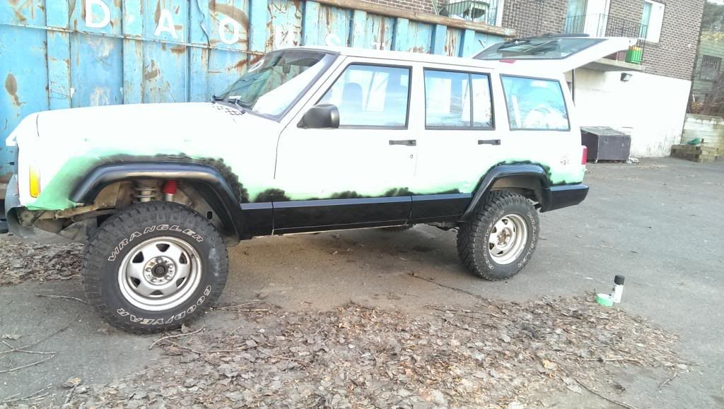

then got it painted, i'll have to grind down the edge more at one point, my metal crafting was not too exact. i eyeballed it. and then i'll bust out the bondo.

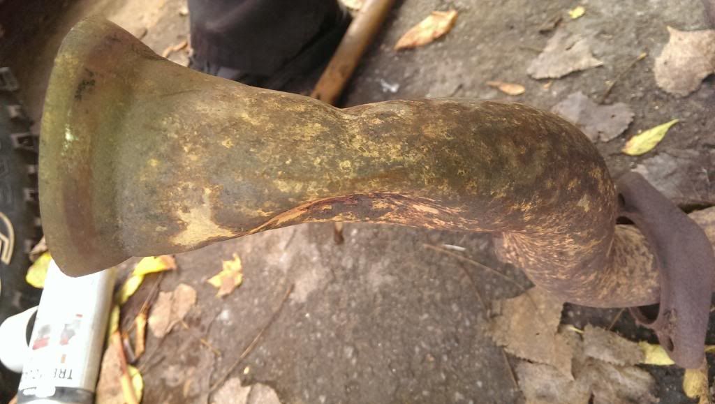

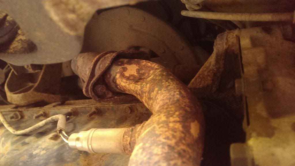

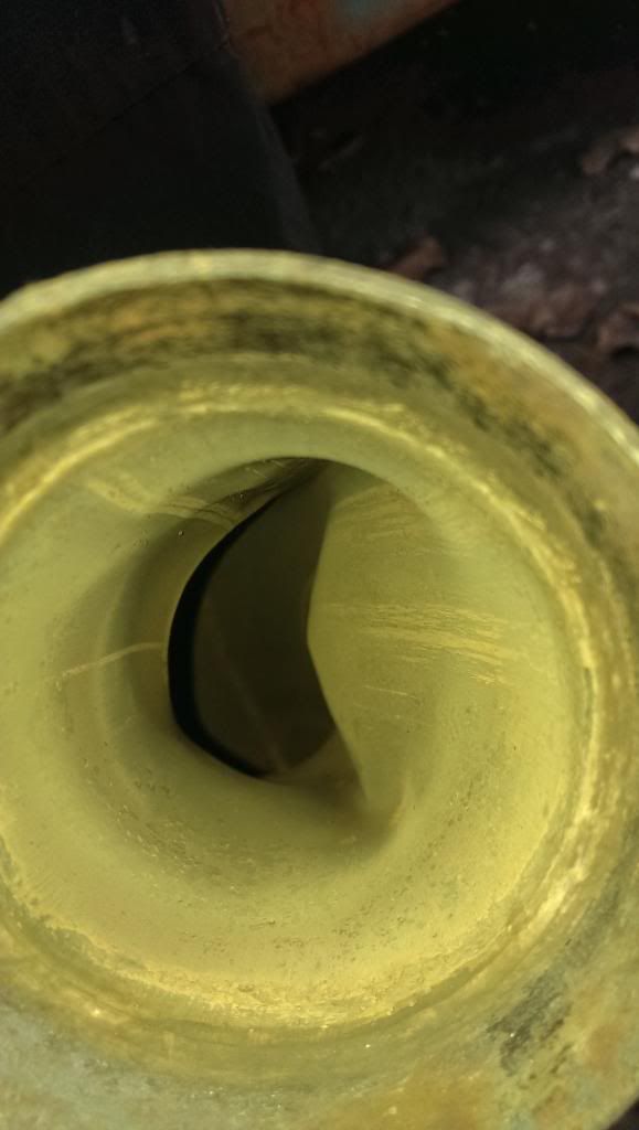

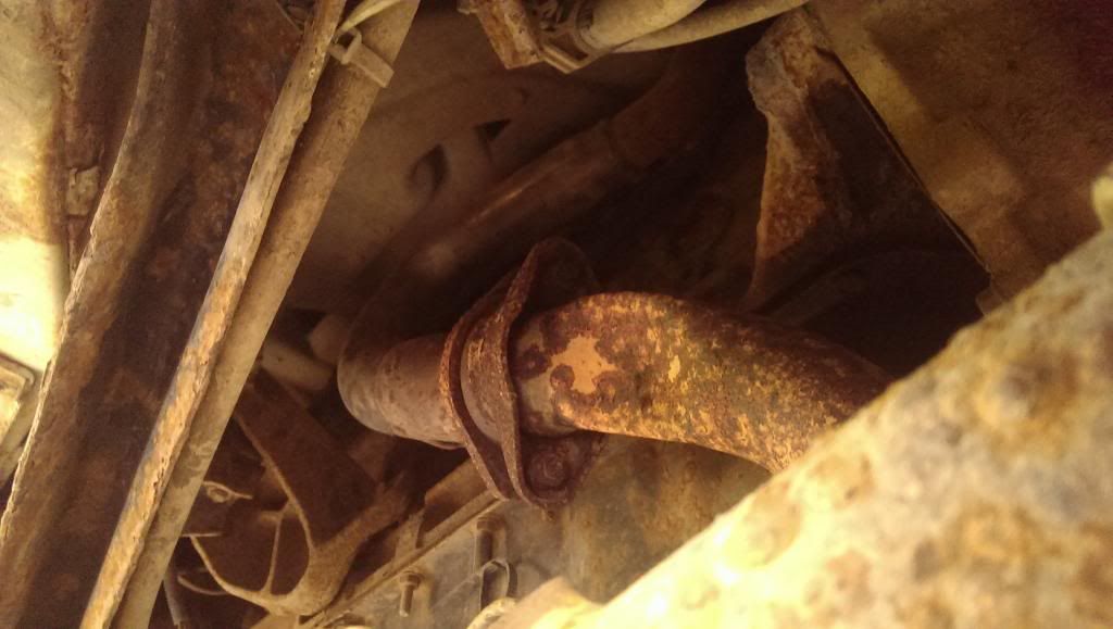

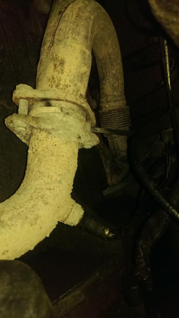

Currently working on the exhaust system, when i got it, the exhaust pipe was ready to fall out of the jeep, the only thing that saved it was the transmission crossmember. So I rewelded the rear exhaust hangers, but i still had a clunking sound when running the motor. It turns out the exhaust pipe was hitting on the transmission mount, that was Odd.
So i examined the pipe and discovered warping where it mates to the exhaust manifold.
Turns out that's why this jeeps getting such bad MPG compared to my Tj.
Versus the pipe on my TJ
Its restricting exhaustflow for the motor, most likely the major contributor for the bad MPG.
A new pipe is ordered

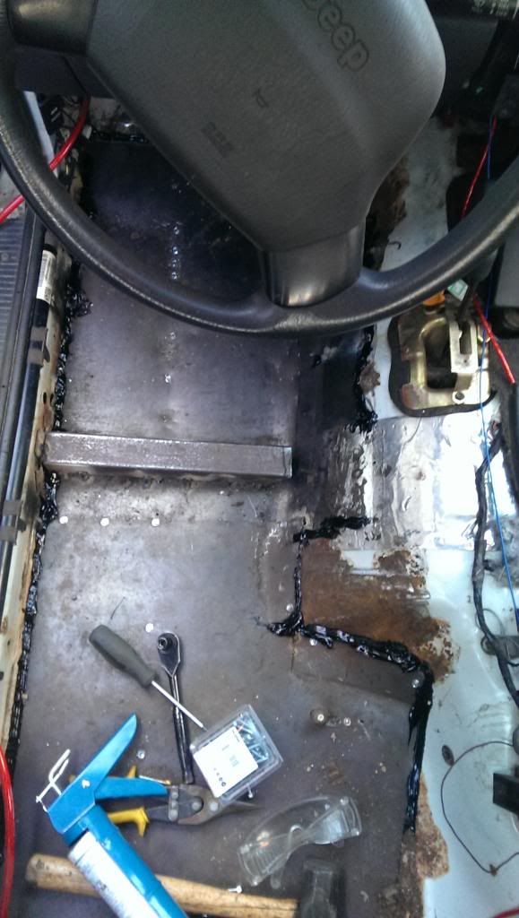

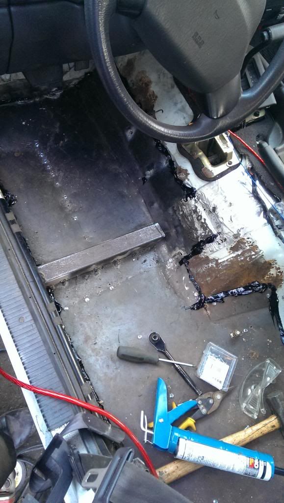

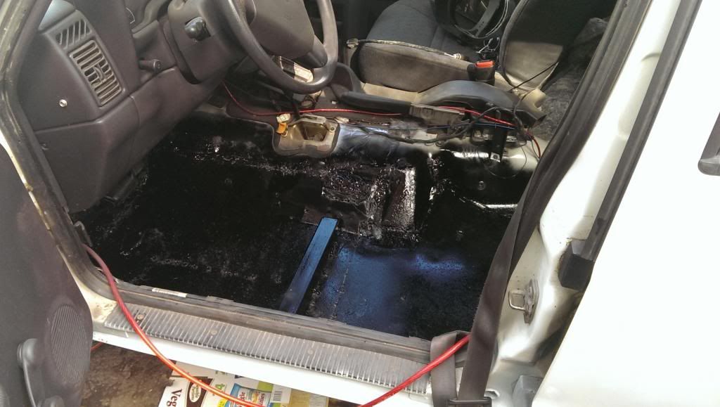

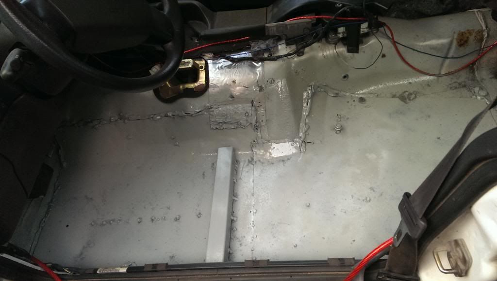

I was poking around on the underside planning the removal of the exhaust pipe when i discoverd my floor was severly rotted, the carpet was hiding it quite well. It was even rust colored lol.
Just to the left of the fuel line, was bare carpeting. It looks like metal.
So work stopped on the muffler and my attention turned towards the floor. I pulled out the seat.
And then i pulled the carpet carefully, i intend to reuse it. This jeep will be used by my dad so i want to keep it as clean as possible... However.
Yikes!
I started pulling and hammering out the rusted sheet steel.
I then used a sawsall to cut out the remaining **** parts.
I used some left over 16ga steel sheet i had from a previous project, started hammering it into shape,
Then i did the back Floor aswell, it was rusting too. Not as bad. but still weak enough my axe could break through it.
So ive got it all mocked up
Just had to buy a grinding wheel to make good contact points for the weld. But its getting late so **** it. i'll do it Tommrow...
I Used a milk crate as a chair. Had to move it out of the garage for the evening.
Tommrows grinding and welding day!

Today's update,
Got it all in sturdy, I realized my welds sucked halfway through. So I used sheet metal screws in unison with my crap welds to make sure everything was secure. Its rock solid, and can survive a 5lbs hammer blows. So the welds ain't gona break. I used a combination of black window sealant and rubber gasket maker to seal the parts of the floor that i was unable to seal with weld. It should be water tight'ish. Im happy with the results.
With primer on its looking fresh!

One of the most difficult parts was aligning the 4wd shift linkage mount, bendign the metal to get it in the right position prooved difficult. It was a good thing i fixed it, it was mounted onto paper thin steel and flexed as i pulled the 4wd shifter. lol.

I did end up painting the top coat black. it looks good.
Also pulled off the damaged exhasut pipe, Look how restrictive it was!
New pipes going in today, just need to pick up two bolts to replace the header studs, one had snapped on removal.

So the pipe was installed successfully.

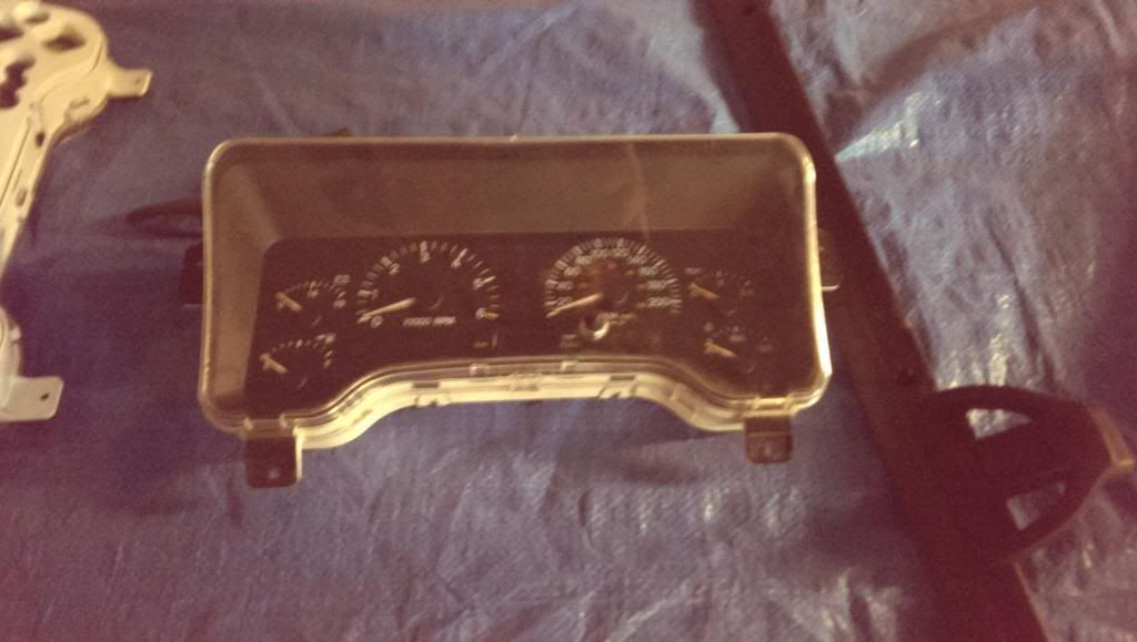

I found out about a local U-pull the Parts place. Turns out they had 5 recent model Cherokee's there. And their prices were more then resonable. I went with a friend and we spent he entire day there just browsing and checking out cars. It was cool. I went for a few small things, and to see if i could score a gauge cluster, mine was the base one with dummy lights. I also needed an oil dipstick tube.
So I found two clusters, and got both of them. There was no way to test them there so I got both of them for 50$. way less then the 100$ I was quoted for just one used one from a scrapyard..lol.

so for 67 $ I got two clusters, an oil dipstick tube, a tshirt and a roof rack with 4 cross members. Not bad. So i started painting the roof rack and got inspired, i painted the rockers and bottom of the doors black and the fenders as well
