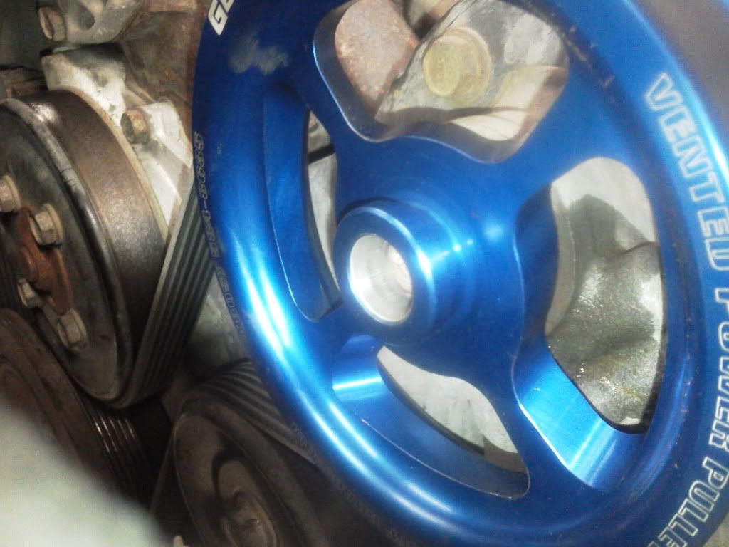

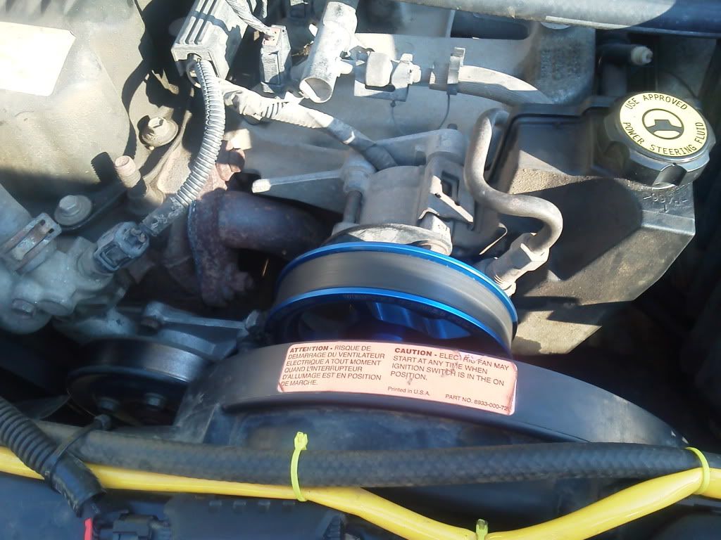

Last time I went wheeling I had power steering issues, it would fade when it got really hot so I did some upgrading.
I put this cooler in the circuit along with a flush and put in royal purple fluid
I also put in a genright 10% overdrive pully, it steers easier now, I'll find ou how it does next time I go wheeling:

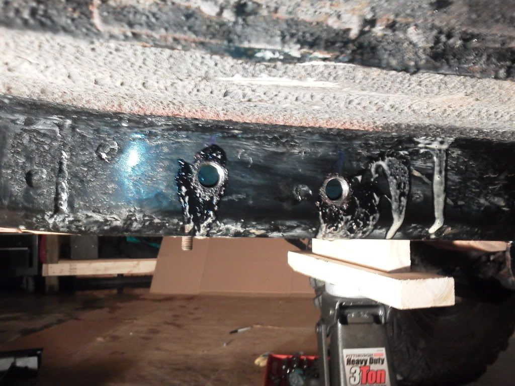

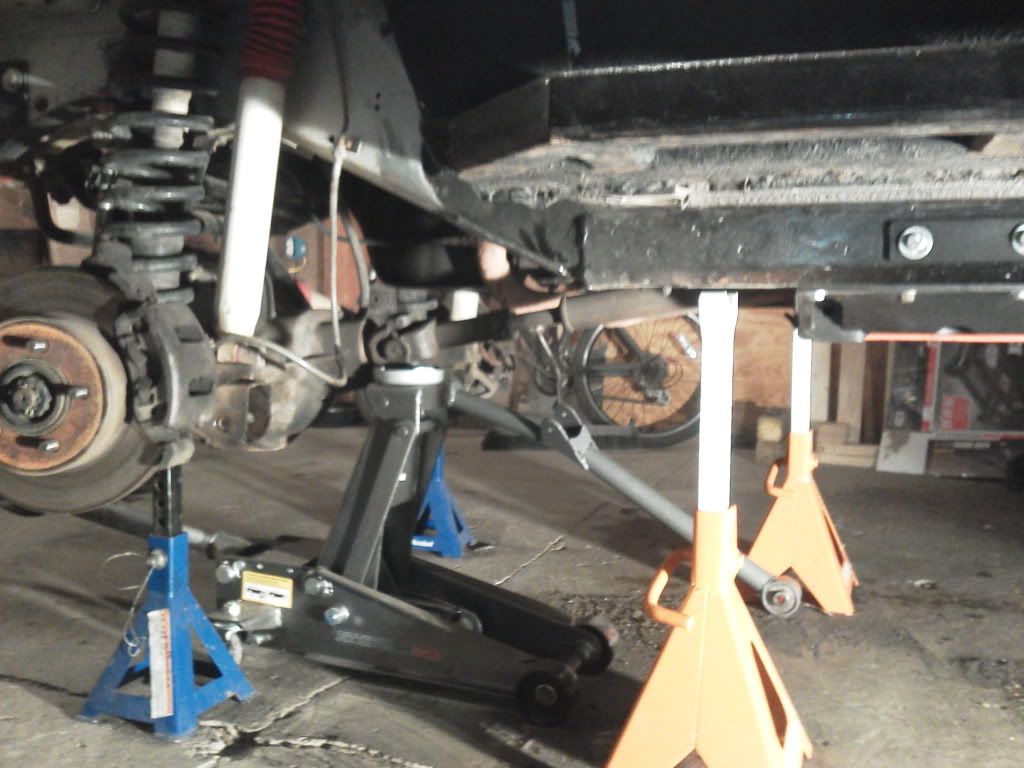

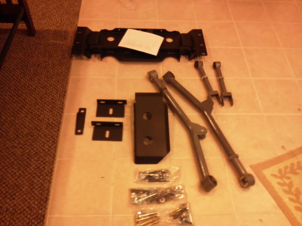

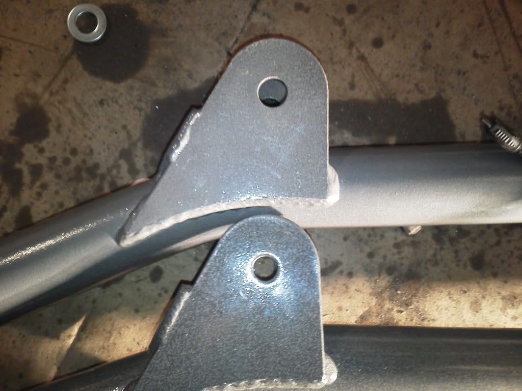

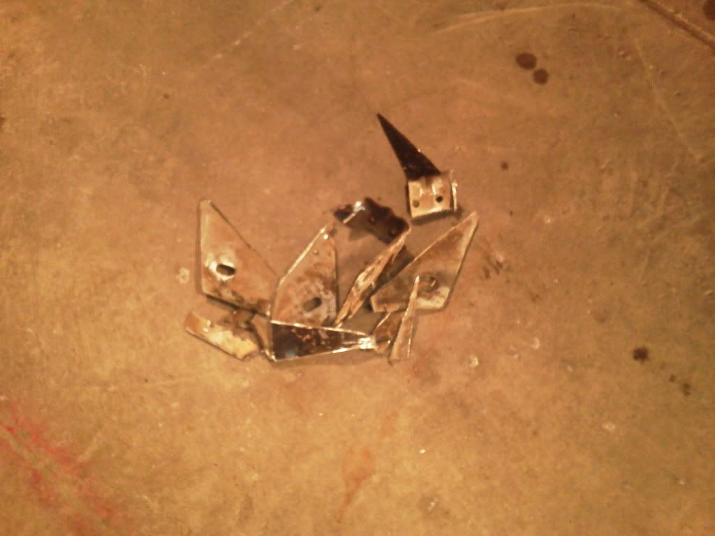

Got stuff!
to this:
and then derailed because of this:
The driver side arm has oversized holes!! so another is on the way..so untill then I wait...

Originally Posted by robd2003 View Post
Hey, when you get some time on the overdrive pulley let me know, my xj is on 35's that i just recently got, also where did you pick it up at?
I haven’t put a ton of wheeling time with the 35s but ever since the cooler and pulley I have yet to have any steering problems. Short of some type of assist set up it was well worth the 100 bucks, but I would also add in a cheap steering cooler also. I got it from Genright...

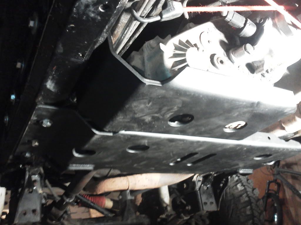

Havent been keeping up on here... but I havent done much to the jeep...so heres a cap of the last few months....
Cleaned it good..if you have never clay bared your jeep I recommend it it made it look 110% better.... Replaced the crappy s-10 bastard packs with some nice BOR 4.5 super flex packs. Took it wheeling for the first time in Michigan and blew my driveshaft up, good thing I had a spare. Then didn't do much for a few months, decided I wanted to lower it a bit, so I found some 4.5 inch coils and swapped them for my 6.5s, still need to figure out what to do with the rear. I like how it sits now. I'm finally getting out for some wheeling this weekend so I'll see how it does...
