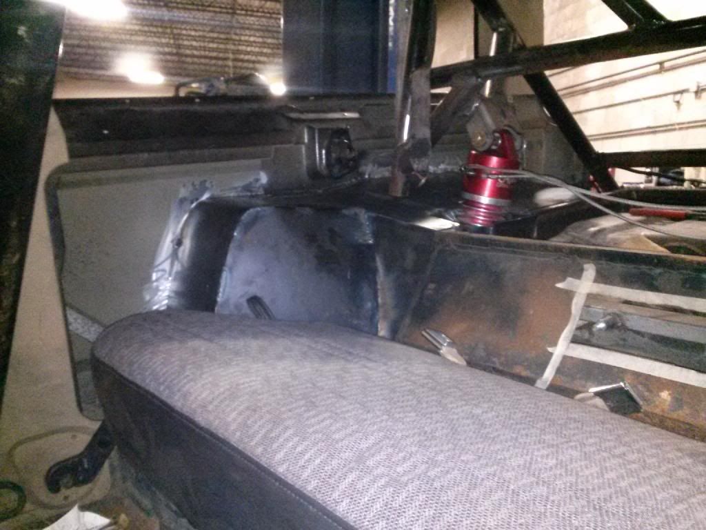

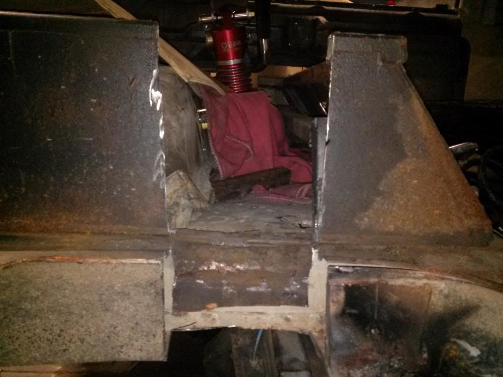

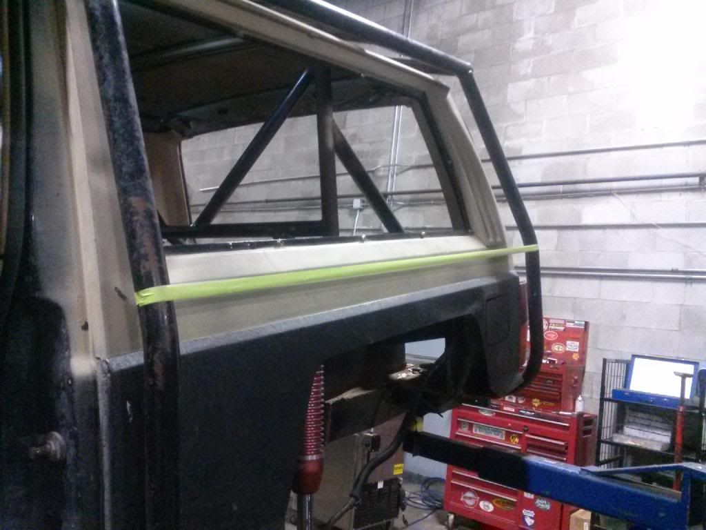

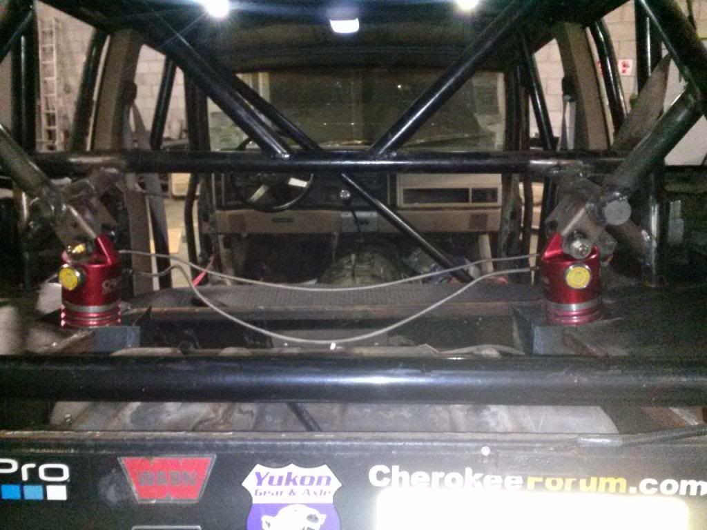

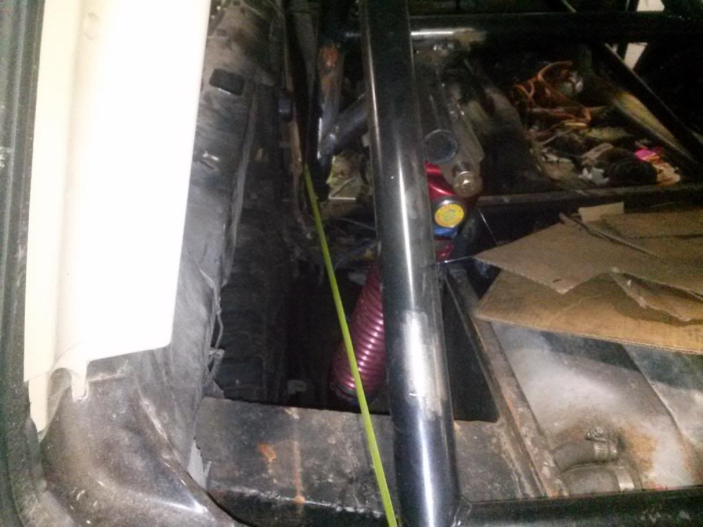

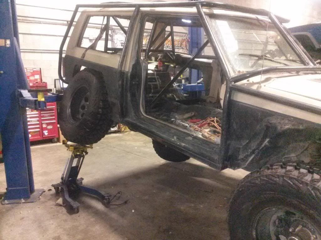

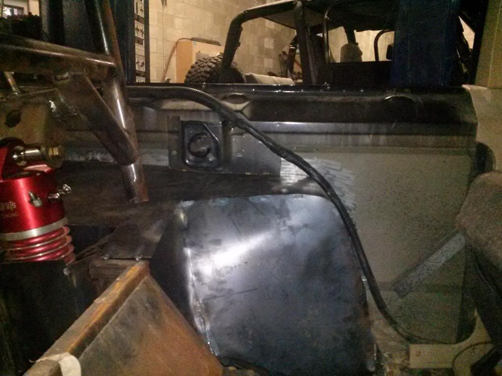

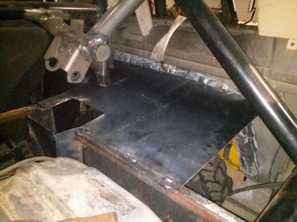

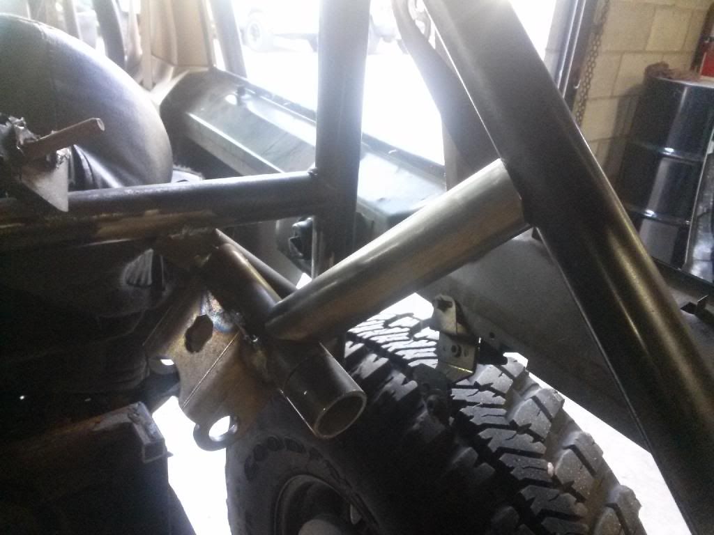

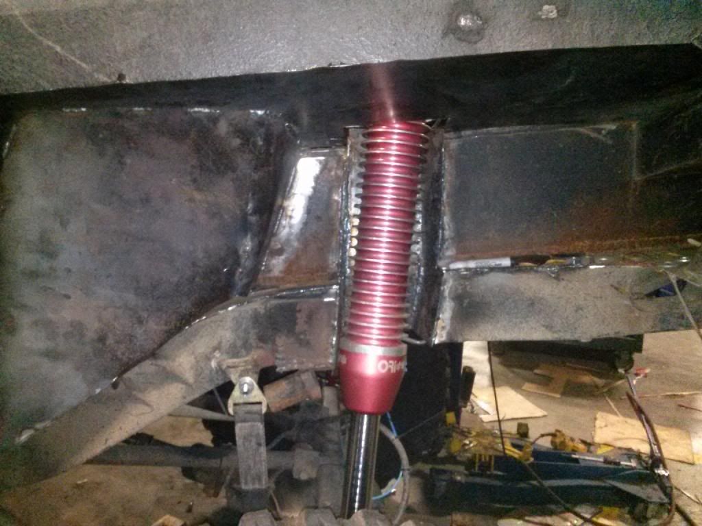

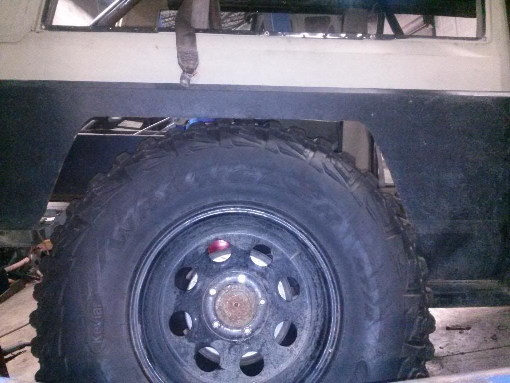

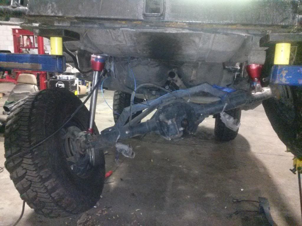

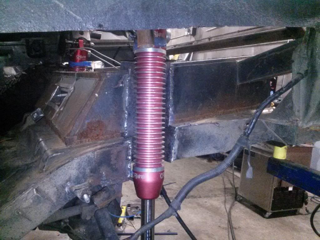

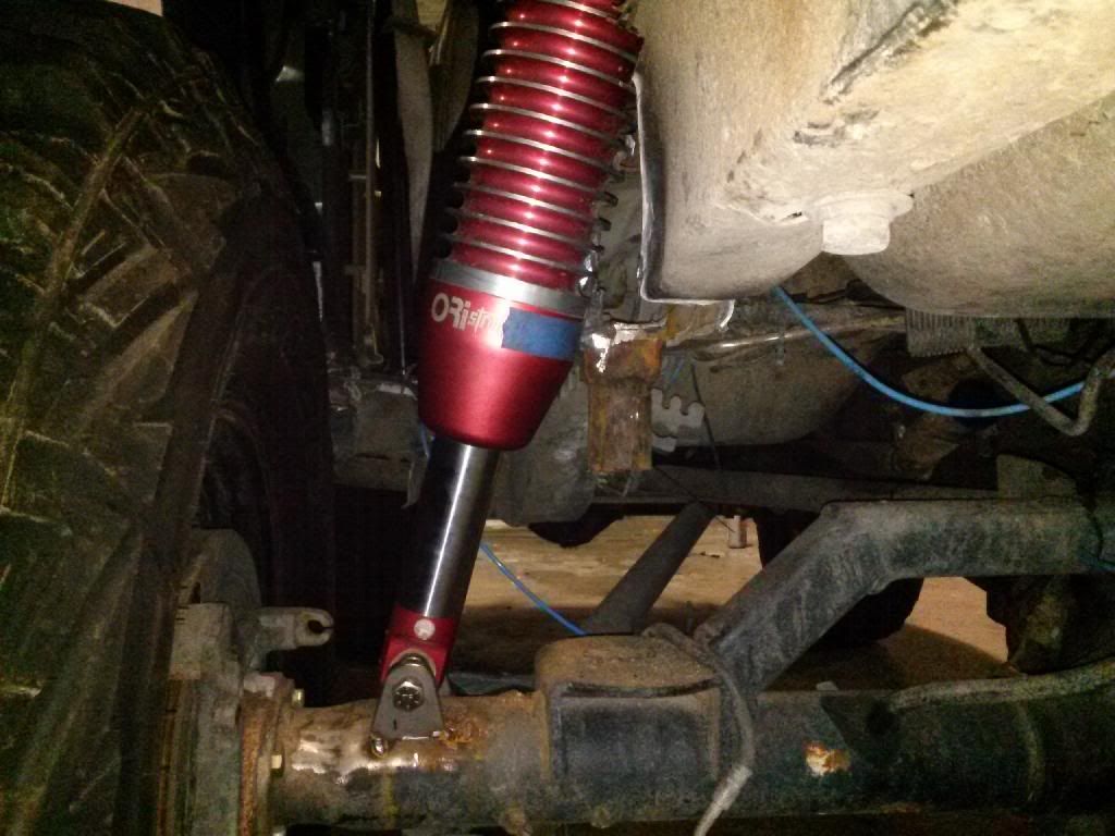

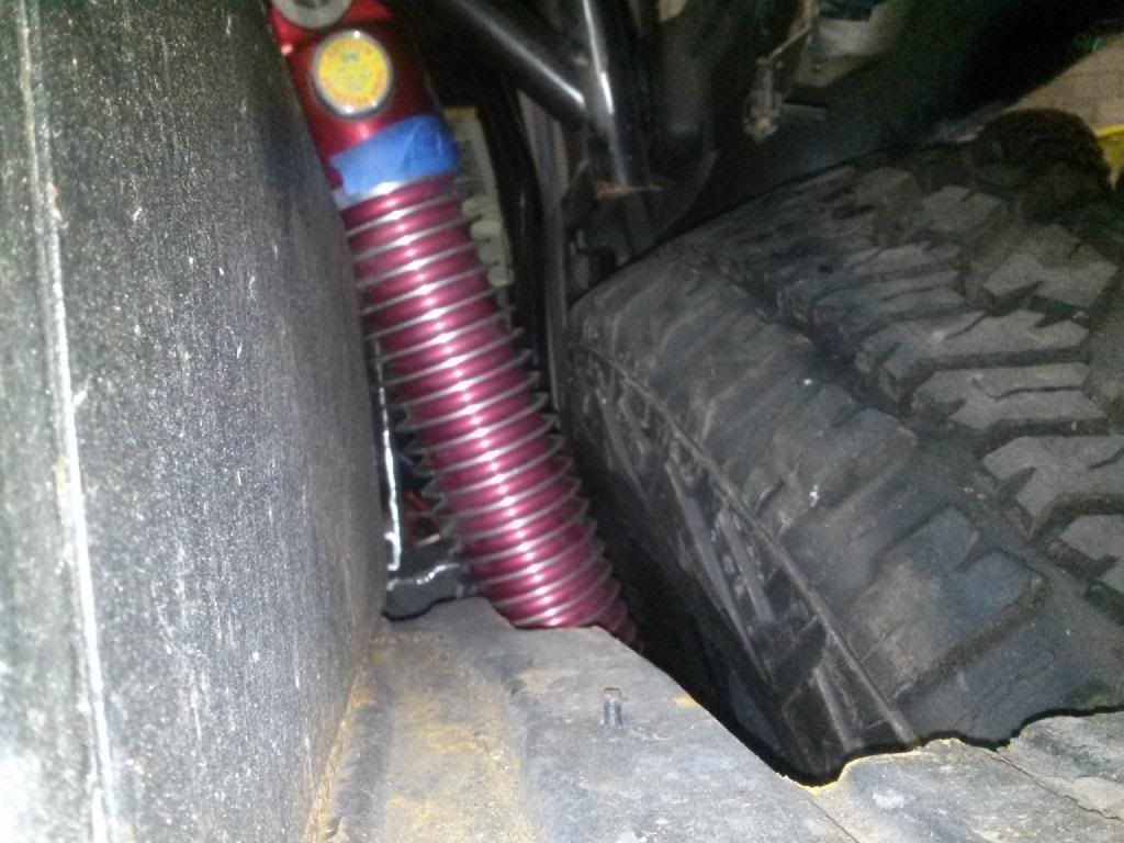

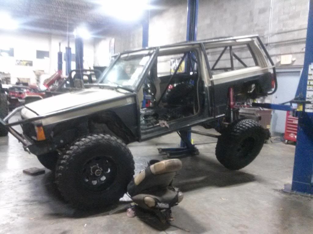

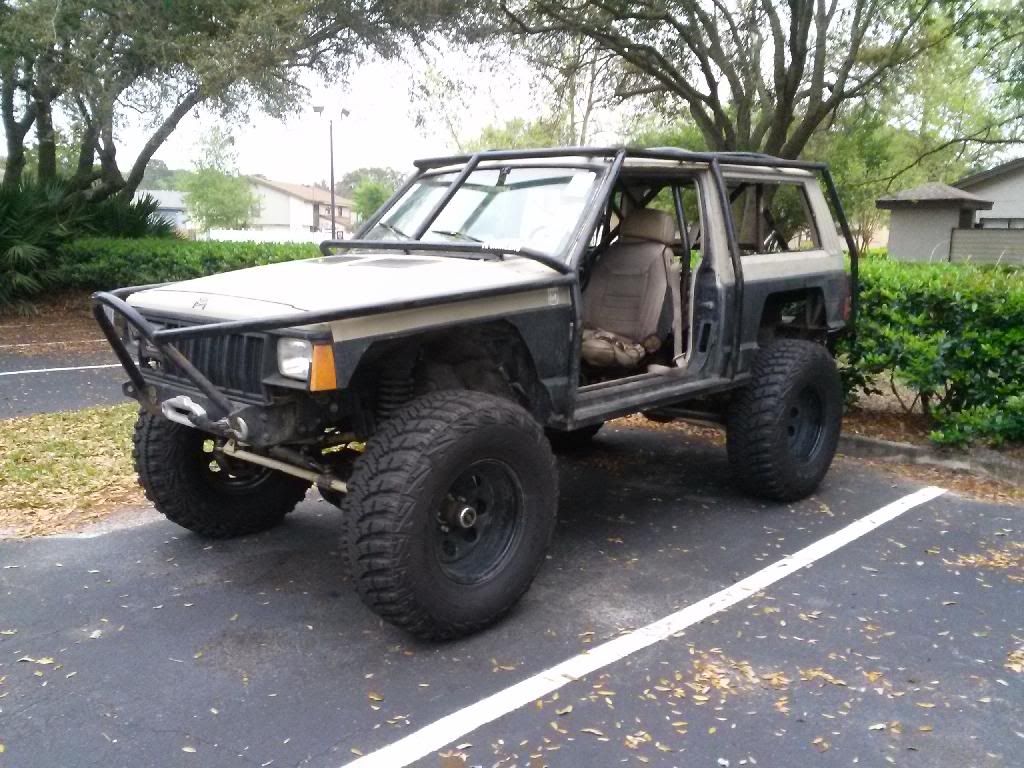

and some random mounting pictures and how my fenders turned out.
this is an unfinished picture, the end is cut down and capped
the clearancing i had to do to the frame and gas tank cover to clear the pretty larger shock
the notch somewhat plated in and test fitting the shock
some flex shots to test clearance
clearance between the tire/body and the shock is very tight with the DP3, but will be better with the smaller diameter STX that will replace it.
i am also planning on adding more tube to increase some the the rigidity i lost when i cut the frame rails in half
here on the outside under the window
and here adding to part of the cage on the inside
and some fender pictures, need to finish and paint still
how it sits right now.
