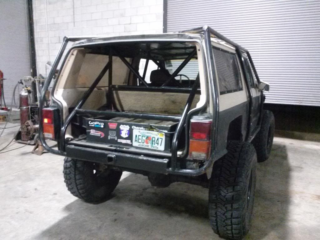

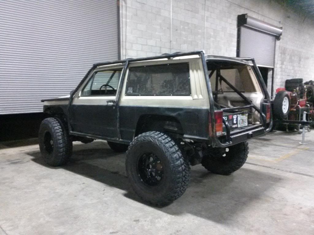

Couple pictures I hadn't posted

^^^ Man, I gotta say, that rig is unreal. Would love to see it in action, in person.

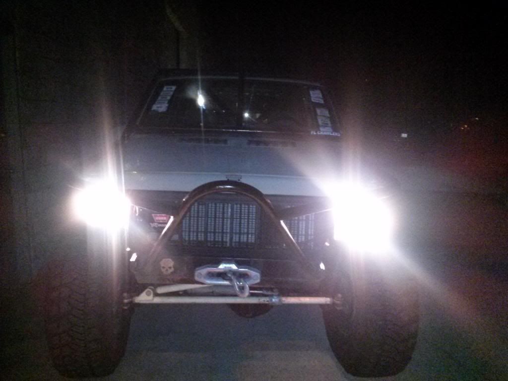

Popped it up on the ramp and hit up a local spot

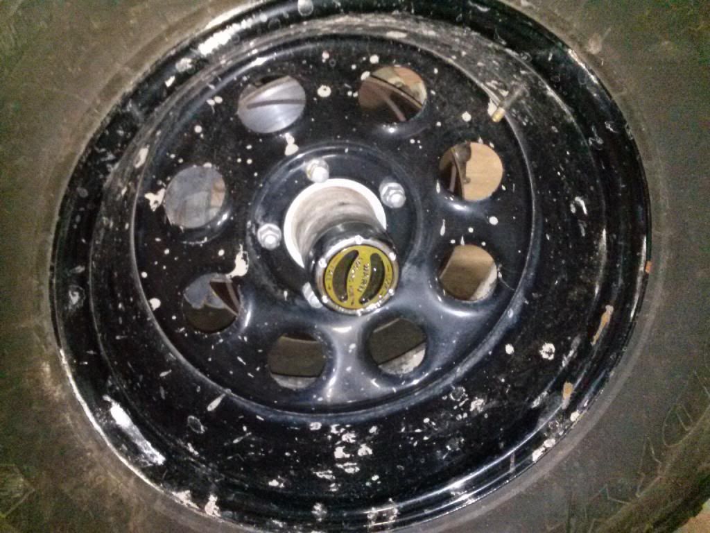

Posts: 2,280

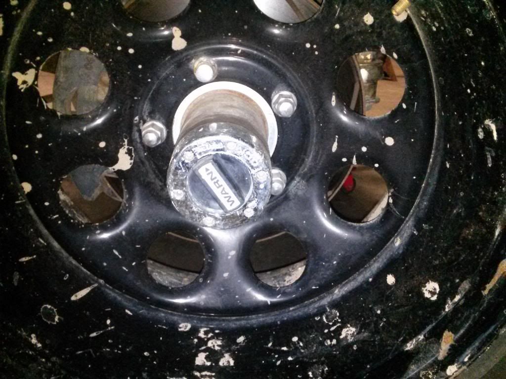

Got tired of breaking the warn standard hubs, so I ordered a set of warn premiums. Was considering the Yukon hardcore hubs, but not enough reviews out there yet for me to spend the extra.

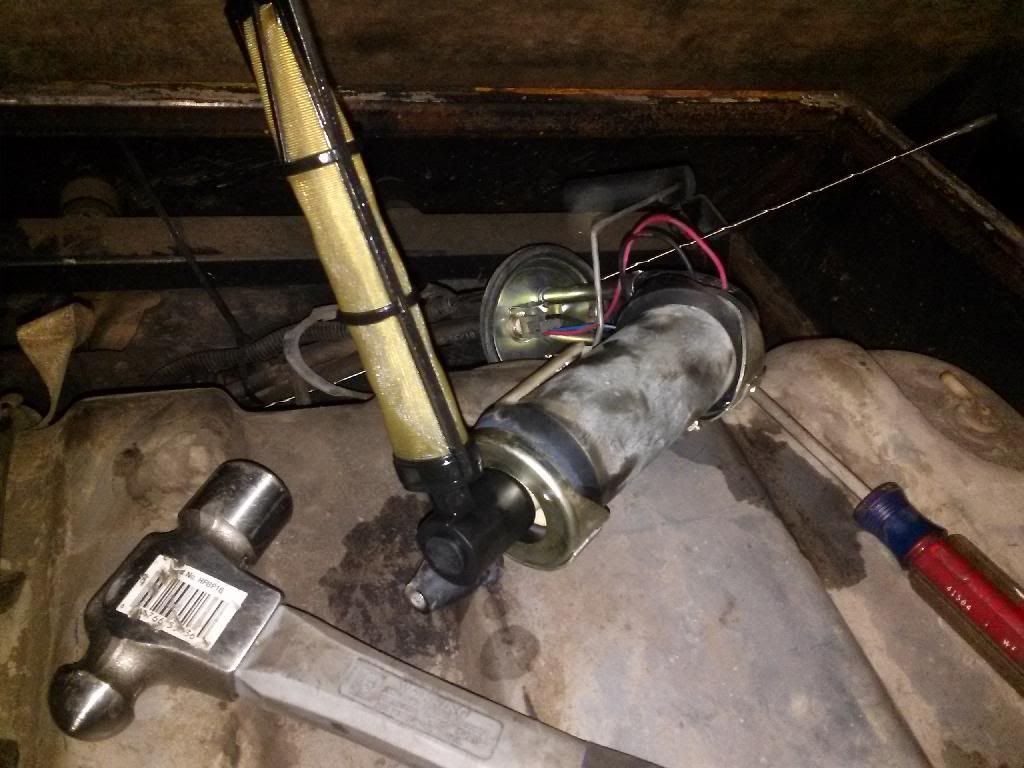

And pulled the pump out to put the pickup sock back on. Hopefully it helps with the high angle stalling.

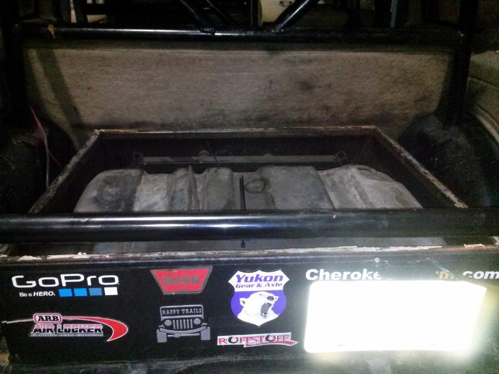

Looking good SFR. I really want to mimic your tank relocation setup one of these days. Any problems filling up or with fuel spilling out on the trails using factory filler location?
Filling up at certain pumps it will sometimes stop pumping if you try to pull the trigger all the way. No fuel spill though

Originally Posted by crockett07 View Post
Pfft! Mine does that without the tank relocation
I think it mainly does it because the tank is dented in
