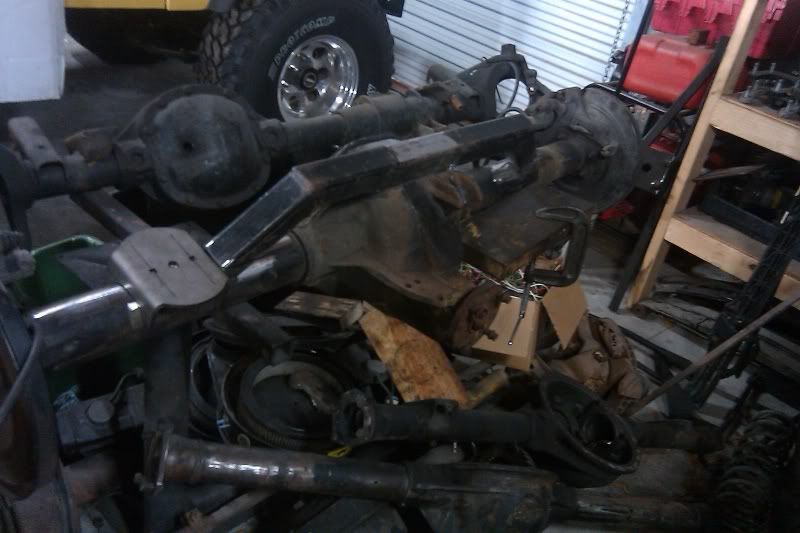

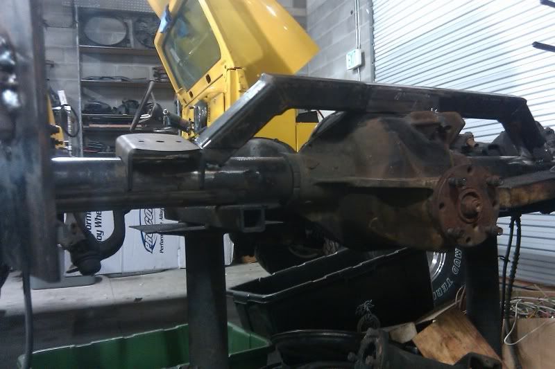

anyways, heres a picture of the beginning of my truss...

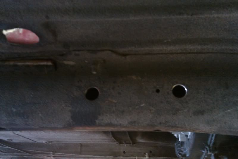

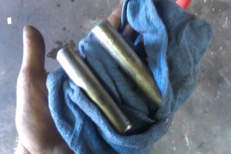

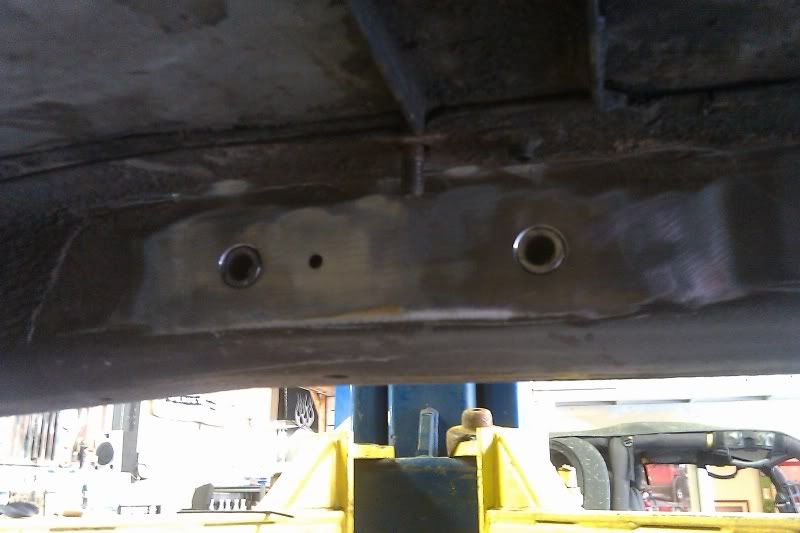

so tonight i drilled some holes through the frame and made some bosses for the 8 bolts that will be bolted through the frame rails supporting the crossmember.
i didnt get a chance to weld them up tonight, but first thing in the morning.

welded...

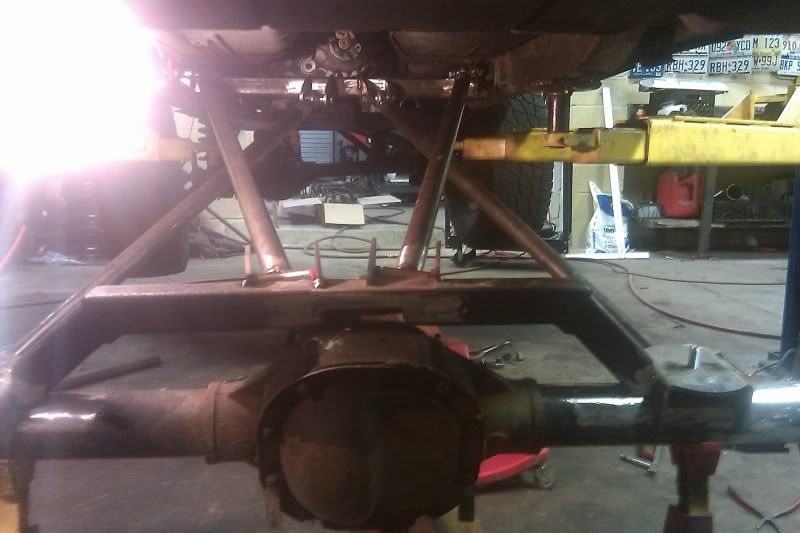

also, if anyone local to jax feels like coming out to lend a hand, i will be mocking everything up under the jeep on saturday and tacking it all into place, so could always use a second or third pair of hands

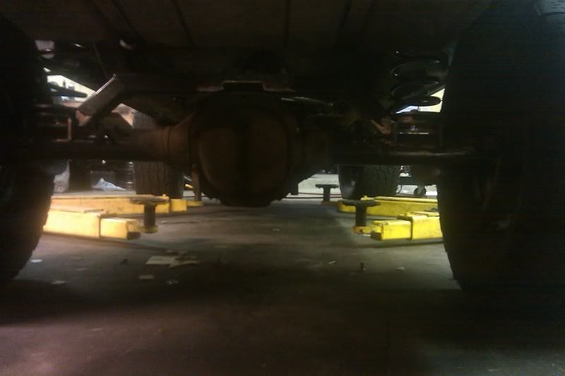

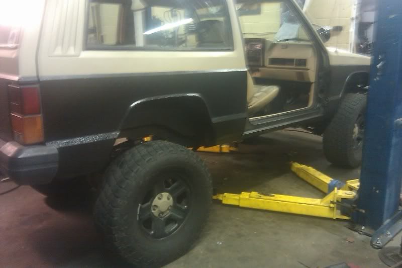

Uh, oh.....
Teaser pic

Originally Posted by alexrule123 View Post
I believe I am legally allowed to say I hate you
lol, i still need to try out a few different coil springs. this ****er sits a little higher than i wanted
Which coils are you using now?
stock front 4dr JK coils, i tried stock XJ coils but they sat really tall.
i have a few different sets of front and rear TJ/LJ and some others i will try
