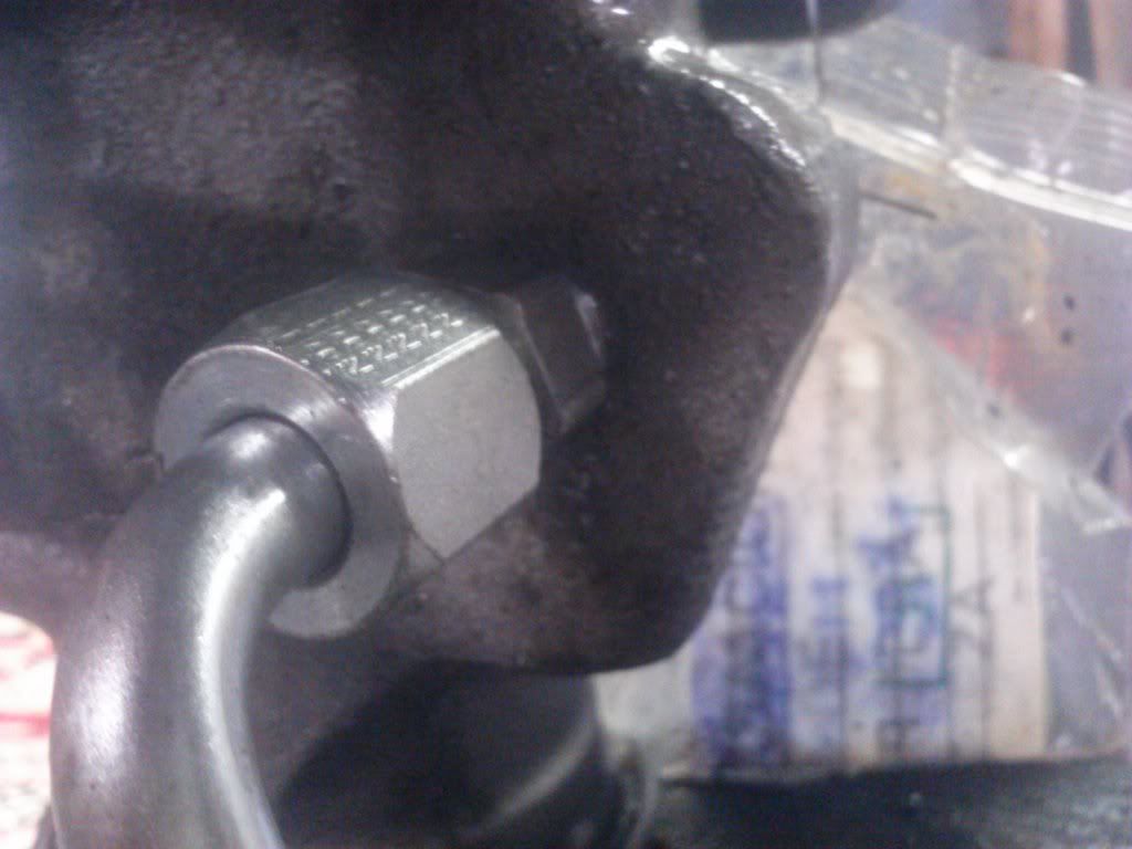

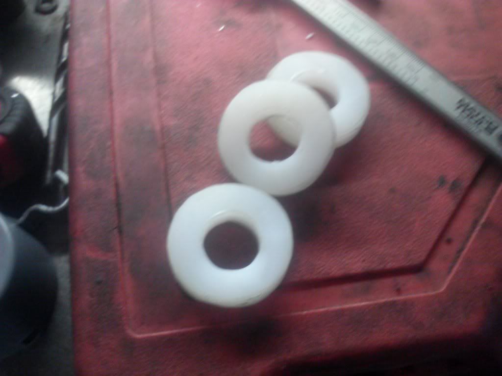

Had a little time after work today so I put in some work on the hydro.

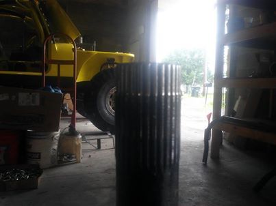

Made some uhmv spacers for the hydro assist. Turns my 8" ram into a 6.75" ram.

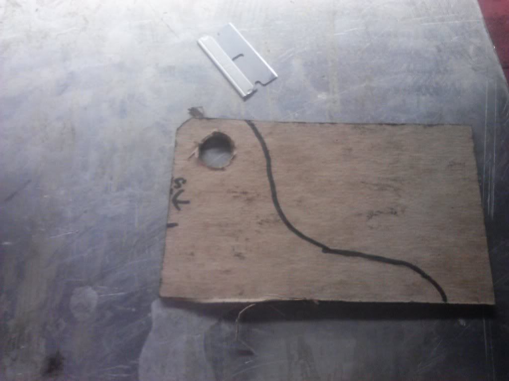

And made some templates and cut out the mounts for the axle side ram mount

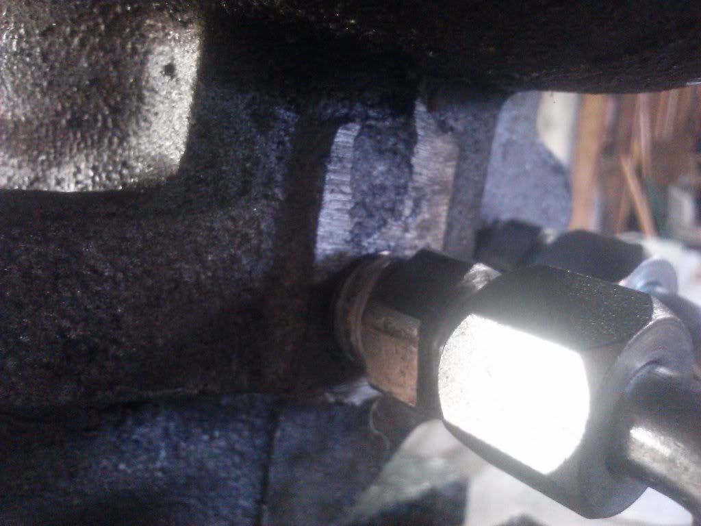

Some updates. Picked up a nice set of snap-on ratchet straps for $20 from Costco.
Got some balancing beads for my currently unbalanced tires.

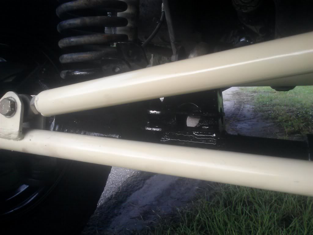

Made and welded the axle side ram brackets on. along with repainting steering links with a little better paint.
And got the box ready for installation.

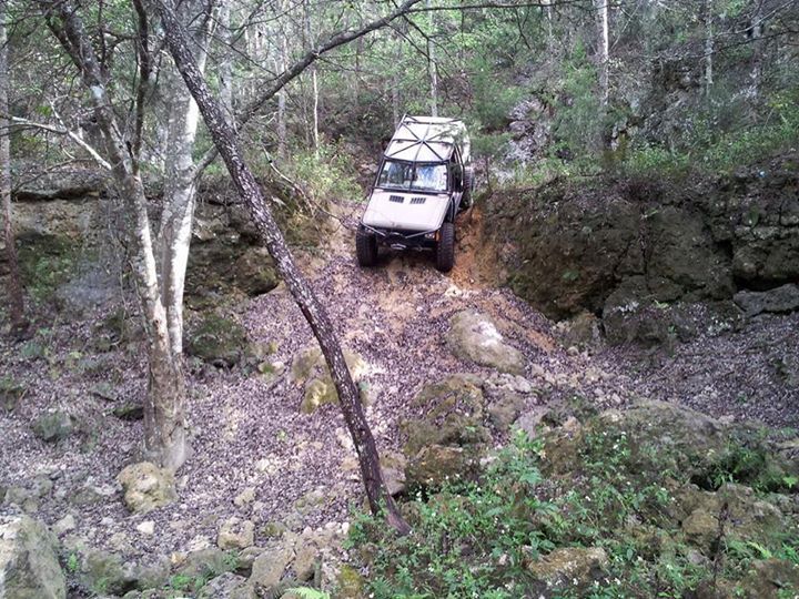

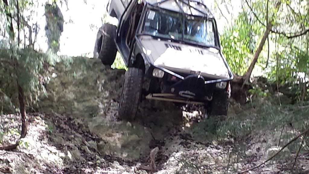

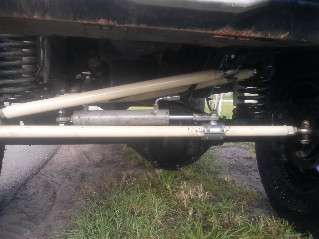

got the hydro all buttoned up (works fantastic) although a little sensitive on the highway.
and went wheeling Saturday. only pictures I have so far.
also broke the locker and stripped the splines on the rear chromos while trying a pretty difficult line.

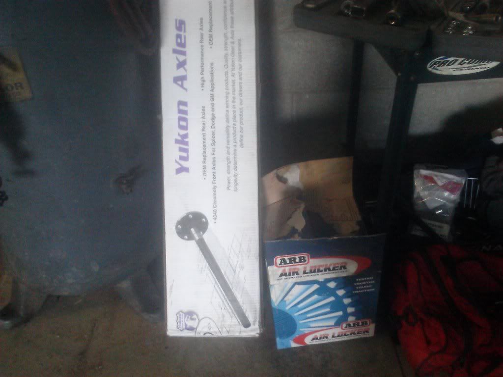

Shafts are being warrantied, and I'm trying to work out something to get an arb instead of another ected
Why did it fail?

Couldn't quite handle the abuse. Plus, witnesses were saying they kept seeing a tire slip.

Yea the e locker apparently doesn't have a great reputation in the 8.8 when used hard. So I wouldn't want to take a chance of breaking one of those also. Plus it's still on a backorder. And the ARB is known for it's strength.
I can say though that I did give the ected a fair test. And I do think with most people wheeling it would be just fine

Your right. Honestly I'd prefer a spool. This is just me and I'd say you have given more than a fair review! You tested that to the max. If I do ever go bigger I want one up front.
