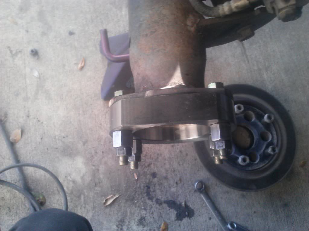

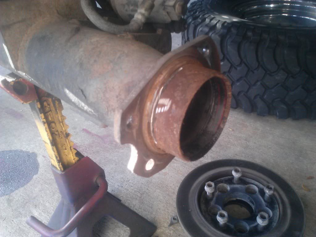

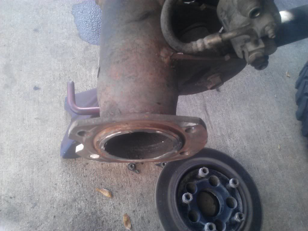

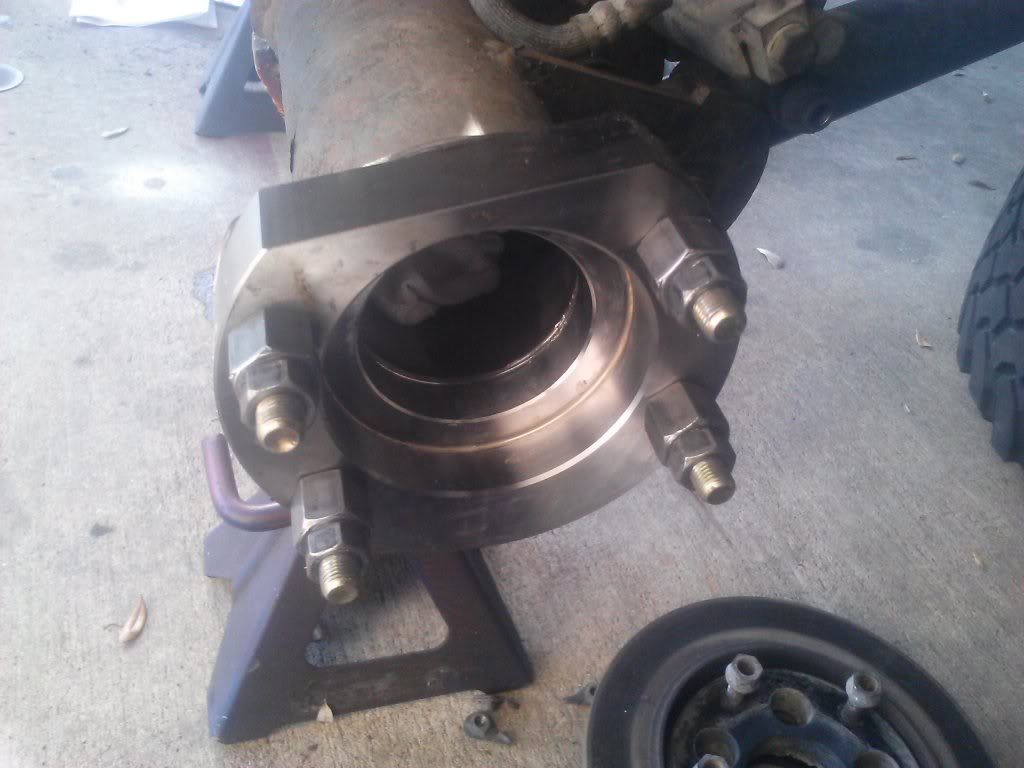

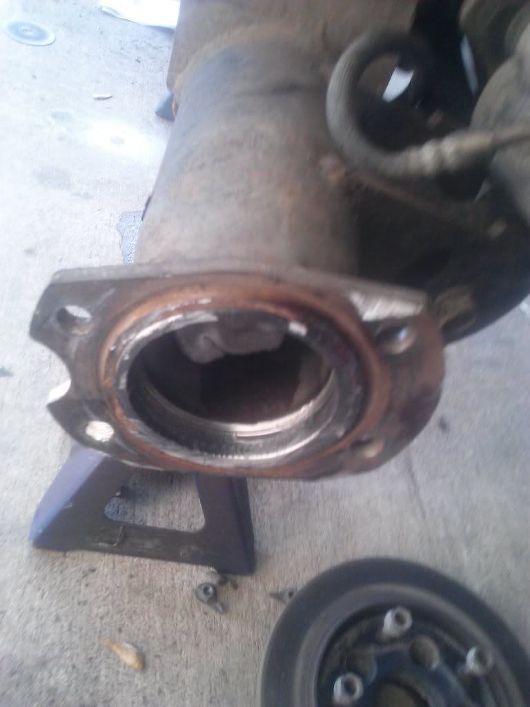

Got to work on the c clip eliminator.
Cut off the ends of the tube.
Deburred the inside
And pressed on the new race housing

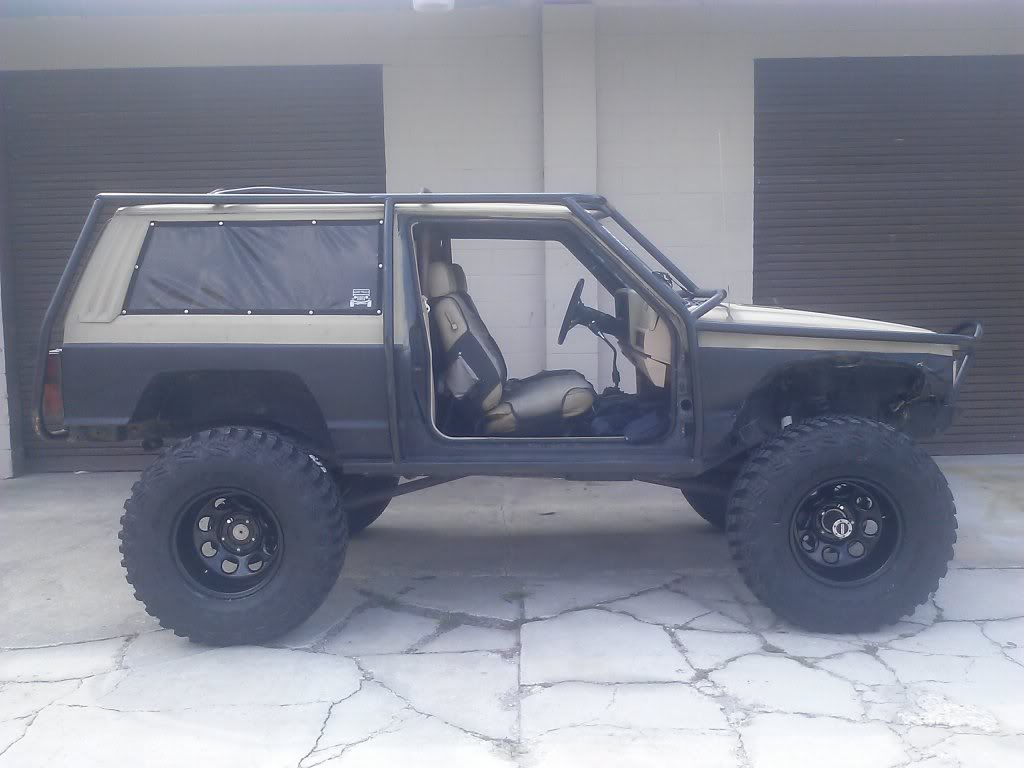

post #808 of 1103 Old 09-14-2013, 09:22 AM
S8NNG8
S8NNG8's Avatar
1995 XJ Cherokee
Location: Helena
Posts: 8,837
Let's see 'em out of the box
D3<!L!>3D
S8NNG8 is online now

post #810 of 1103 Old 09-14-2013, 02:36 PM Thread Starter
SFRautomotive
#WannaBeRockBouncer
SFRautomotive's Avatar
1992 XJ Cherokee
Location: Jacksonville,FL
Posts: 2,280
