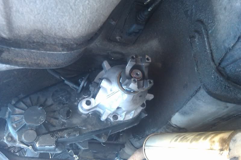

yay progress...

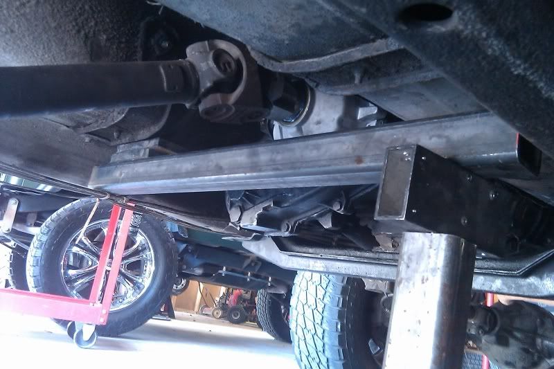

so i did my SYE and tucked my transfercase as far up as i could without cutting floors. the top of the shifter plate actually comes through the floorboard a little
and also yesterday i began mockup and some welding of my rear crossmember...
the bottom of the crossmember is flush with the bottom of the frame rails
i dont seem to have any pictures of any of the welding i did or any of the supports i made.
but for a quick update on whats being used.
crossmember is a 2x2x.250, i decided against my original idea of using 2x6x.250 because it was just uneeded weight. so instead i will be building a type of gusset that will add some more rigidness to the crossmember.
and the frame plates im using will be .250. and i will be doing a "clamp" style mounting. (similar to the way Rustys mounts there front crossmember for the long arm kit)

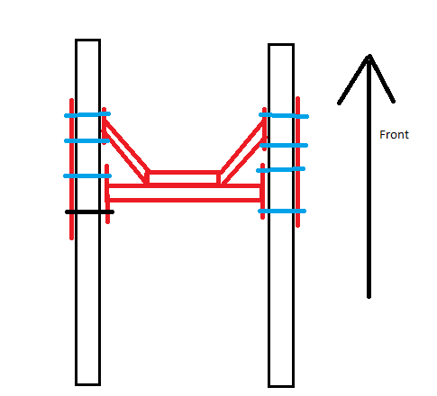

post #71 of 1103 Old 04-17-2011, 09:41 AM Thread Starter
SFRautomotive
#WannaBeRockBouncer
SFRautomotive's Avatar
1992 XJ Cherokee
Location: Jacksonville,FL
Posts: 2,280
how the crossmember will be
black= frame rails, blue =bolts, red = crossmember metal

oh and there will be sleeves where the bolts pass through the frame to prevent crushing
