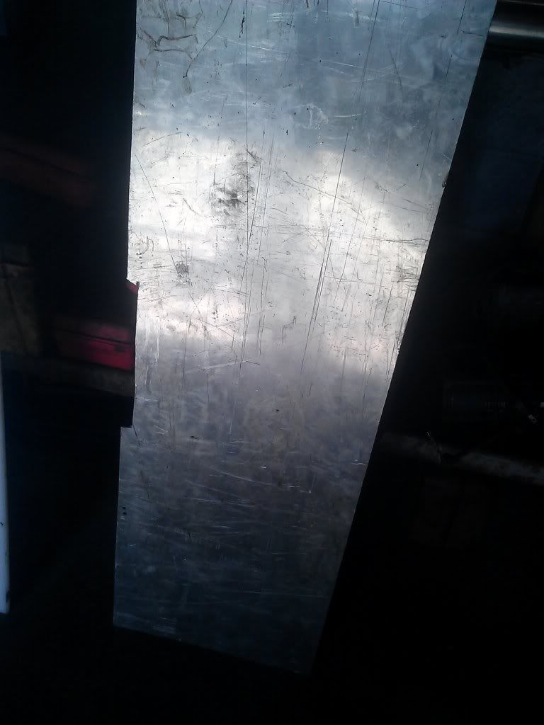

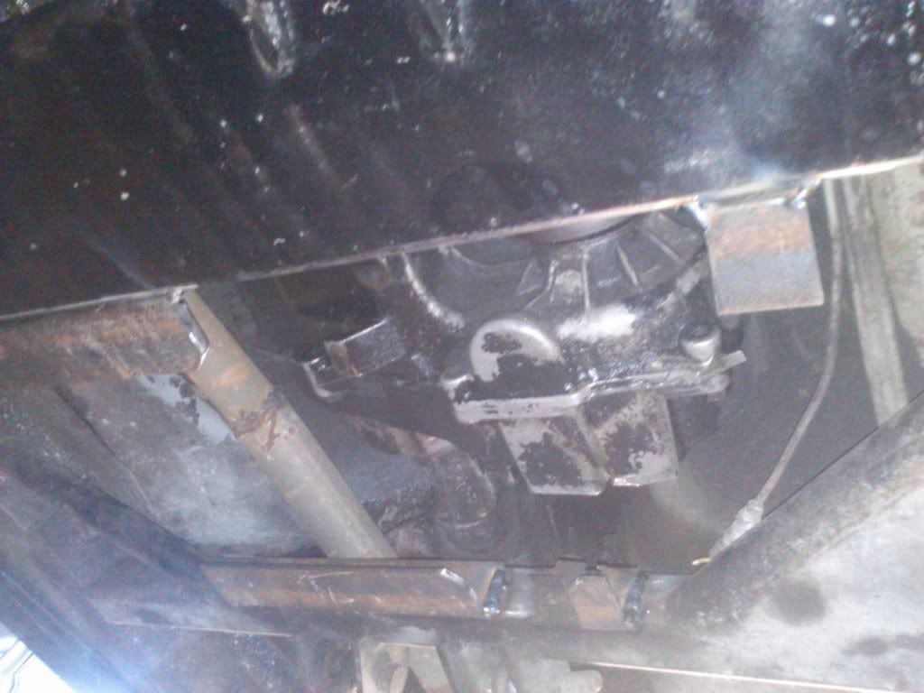

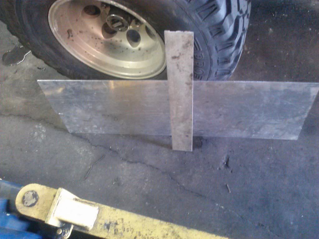

So started my skid plate.
The materials... 1/8" aluminum plate, some 1/4 aluminum strips, some 3/16" angle, and a 2x3' piece of 3/8" uhmv.
I cut the aluminum to the shape of the opening between the 2 crossmembers.
And I cut the angle into a few pieces and welded them to the crossmembers. These will serve as some of the mounting points for the skid.

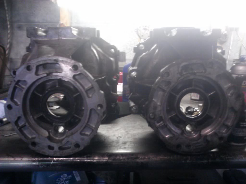

Well I clocked up my tcase by using a tailshaft housing from a yj ax15. Doing this moved my tcase up so I can make a flatter skid and allows me to use a 1 piece shaft. so yesterday I built a new front driveshaft.
