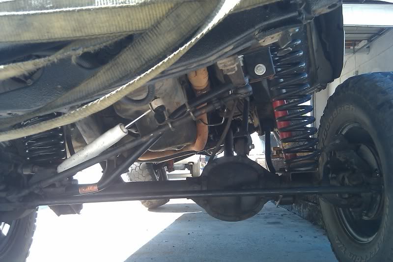

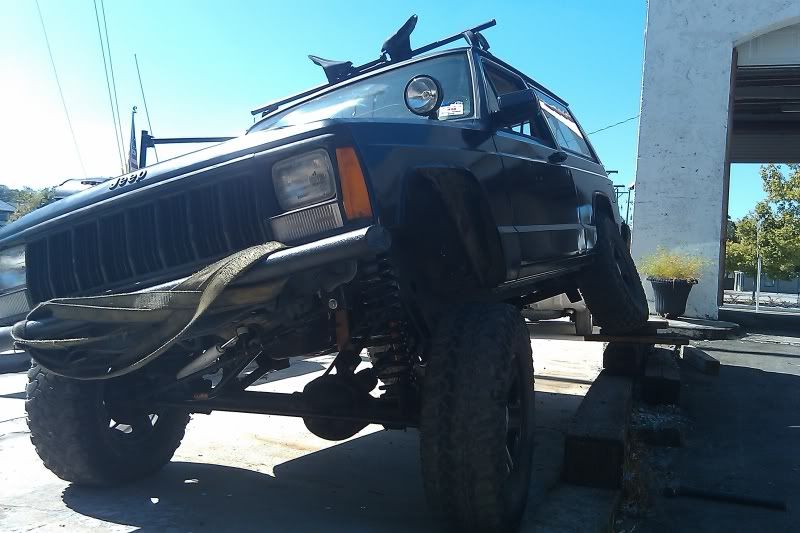

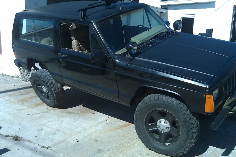

played around at the shop today testing the suspension flex a little.
the rubicon shocks arent enough anymore, time for some longer travel shocks and longer brakelines for the front.
also played with the rear spring pack and removed one of the leafs. it now compresses the way i want it to. and after i install some longer shackles i should have more of a droop improvement.

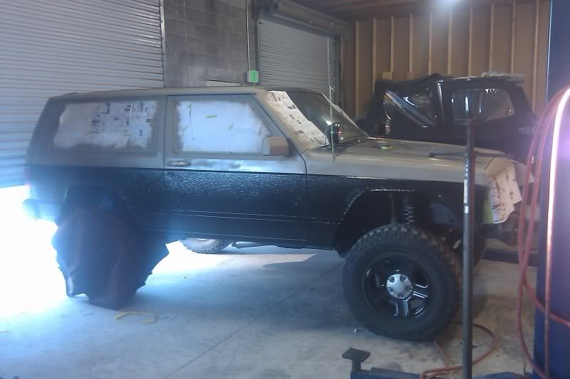

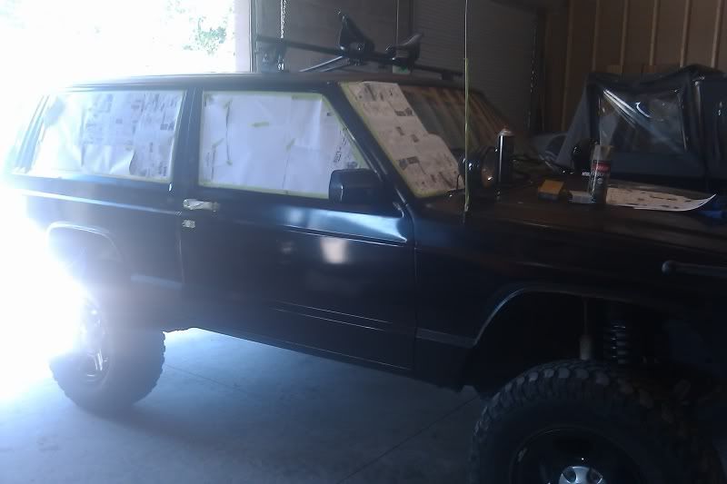

did some paint and bedliner spraying...

the paint and liner looks great. what kind of liner do u use

its the rustoleum roll on liner, but i sprayed it through an undercoating gun

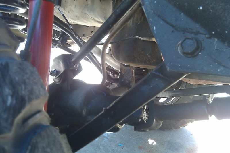

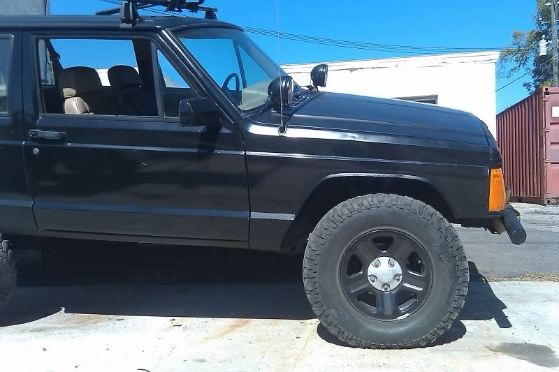

tossed in some 12" shocks up front
