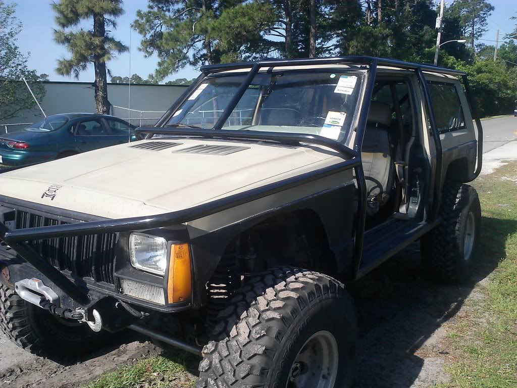

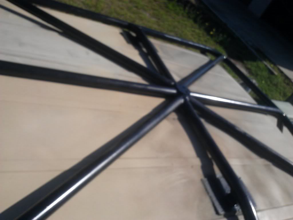

Added some cage tubing
And have the cage and tan half of the Jeep a coat of paint

post #515 of 1103 Old 04-24-2013, 05:14 PM
crockett07
1992 XJ Cherokee
Location: Lake wales
Posts: 1,012
What is that sticker on your header panel where the jeep emblem was?
crockett07 is offline
post #516 of 1103 Old 04-24-2013, 05:31 PM Thread Starter
SFRautomotive
#WannaBeRockBouncer
SFRautomotive's Avatar
1992 XJ Cherokee
Location: Jacksonville,FL
Posts: 2,280
our shops logo and name, same as what is on the windows

post #517 of 1103 Old 04-24-2013, 05:32 PM
Project1
Location: Florida
Posts: 2,716
man cage looks great

post #518 of 1103 Old 04-24-2013, 05:32 PM Thread Starter
SFRautomotive
#WannaBeRockBouncer
1992 XJ Cherokee
Posts: 2,280
id also like to point out the roof looks like ****, i bought some cheap spray on tan bed liner to use on the roof and it was terrible

post #520 of 1103 Old 04-24-2013, 06:31 PM
Project1
Location: Florida
Posts: 2,716
dont you hate that ... err .... I have pretty good luck with dupi color bedliner .... but they have one in a blue can ... then they have truck bed armor in a black can that kinda sucks.
Its hard to see the paint in the pic but the design is killer
Project1 is offline

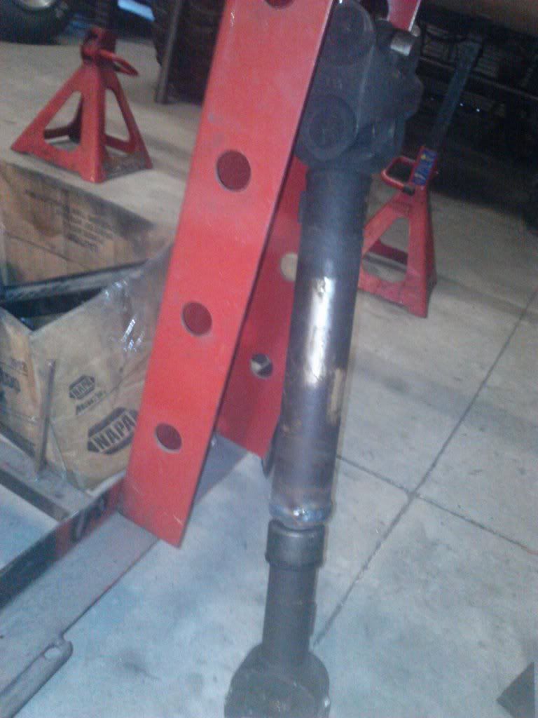

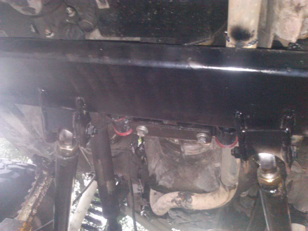

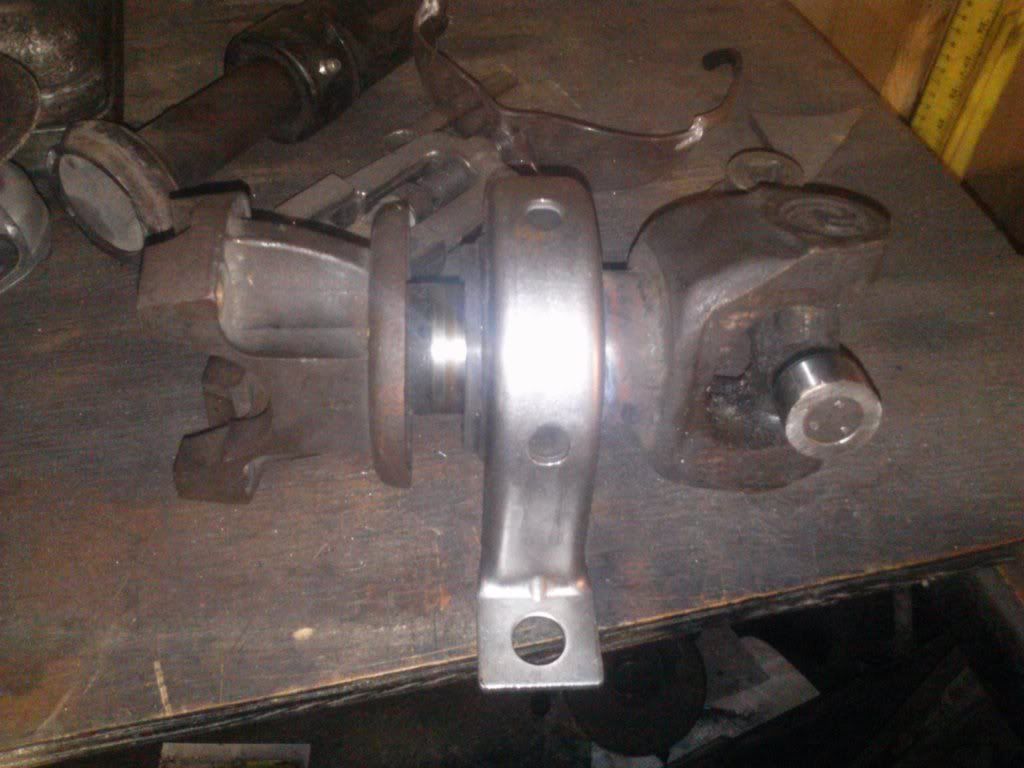

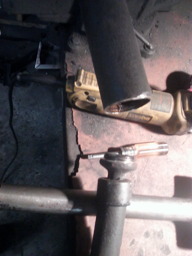

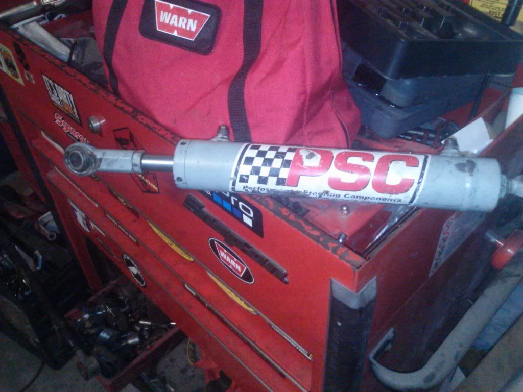

ram came in today.
painted my steering to stop the rust
made my 2 piece driveshaft to clear my crossmember at full droop
cut up my old front shaft and took 6.5" out of it
welded it back up
made my stub out of an NP231 output yoke, sliced up dana 30 pinion, a driveshaft carrier bearing, and a piece of an old driveshaft.
and bolted it all together
and some pictures

post #524 of 1103 Old 04-25-2013, 07:18 PM
YoureverydayXJ
Posts: 2,188
That two piece driveshaft is awesome! Where did you get the center part?
'00 XJ not quite there..
'00 XJ parts donor, '98 XJ body donor
YoureverydayXJ is offline
post #525 of 1103 Old 04-25-2013, 07:32 PM Thread Starter
SFRautomotive
#WannaBeRockBouncer
1992 XJ Cherokee
Posts: 2,280
the bushing/bearing?
