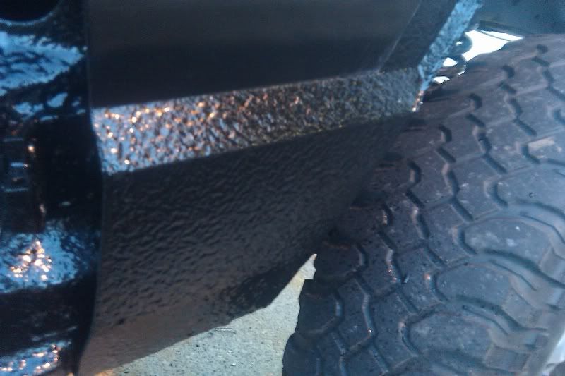

a little chop chop and some spraying. bye bye fender flairs.

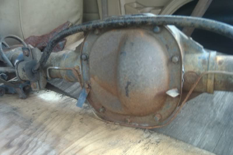

so, i just bought some awesomeness for the XJ....
Ford 8.8 w/ 3:73 LS
cant wait to put this in

Nice 8.8, now you know I have to ask did you d35 have a limited slip? If so I know of a blue xj that would love to have that

no, not this one man. but we can "lincoln lock" it for you if you want

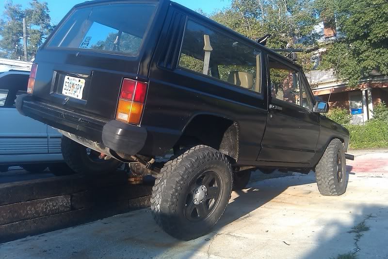

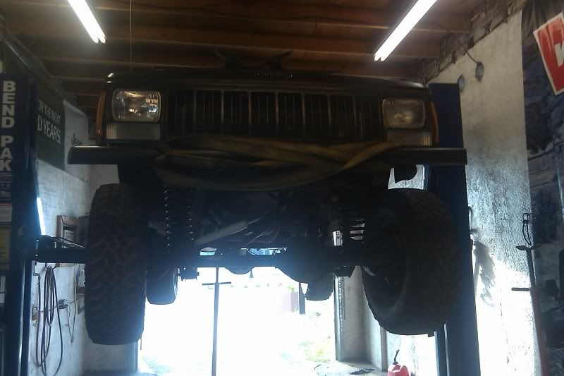

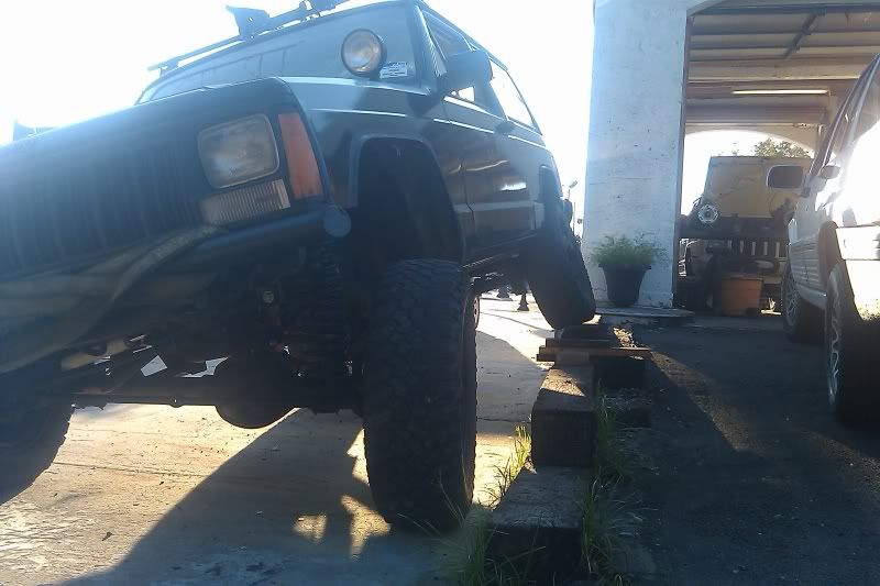

finished making some upper control arms for it last night and installed them. very happy with the results. the new ones allow more flex, are longer, and stronger than the stock ones. and it corrected the pinion angles cause by the JK LCA's
a little comparison between old VS new
installed
and some playing around in the parking lot testing out some flex.
may need to do some more trimming with the 33's....
