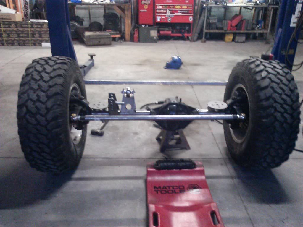

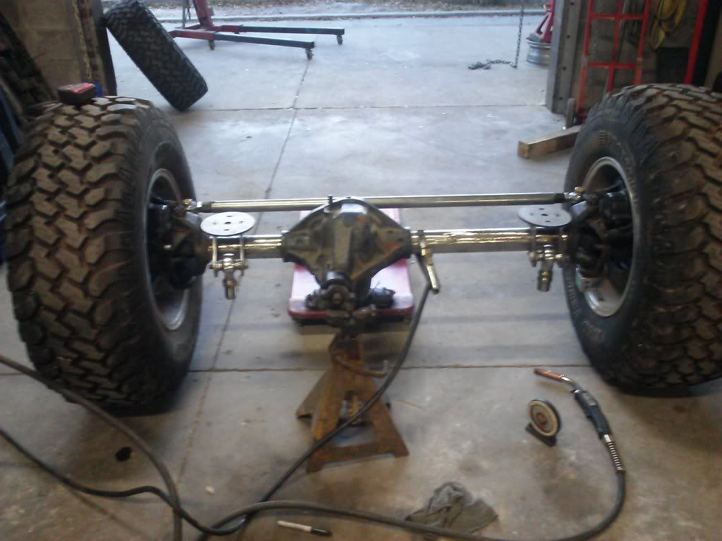

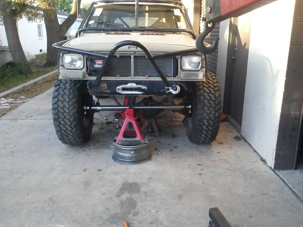

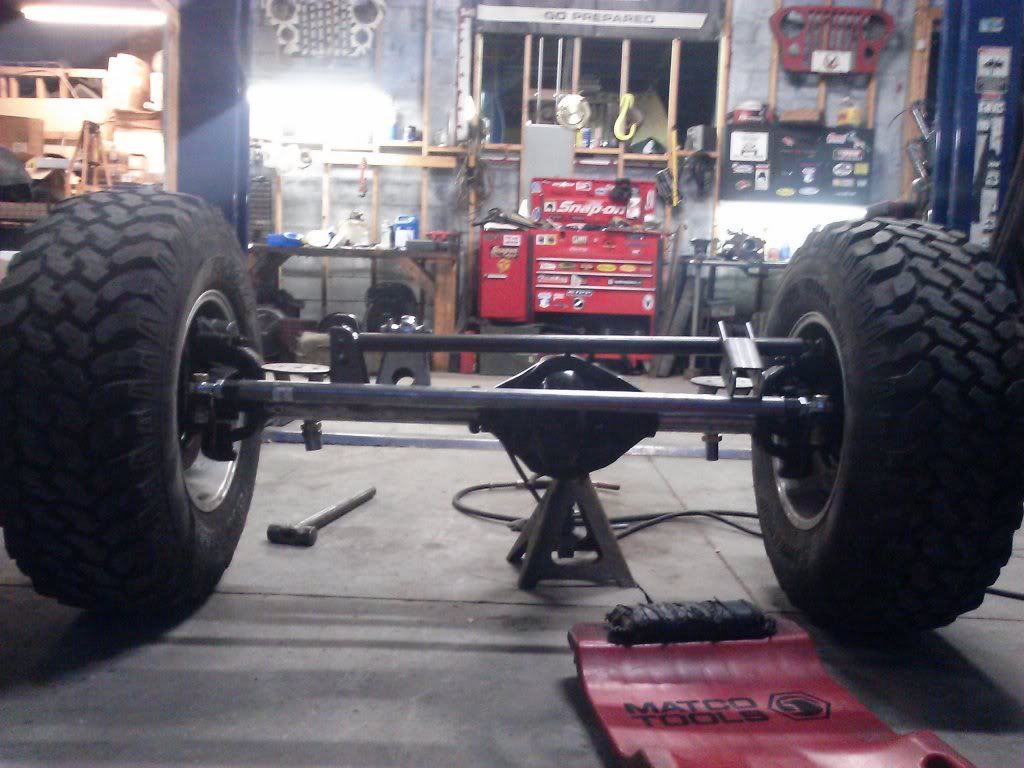

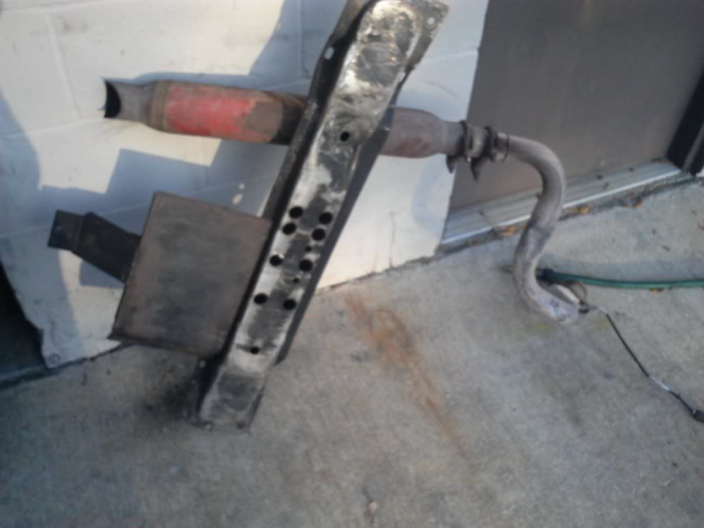

pulled out my stock crossmember and got my exhaust out of the way.
should be pretty easy to build a flat belly x-member.

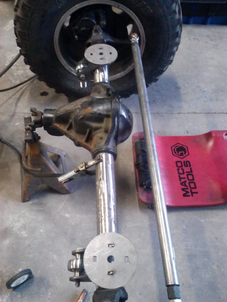

rolled the axle under the jeep to get an idea of my wheelbase and where everything is going to go.
set my caster and tacked in the coil mounts, and also tacked in the UCA mount and track bar mount about where they will end up

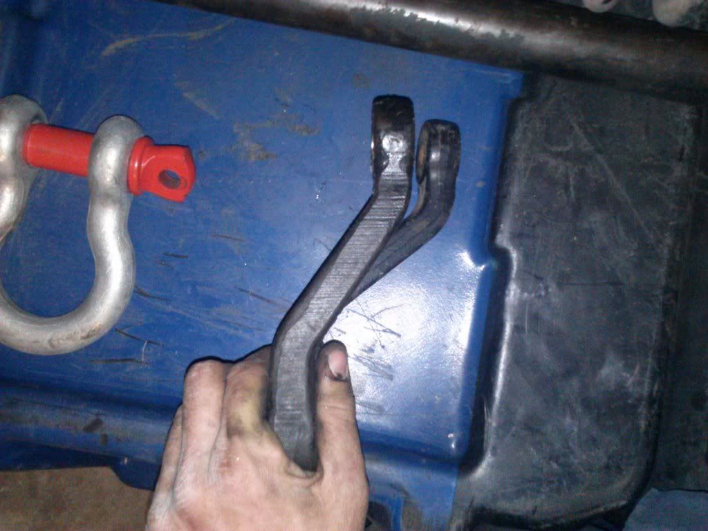

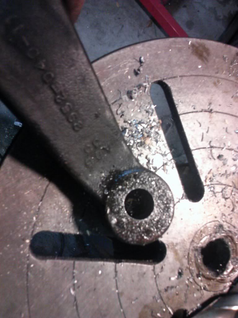

and decided im probably going to go with a TJ pitman arm for a little more steering clearence, the TJ pitman is around 1" higher than the stock XJ.
so i went ahead and drilled out the TJ arm to 5/8"
and i tossed together the new chromo's for it.

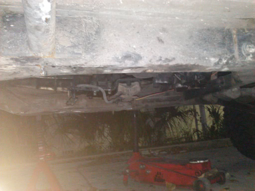

did some mocking and planning tonight.
tacked the crossmember together (still missing the side plates that will sandwich the framerail)
mocked it under the jeep, and marked will i will cut to make clearence for the bottom of the trans and driveshaft.
im thinking i will do this setup for my transmount off the front of the crossemember.
and cut up my floor some.
