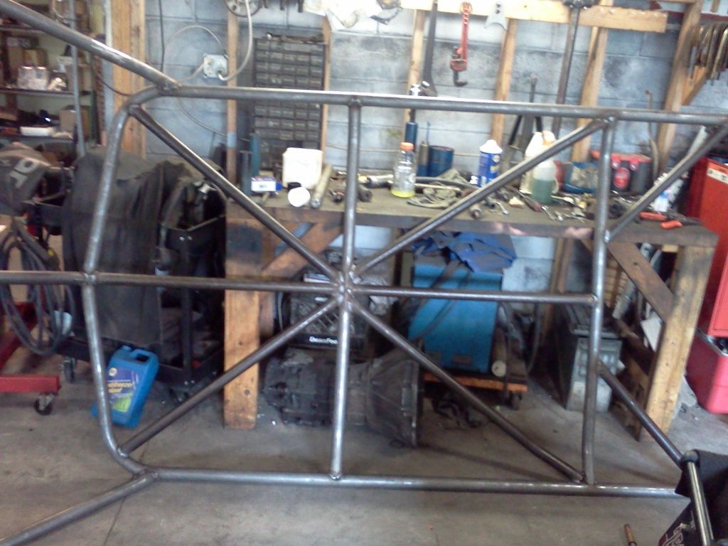

How many legs did you run?
only 2, 1 right infront of the spring hanger and one right behind the LCA mount.
it seems like enough and its tied into a pretty thick part of the frame rail. but, i will also have the exo tied into 2 places ontop of the slider to add to the overall strength.

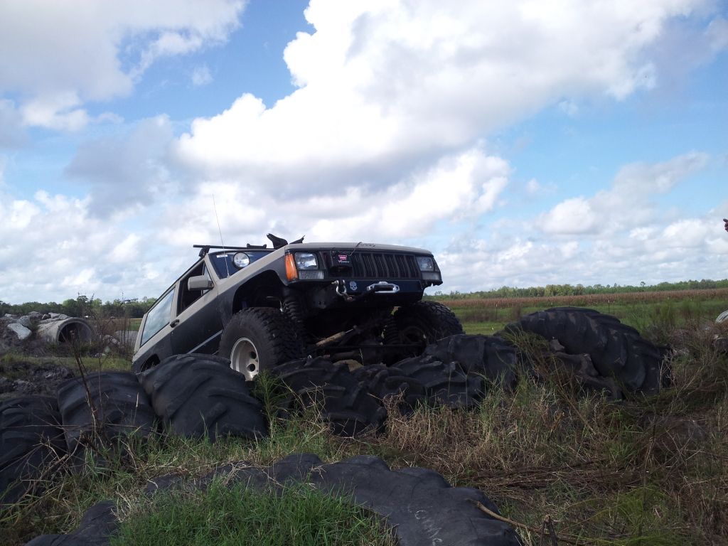

and some more random pictures from lately

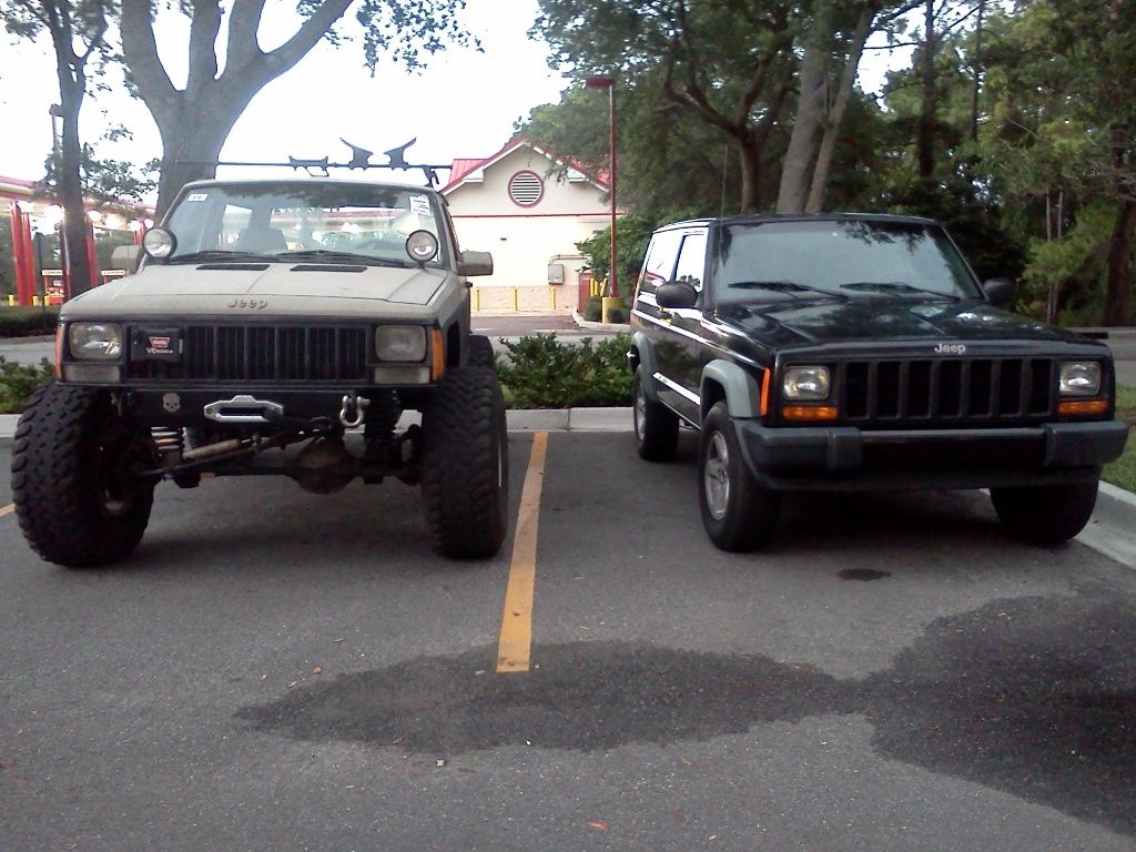

That's an adorable little blue XJ in the background oh and cool cage

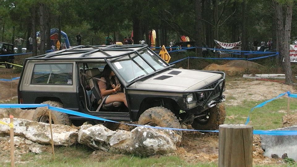

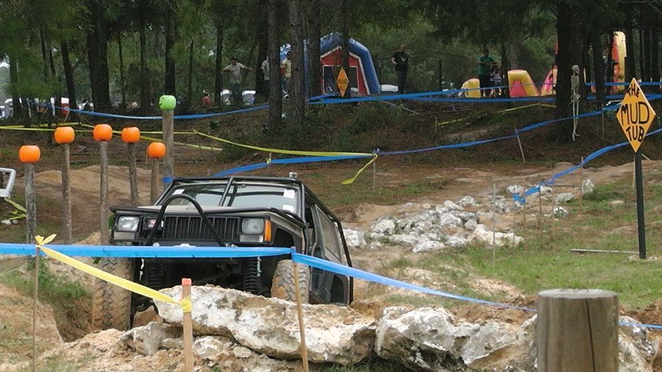

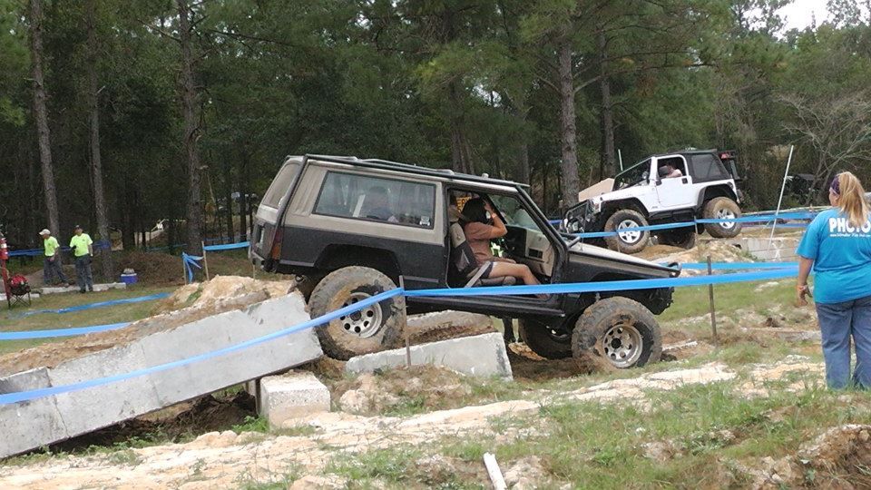

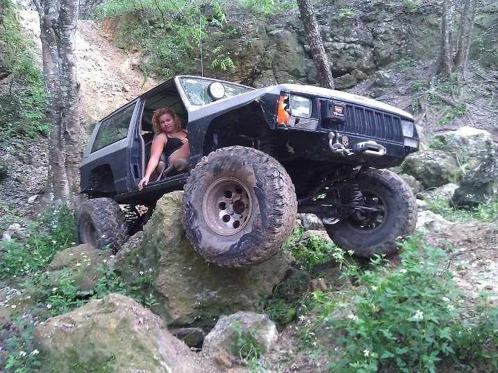

couple of pics of my girl driving my jeep during Jeeptoberfest.

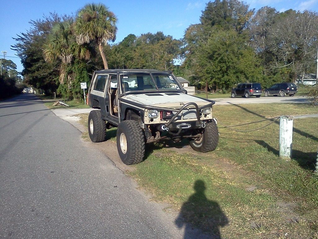

I usually don't like exos, but I really like the lines of yours. Is there a hoop inside right behind the front seats?
ibjeepin95 is offline
post #298 of 1103 Old 11-05-2012, 08:14 PM Thread Starter
SFRautomotive
#WannaBeRockBouncer
SFRautomotive's Avatar
1992 XJ Cherokee
Location: Jacksonville,FL
Posts: 2,280
thanks, there is 2 vertical post that go through the roof with a diagonal bar behind the front seats and 2 vertical post with a horizontal bar and 2 diagonal braces behind the back seat, also going through the roof.
