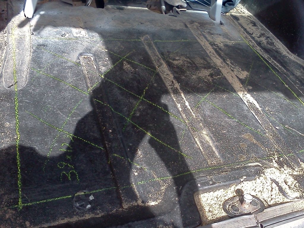

so i think i may start cutting some holes this weekend

Relocating the gas tank

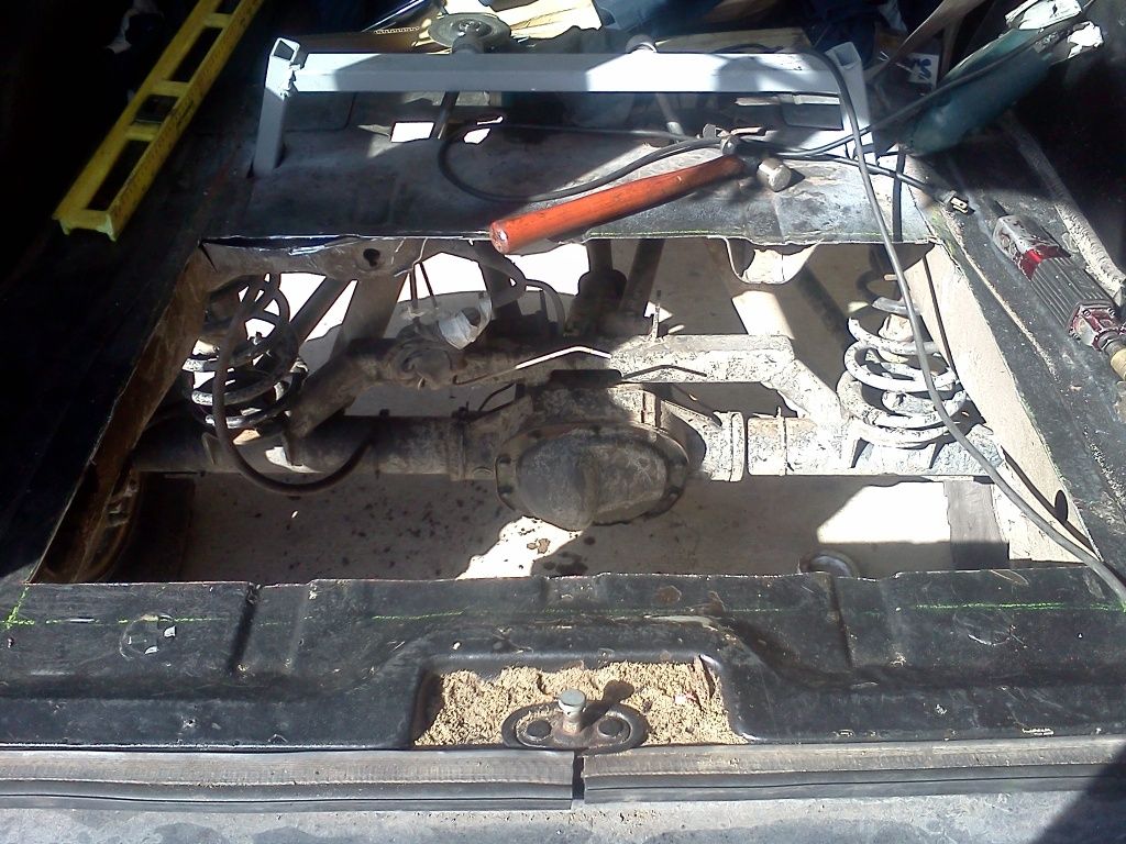

Soooo, since I have the week off, I think I'm going to actually work on the XJ.

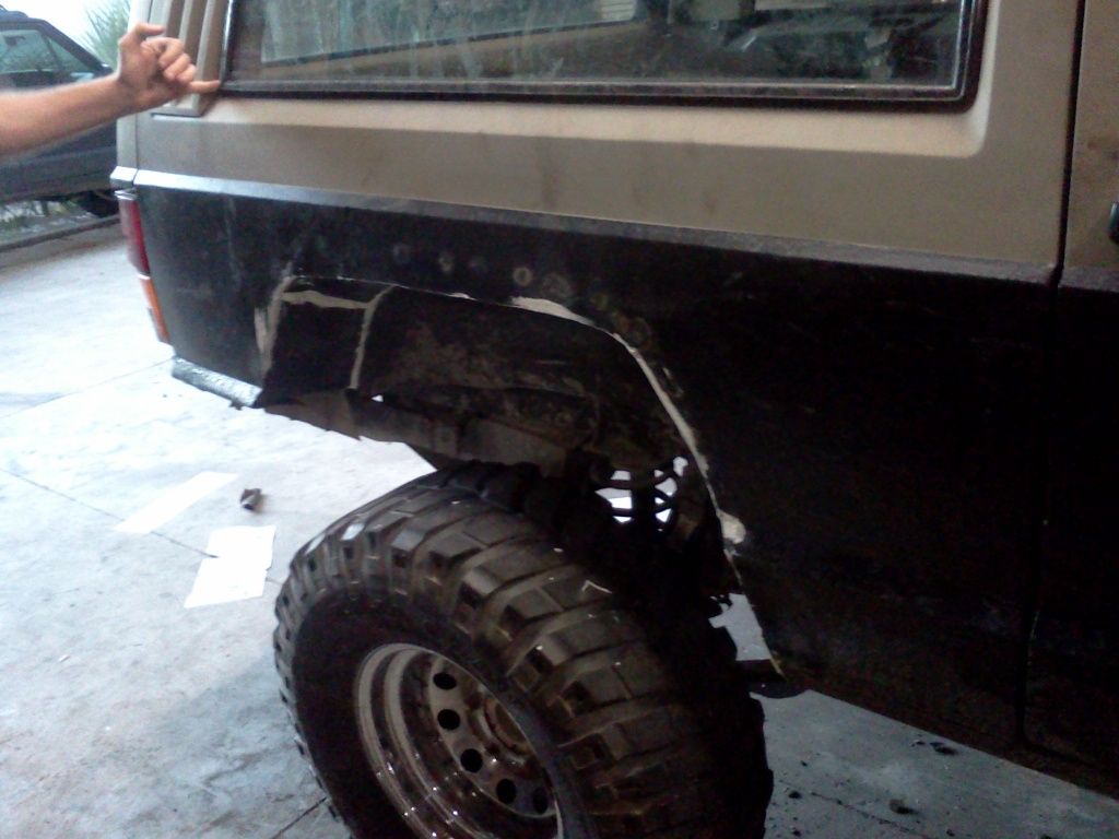

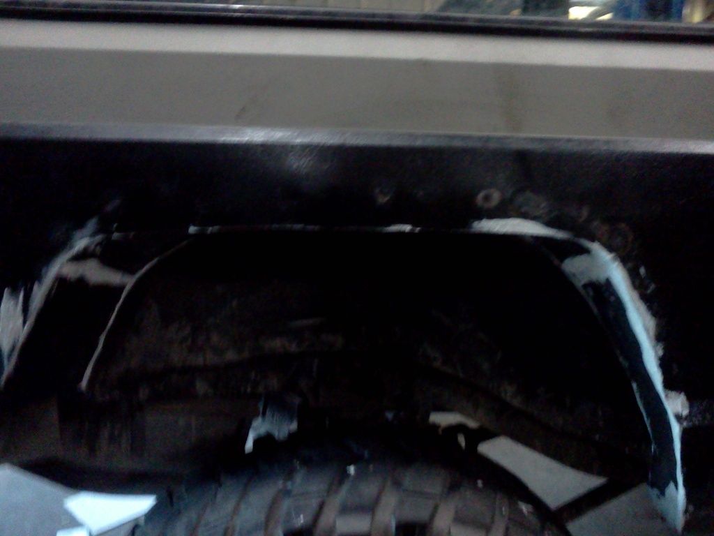

cut out the rear inners yesterday and rebuilt them with thicker metal, so now i have a ton of room for compression in the back

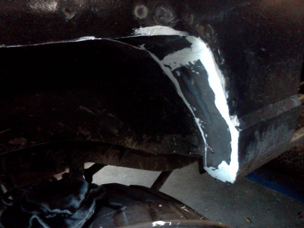

i used polyurethane to seal and smooth out all the joints, so i have to wait for it to cure so i can sand i down and bedline it
edit: dont mind the tiny tires!

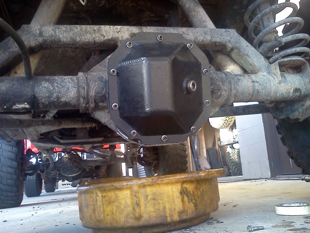

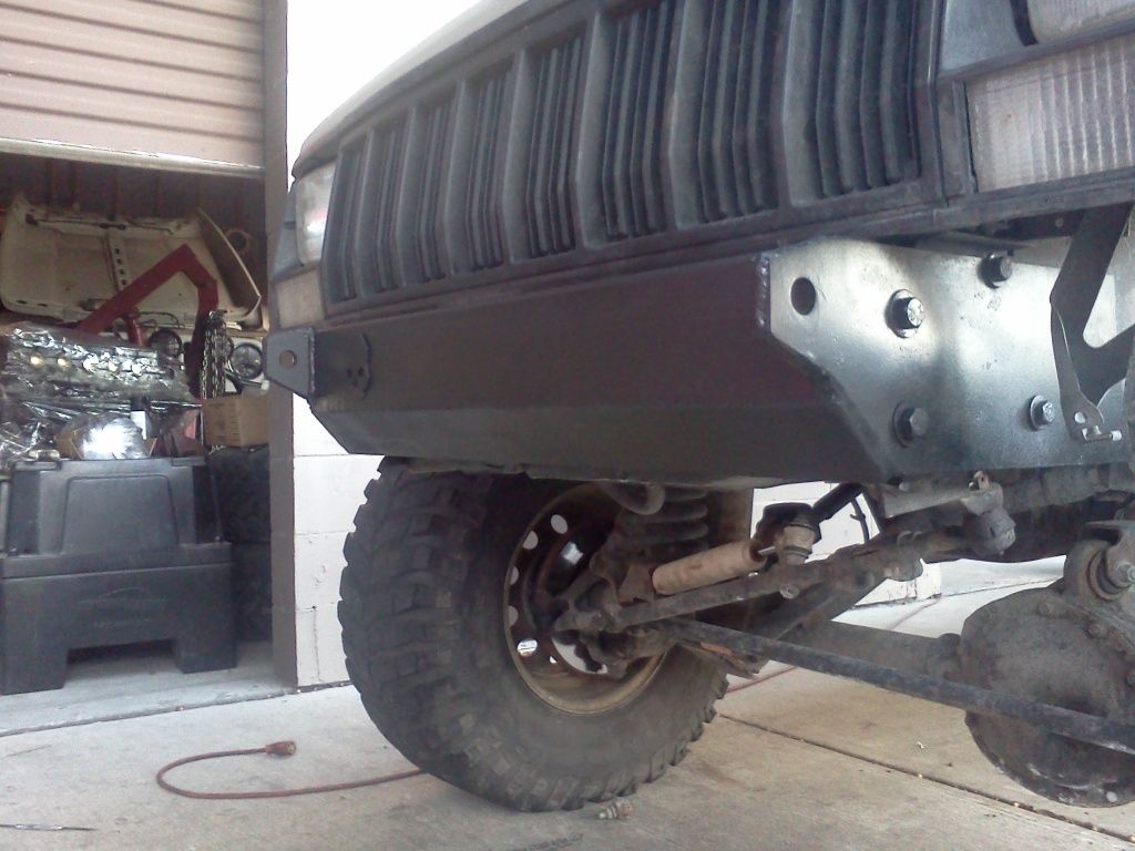

first off added some 1/4" steel to the front bumper and cleaned up the edges some.

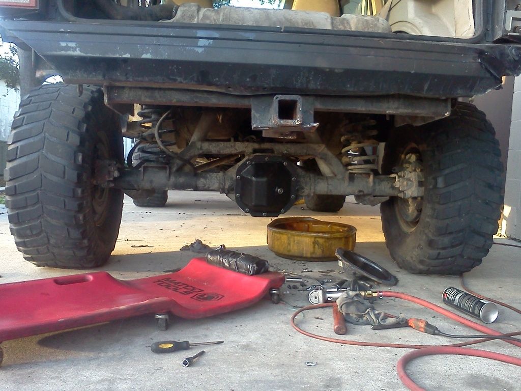

and installed my new non-crushed in diff cover....i love this thing!

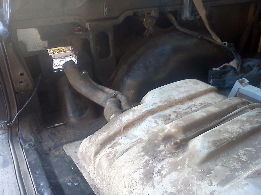

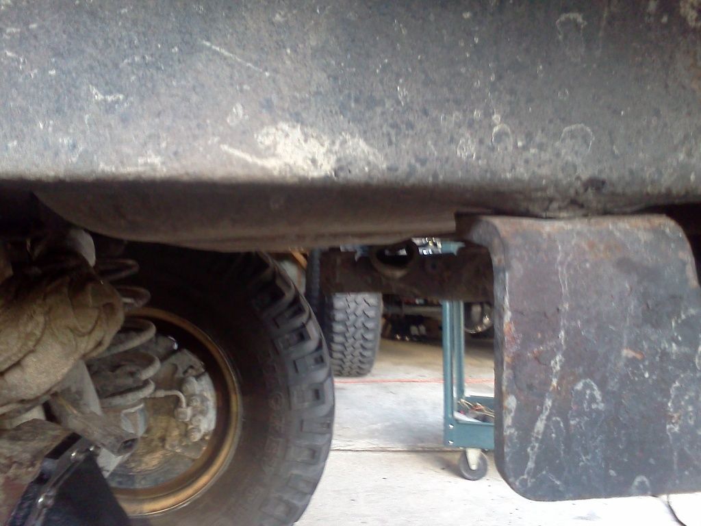

and began my gas tank relocation

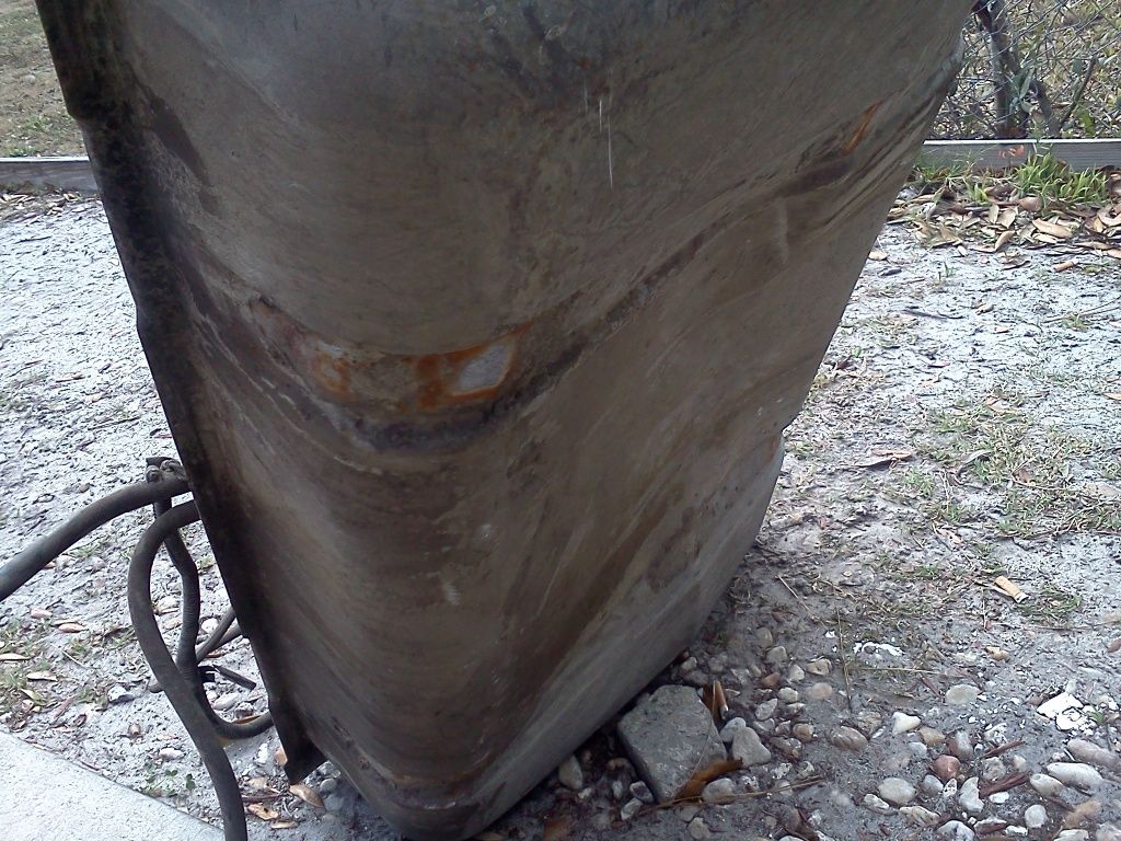

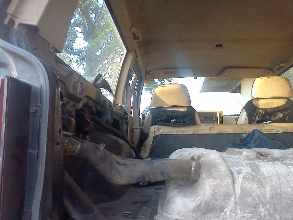

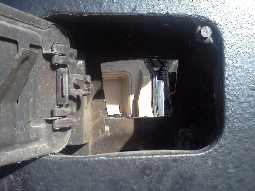

removed my tank. and got a better look at the dents. these dents cause me to not be able to put gas in my tank (i filled the tank with compressed air to pop the dents out before i put the tank back in, no pictures though)
the tank is just temporarily sitting in place right now, ive got a delivery of steel coming tomorrow so i can build the framing for it and the mounts, and after that the thank, filler tubes, and shock tower will all be boxed in with sheet metal.
and i still need to build a rear bumper so i can get rid of this ******* hitch. but it stays for now because that is the only recovery point i have in the rear. but otherwise the clearence i gained is amazing, there is sooo much space under there now
