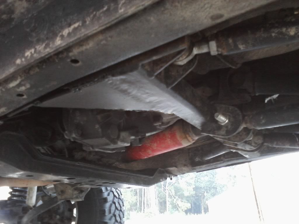

so i got my temporary t-case skid finished. its a mixture of 3/16 and 1/4 plate braced with 1/8 box tube.
it bolts directly to the stock crossmeber, and also bolts to a 3/16 tab i welded onto my rear crossmember.
i think it should do the job for now.

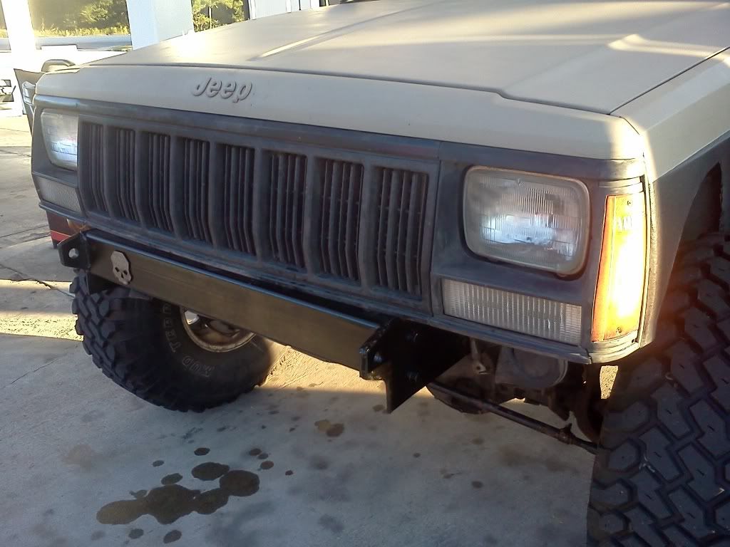

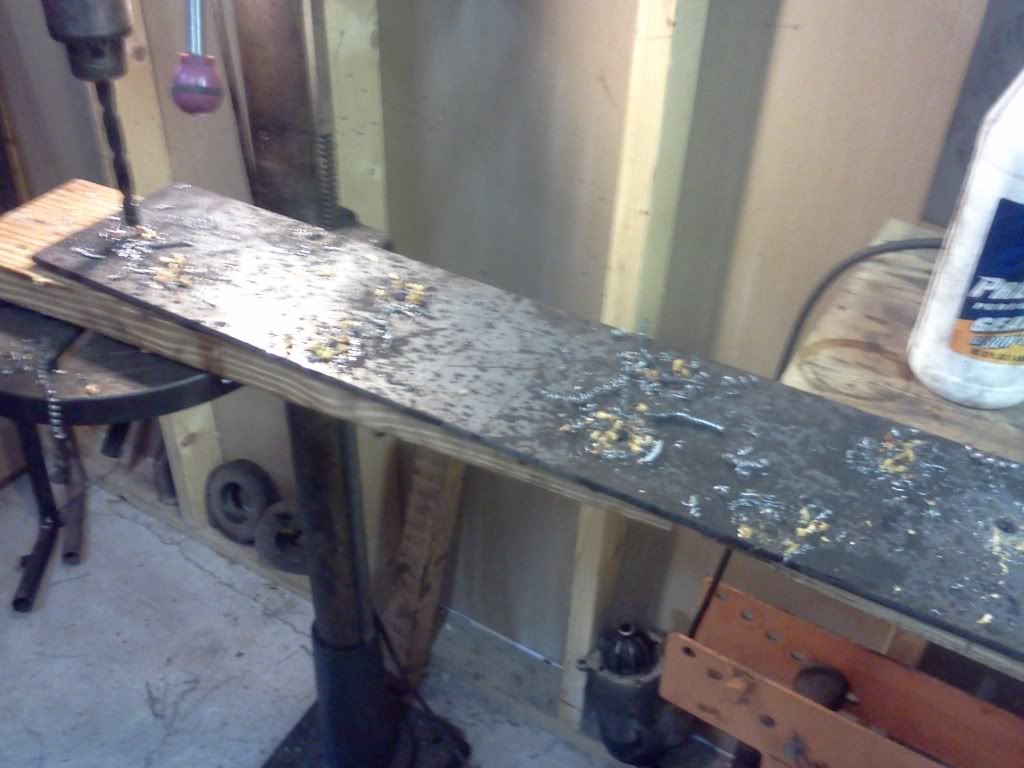

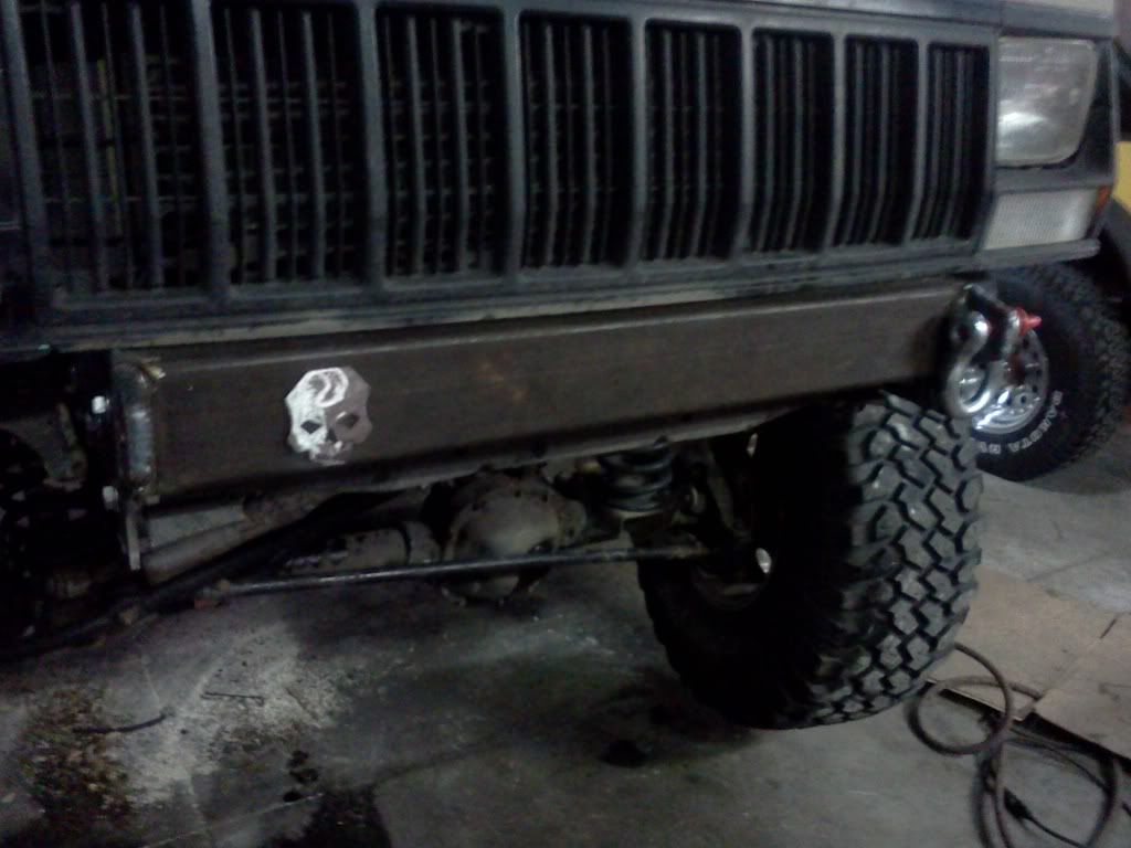

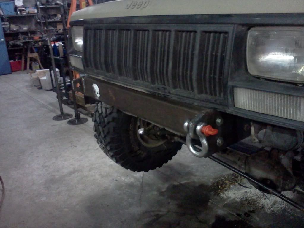

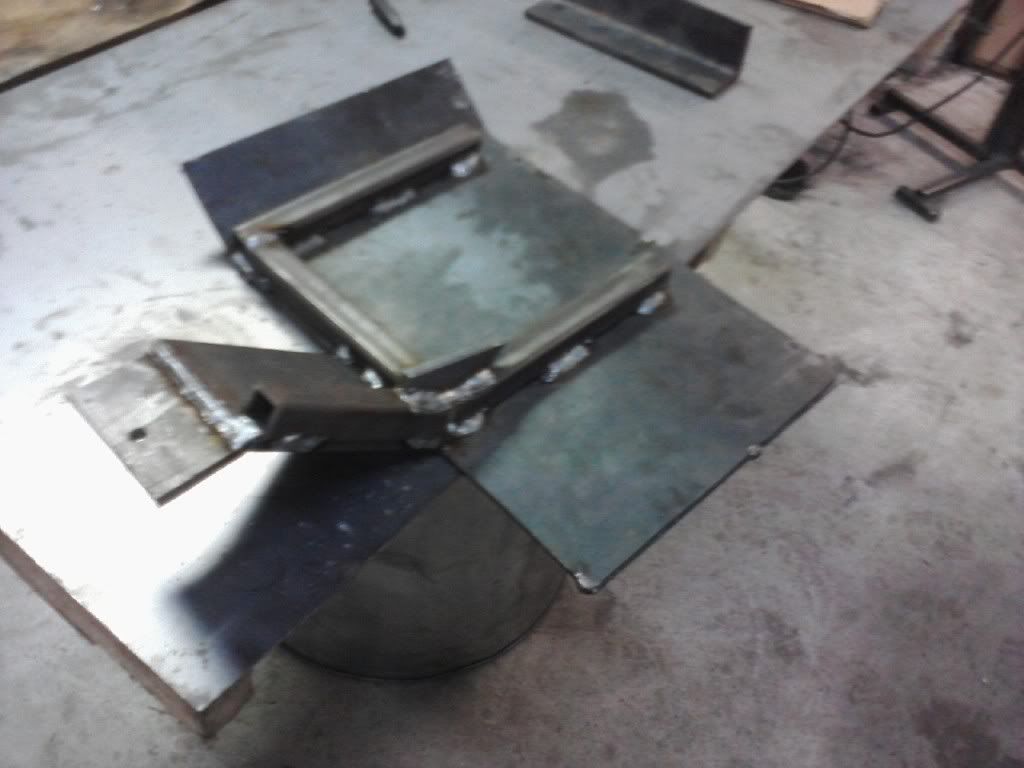

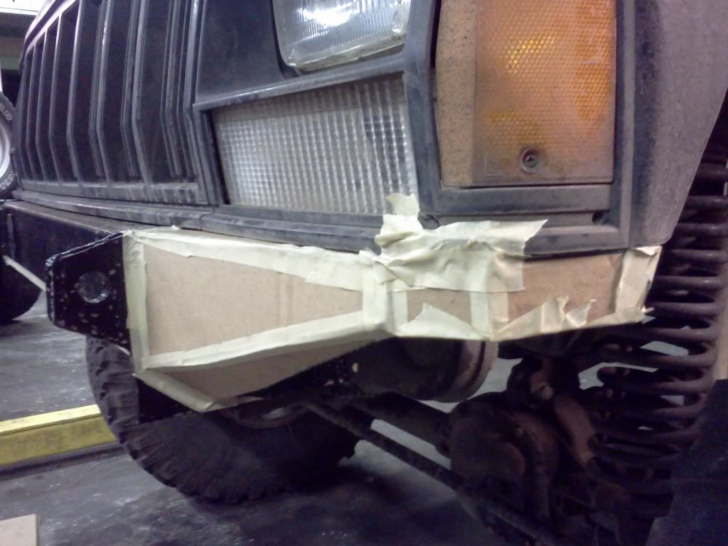

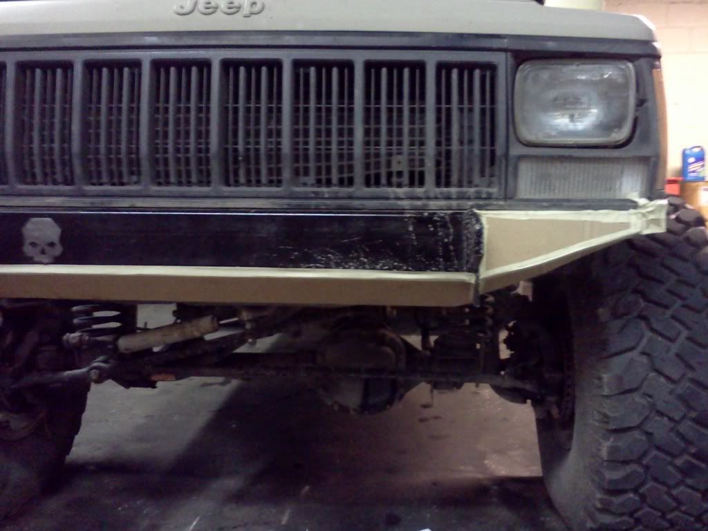

i guess i should post some pics of the front bumper ive been working on.
made from 3/16", 1/4, and 3/8" plate.
the frame mounts are 1/4" and use 5 boltholes for each side, the d ring tabs are connected to the mounts and to the 1/4 box tubing i have running in the center.
its not done yet, i still need to build the outside pieces and cut some pieces off. the last picture will show how it should look. (also adding a 2" flush mount reciever in the center)
only reason i did just the center section is so i could have some recover points for Jeeptoberfest the next day. so i only had a few hours to plan and build something.
heres how i will eventually have it. the red pieces get cut off and the blue is what im adding.
and kind of a cardboard mockup to get the dimensions i need.
