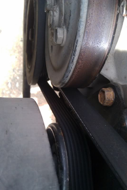

i removed the upper idler pulley and had to trim the timing sight on the timing cover

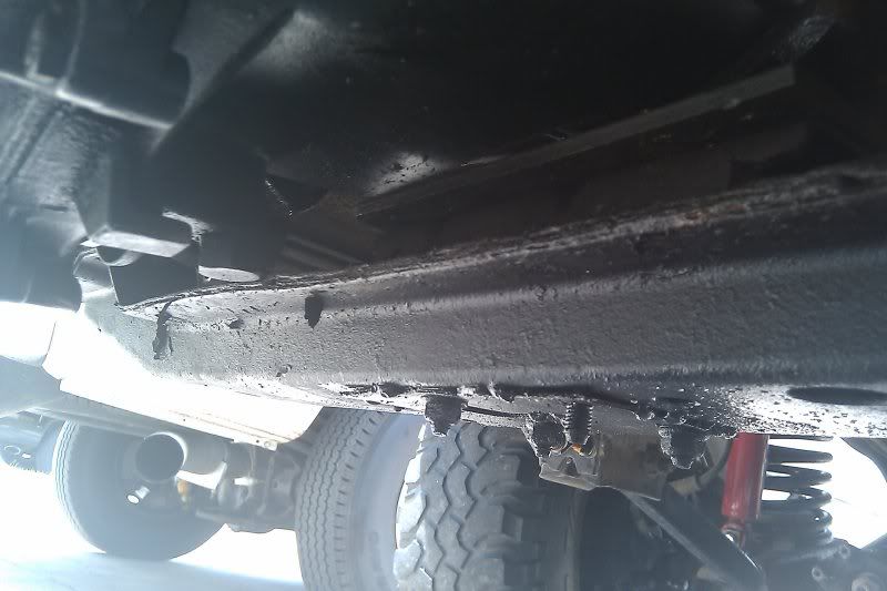

i then removed the TC drop and modified the factory crossmember to have an internal Drop on 1.5's so i wouldnt loose any ground clearance.

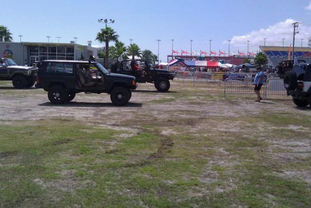

and then it was off to Jeep Beach in Daytona!
