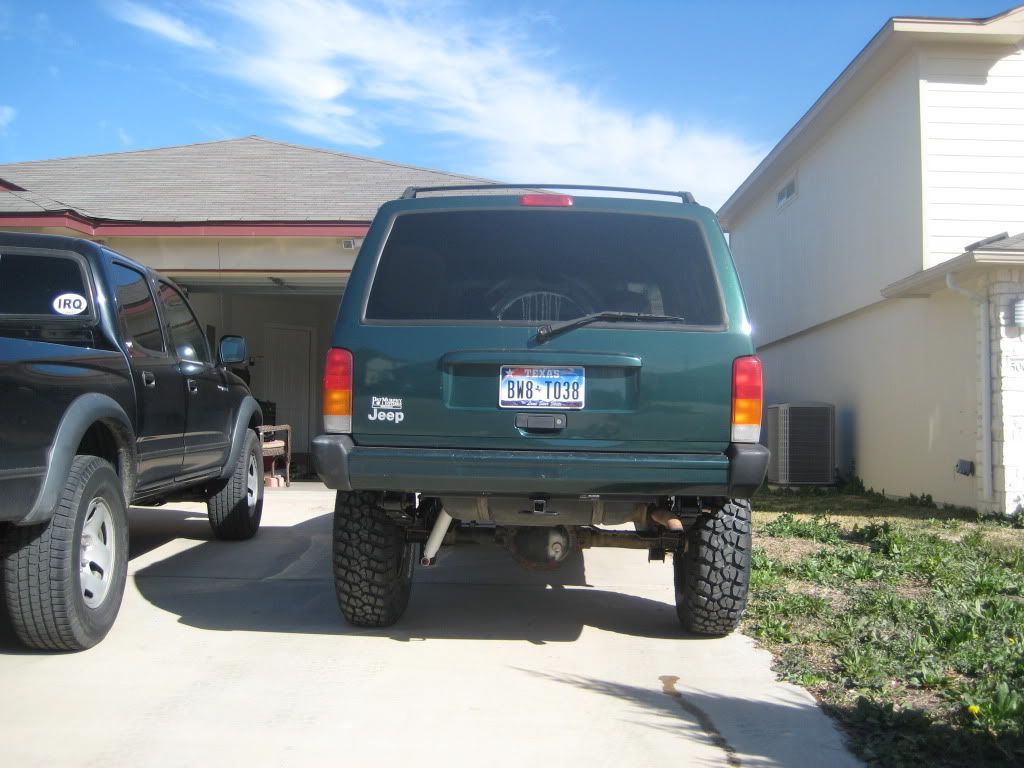

Here she was the day I brought her home.
And with the lift finished!
Don't mind the right shacle bolt... I've got to do a little exhaust modification to get that bolt to fit all the way in...
And here's my old Jeep for the fun of it. 3in lift with 31s.

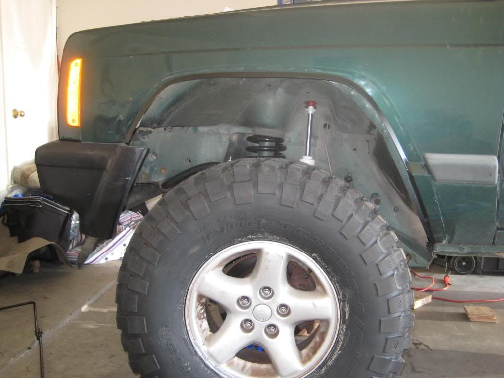

At full lock the tires only rub the JKS Quicker Disconnects just a bit. But I haven't flexed out the suspension yet but it looks like I'll need some more bumpstop and a little trimming. I'm debating on whether or not to go flareless and trim or just trim enough to keep the flares..

I was also a little worried knowing the smaller backspacing when I decided just to mount them on the stock wheels since my funds were low. Surprisingly there is actually about 2-3 inches at full lock from the lca's.

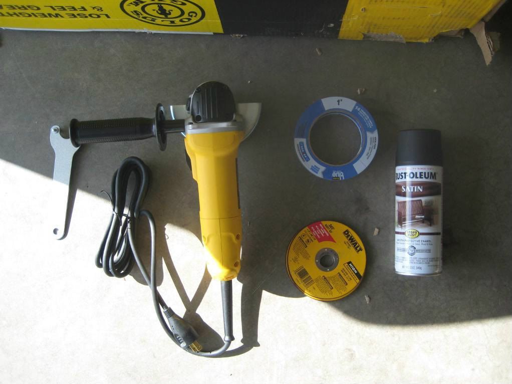

A little update:

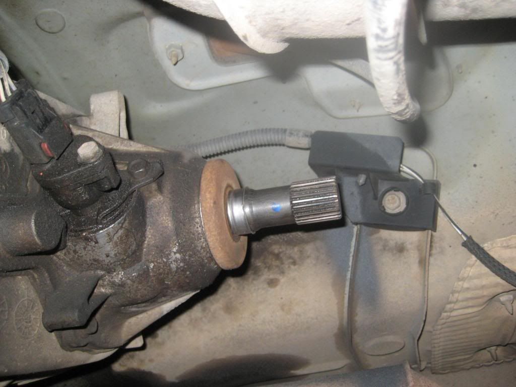

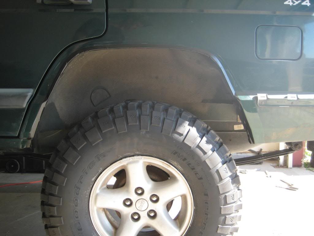

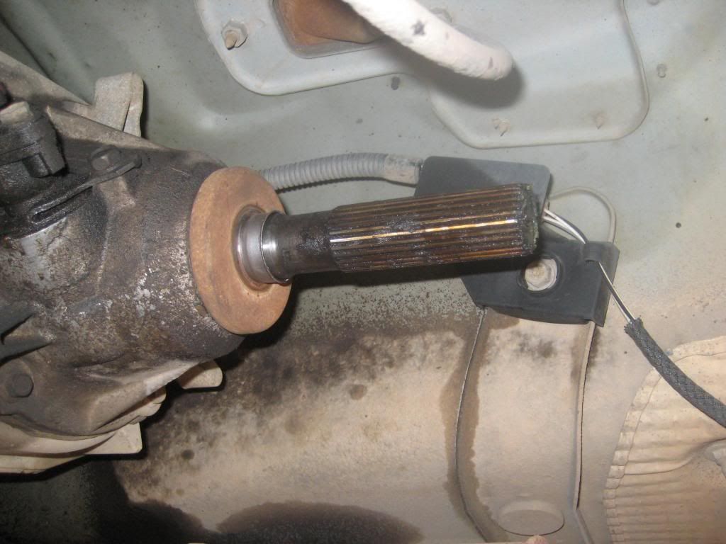

I got the fenders trimmed, sanded the bare metal and sprayed some Rustolem on there for now to keep the rust away for awhile. I also started on my IRO Hack N Tap tonight and I'll finish it up tomorrow or Saturday. Found a clockspring on ebay so that's on the way then I'll be able to get this baby inspected and on the road and trails! Whats a post without pics?
Tools for trimming. (Not shown is the invaluable rubber mallet )
Front clearance before trimming-
Rear before trimming-
Front finished with 3 coats of Rustolem-
Rear finished with 3 coats-
And starting the HnT-
After cutting-
I'm going to drill and tap this weekend and hopefully get her on the road next week! Thanks for reading.

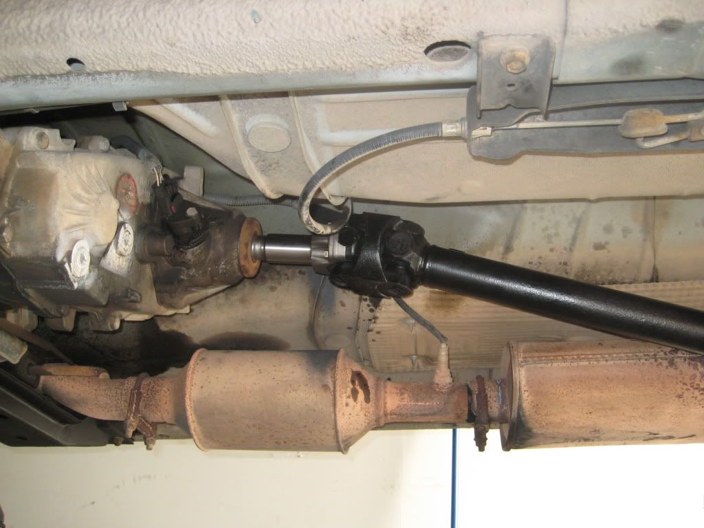

Got the HnT and referbished front driveshaft in and done. Took it for a test drive and wow what a difference! Just waiting on the clockspring to arrive in the next week or so then I'll be able to go get the inspection done.

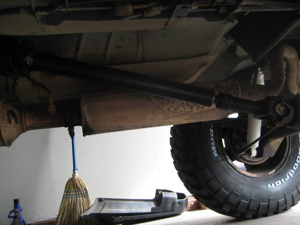

Here's afew pictures of the SYE finished up.
Here's the pinion angle
I think I need to install some shims since the pinion angle isn't quite a straight line, but she rides great now with no vibs and the wife and I can have a conversation without having to yell inside the jeep haha
