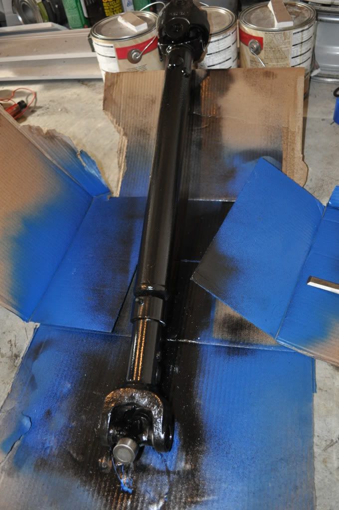

well i rebuilt the drive shaft i will be using for my SYE and i ordered u bolt and degree shims from IRO.

john explain to me how the iro SYE works. it comes with a FR driveshaft to put in the year? and it is 200$, while a real SYE kit is 250$. so whats the difference for 50$
The IRO is a H&T and for 199 you get a front drive shaft but you can get just the yoke for 119.00 and that what i did since i had the front shaft out of my blue xj.
A real SYE does no come with a drive shaft.
For you cause i know you like to save money i would just get the yoke, You may be able to get one cheaper else where and grab a shaft from the junk yard since that one by you has good prices.
It cost me 60 for 3 u joints and the cv ball rebuild.
01ClassicXJ is offline

Thats a nice looking shaft. (Thats what she said)
i guess im still confused.
do you need a new driveshaft if you buy a SYE?
01GreenXJ is offline
post #204 of 245 Old 02-07-2011, 07:08 PM Thread Starter
01ClassicXJ
Location: Warwick/Middletown NY
Posts: 1,286
Yes. In the stock drive train the rear drive shaft slides back and forth on the output splines of the transfer case when lifted this prevents you from getting good drive line angles. When you install a SYE your doing away with that sliding on the splines, If you used a solid shaft you would rip the u joint straps right off the axle. So with the SYE you need to use a drive shaft with an internal slip joint and lucky for us XJ lovers our front drive shaft is perfect for that.

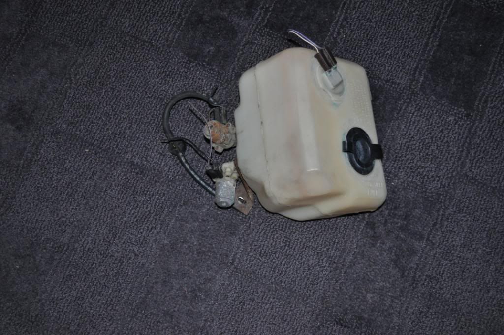

Well court went well only got a fine no points woot woot. After i went to the junk yard and got some goods.
ok thats what i though, so isnt the front driveshaft weaker? nd the one that iro sends you, is ti rebuilt? or just straight used.
I have never heard of anyone breaking a stock shaft so that is something i am not concerned with. On the IRO shaft i have no clue as i already had a drive shaft from my blue cherokee i scrapped, But IRO says that they are refurbished.
