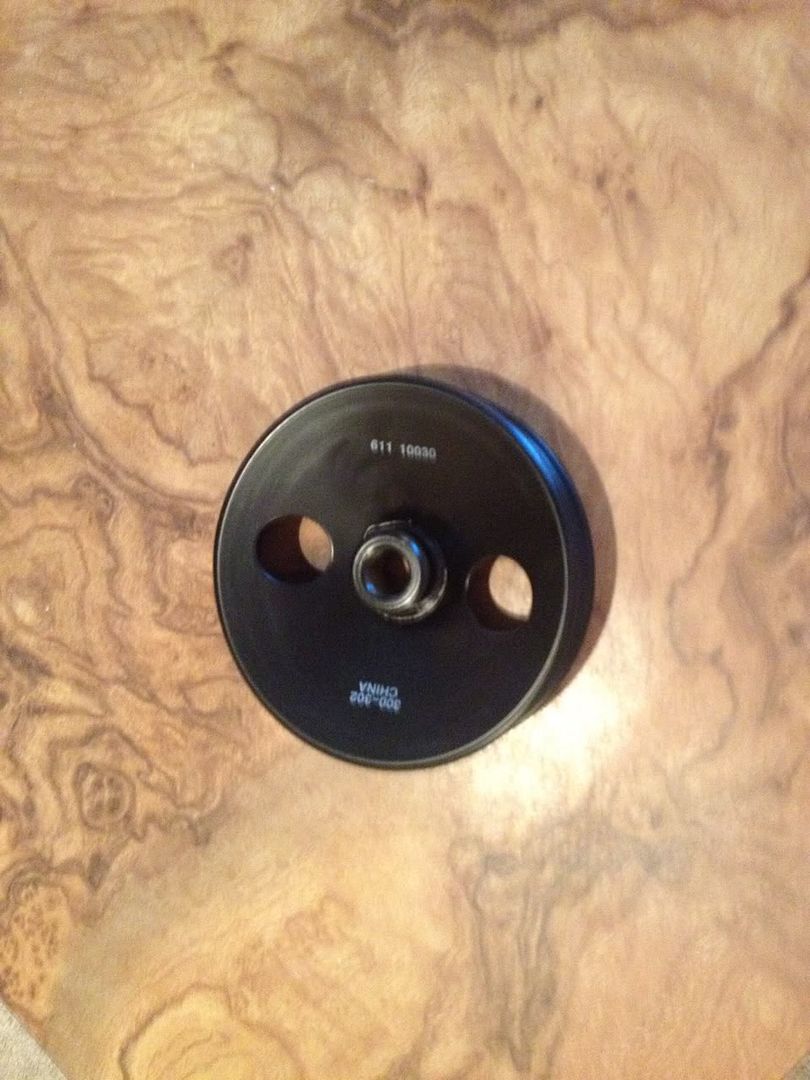

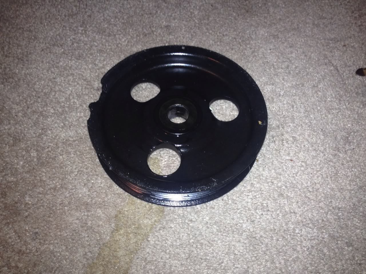

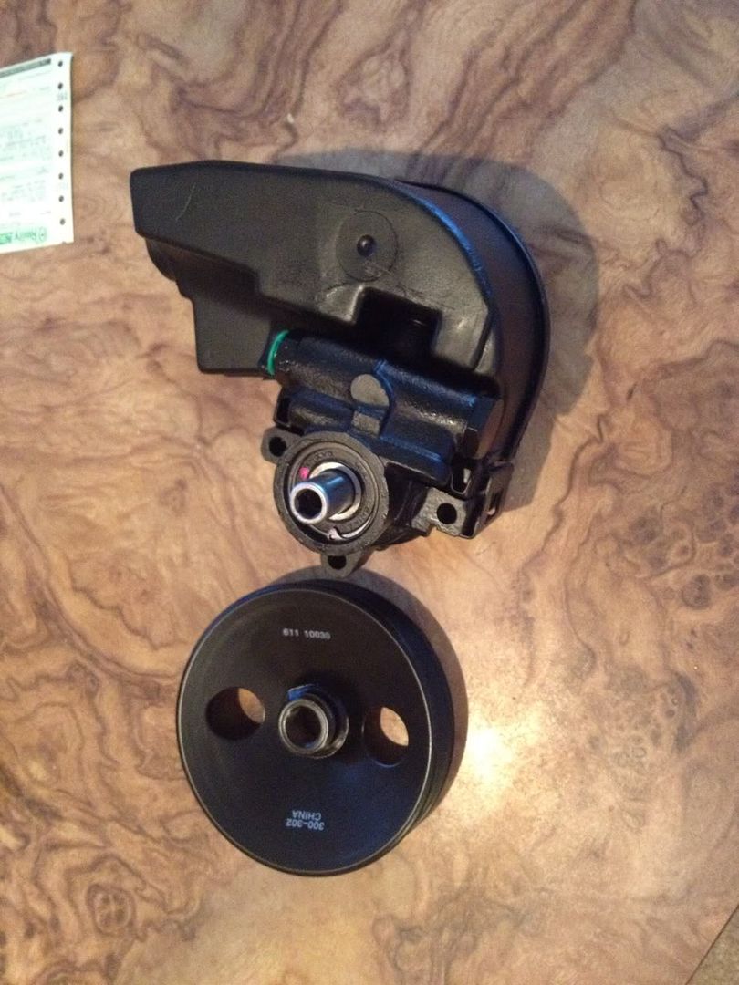

So I just put a regular 4.0 ps pump in.
I did swap out the plastic POS pulley with a metal one.

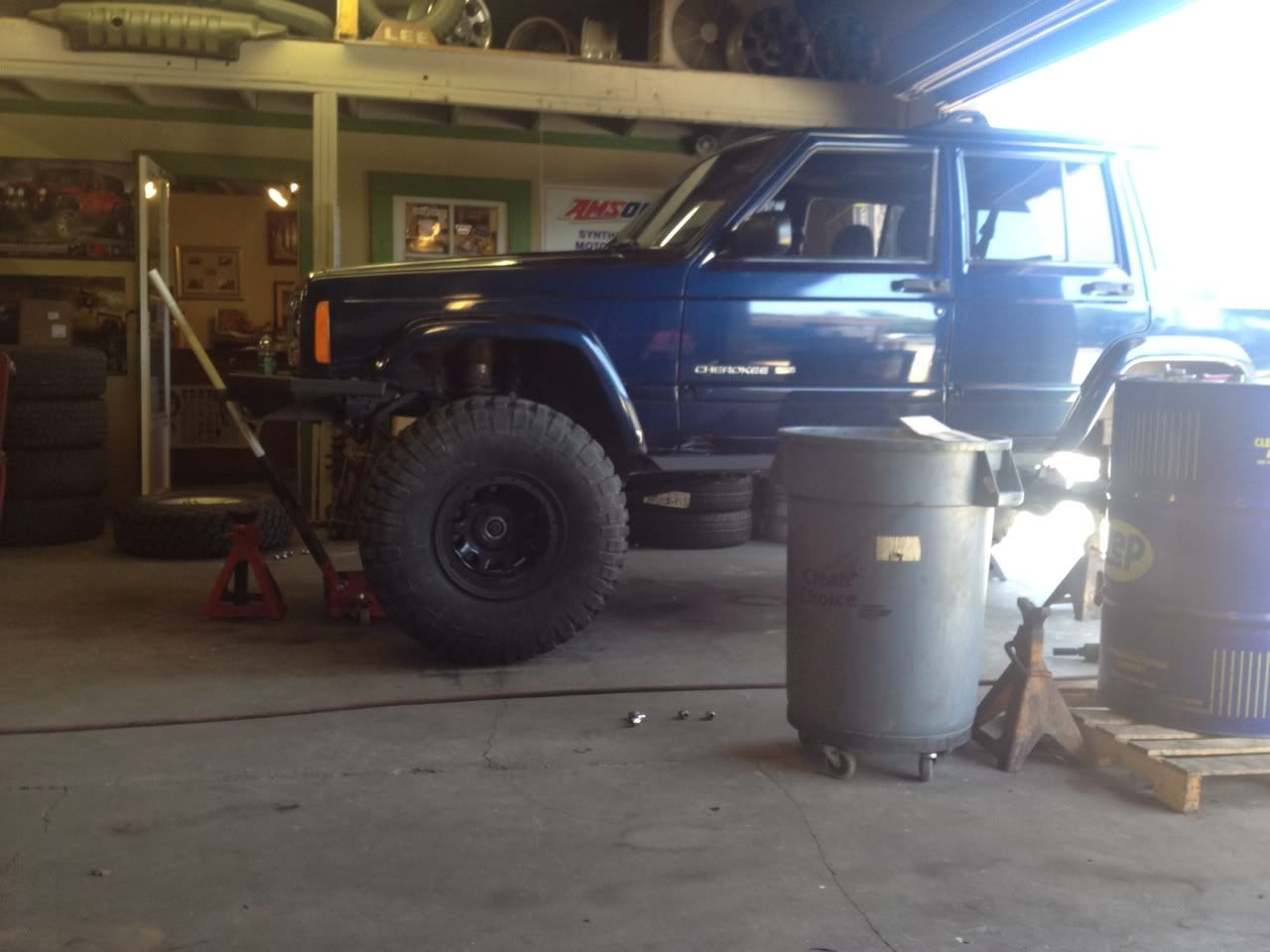

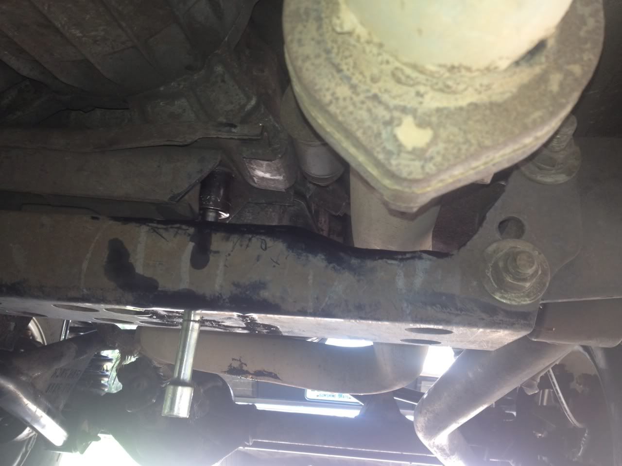

So my transmission mount had come loose but I could not fit a ratchet or box end wrench between the cross member and bolt and I didn't feel like dropping the cross member, so I customized it.

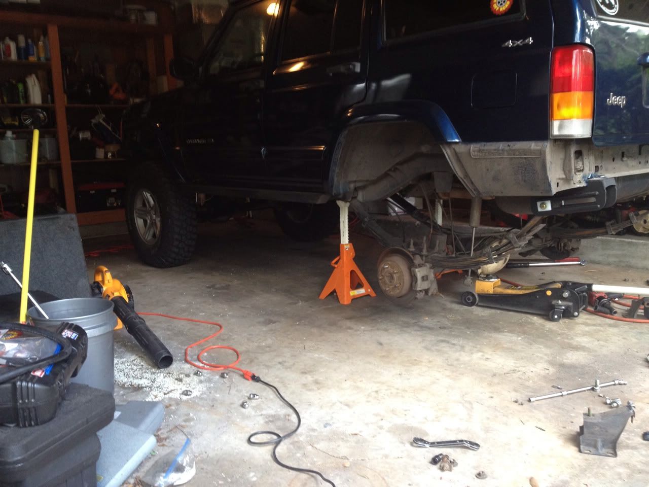

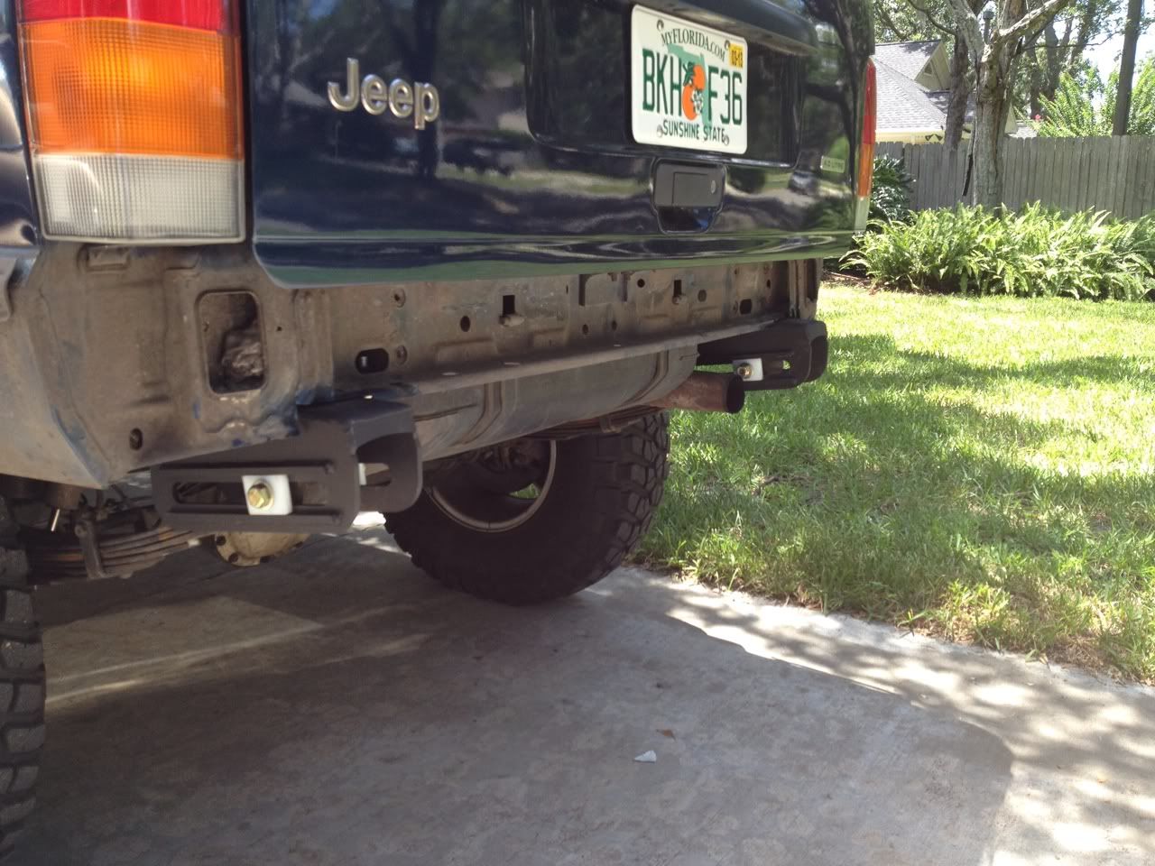

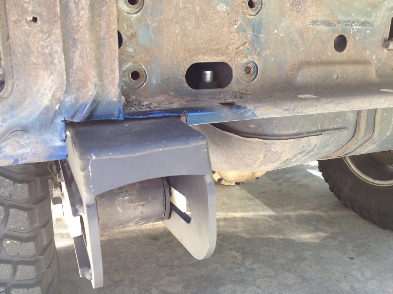

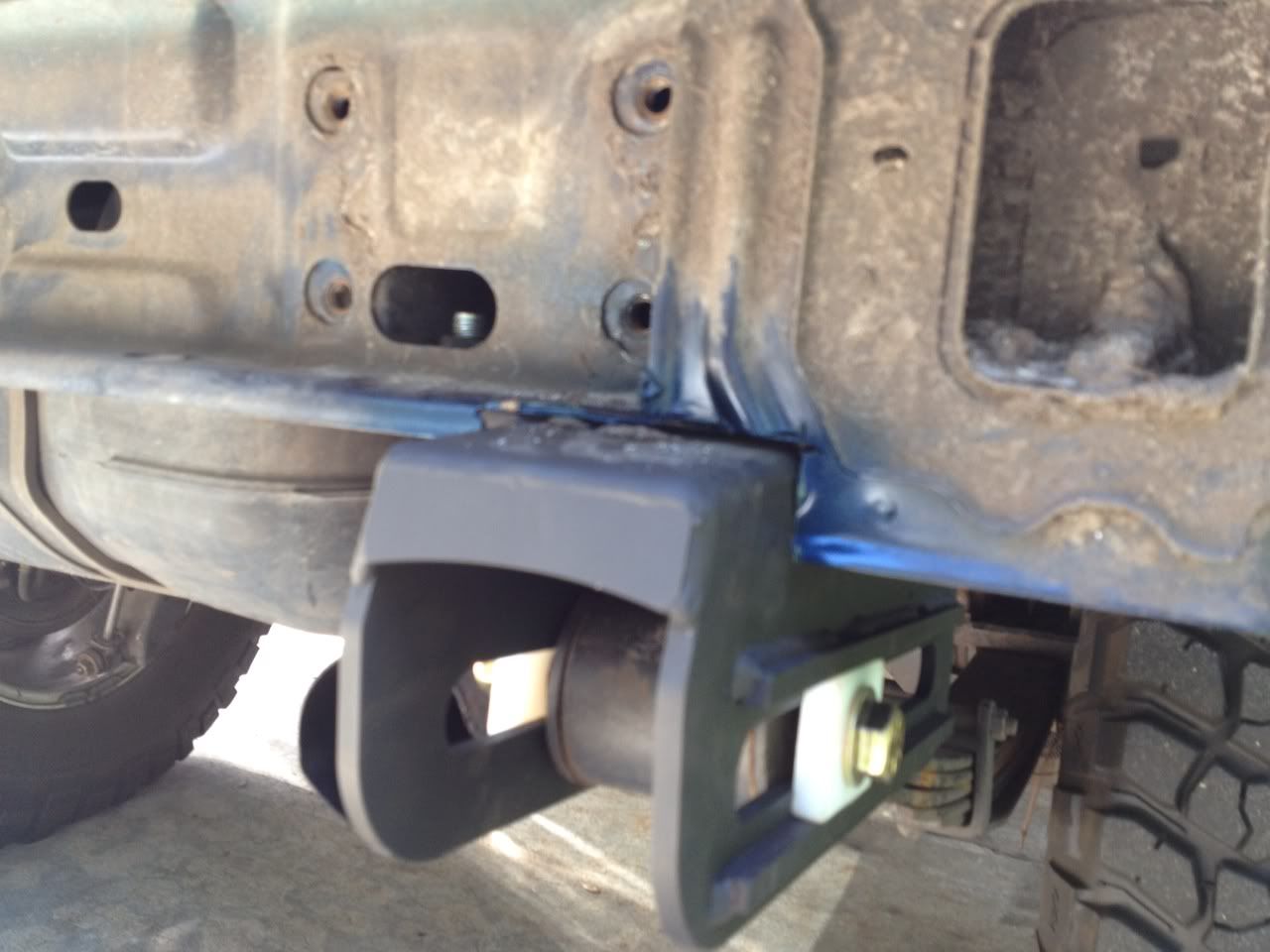

Took today off from work and finally installed the sliders.

post #984 of 1718 Old 07-13-2012, 04:12 PM
VegasGT
1988 MJ Comanche
Location: Leitchfield, KY
Posts: 5,395
That **** just blows my mind. Looks good! Now to test...
- '88 MJ Pioneer -
Build In Progress
- '04 Sierra Z71 Crew Cab -
Daily/TowPig
VegasGT is offline
post #985 of 1718 Old 07-13-2012, 04:54 PM Thread Starter
alexrule123
alexrule123's Avatar
Join Date: Dec 2005
Location: Jacksonville
Posts: 7,339
Well the initial test drive went well. These sliders eat the big bumps up like they are nothing and the stability added feels likes I am almost running a rear sway bar. The down side right now is I feel all the small bumps, kinda like a sports car suspension.

How do they help with flex??? I'm considering them

How do you like those leaf sliders? Ive seen more and more people using them. How are they on the road? from the look of there design they look like they would bottom out a lot going over bumps, do they? did they add any lift? and what about flex? has it increased or decreased from having them instead shackles. Sorry about the explosion questions just curious. Nice looking Jeep btw, Keep up the good work!

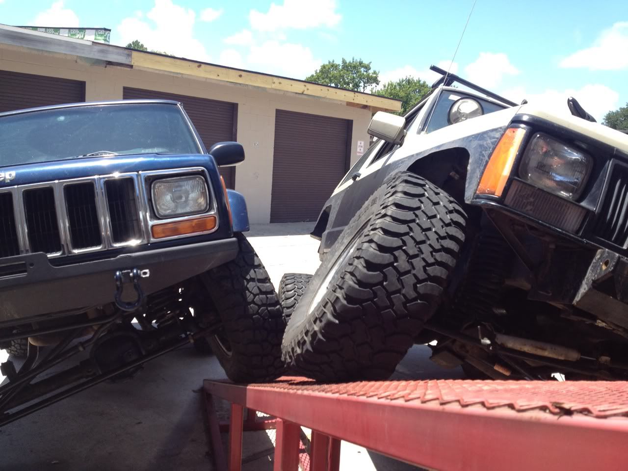

post #988 of 1718 Old 07-14-2012, 05:17 PM Thread Starter
alexrule123
Join Date: Dec 2005
Posts: 7,339
In the garage they flexed awesome but on the ramp I went to about the same spot as before so something is binding up somewhere.. There might be an issue with the front binding up from the track bar and steering.
Around town the ride awesome, exactly like shackle relocation brackets but without the extra lift. They do not bottom out going over bumps and in fact eat up the big bumps like they aren't even there. If they add any lift it is very minimal (which is what I want since I only want 5.5" of lift). In theory there is more flex from the crappy shackle angle I had before but on the ramp I can't see it. Hey no problem, I love answering questions

post #989 of 1718 Old 07-14-2012, 05:19 PM Thread Starter
alexrule123
Join Date: Dec 2005
Posts: 7,339

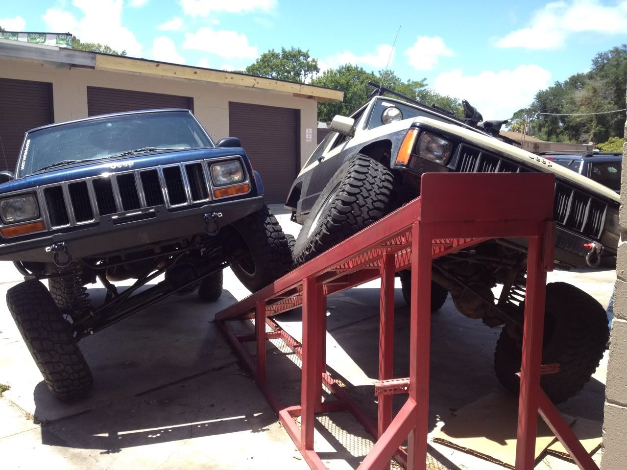

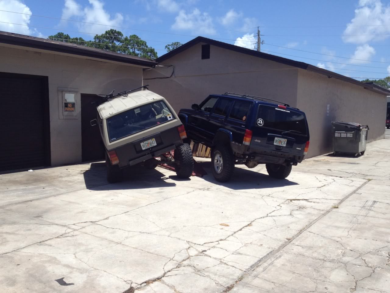

Going on the ramp today I made it maybe 1-2" further but that was it so I wasn't too happy about that.. Ramp pictures:
