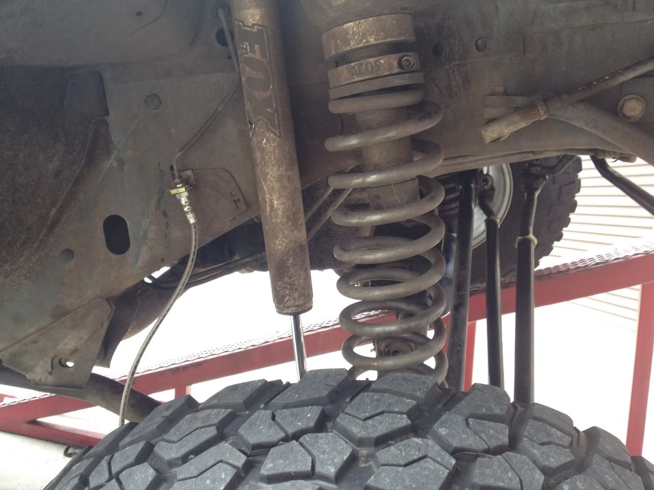

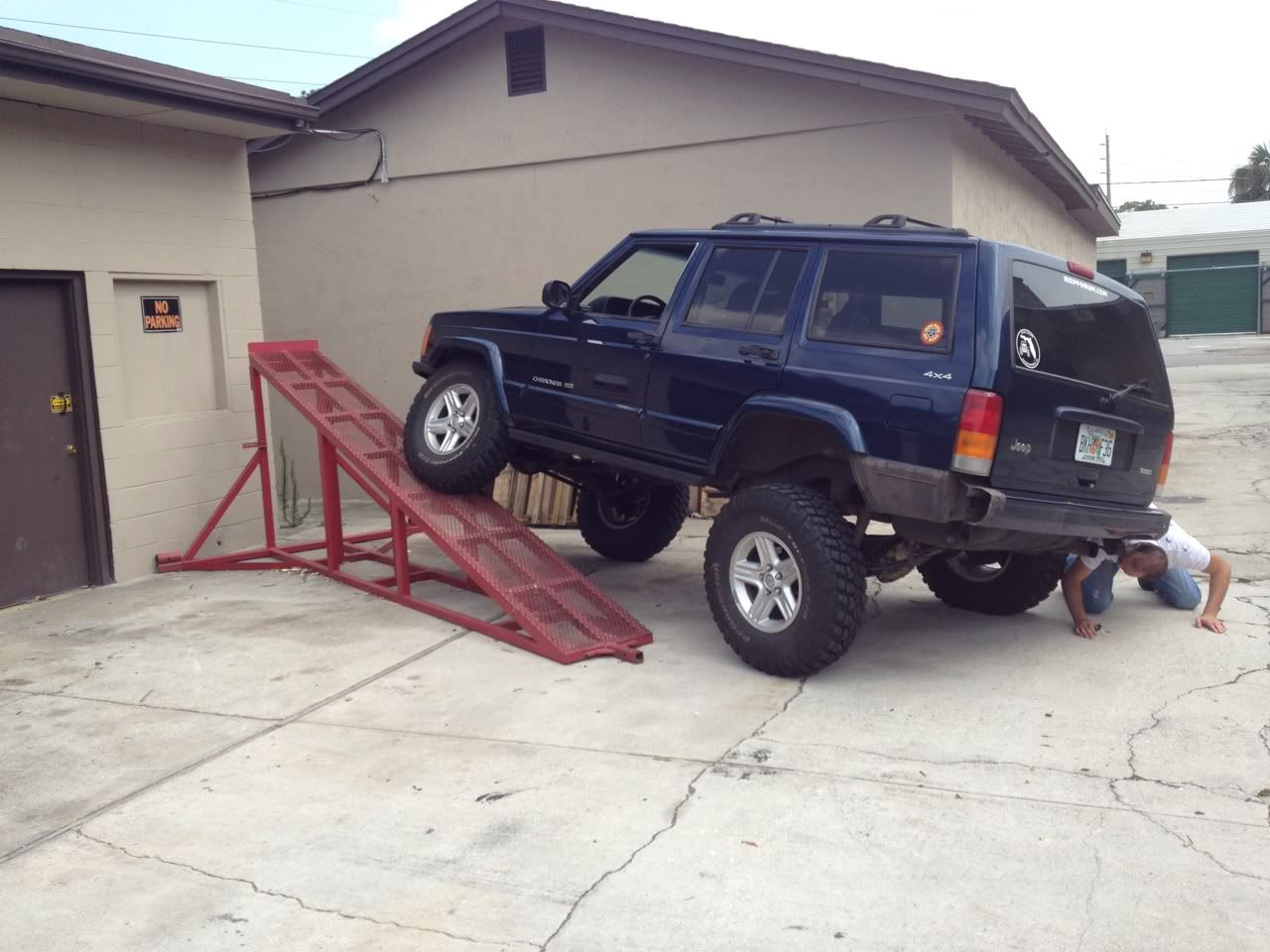

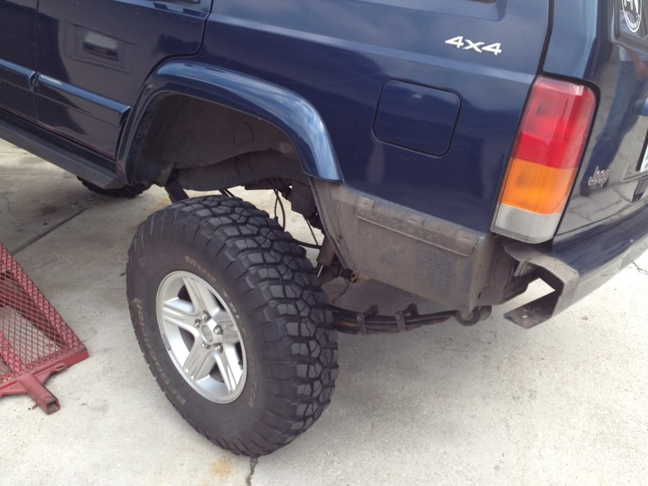

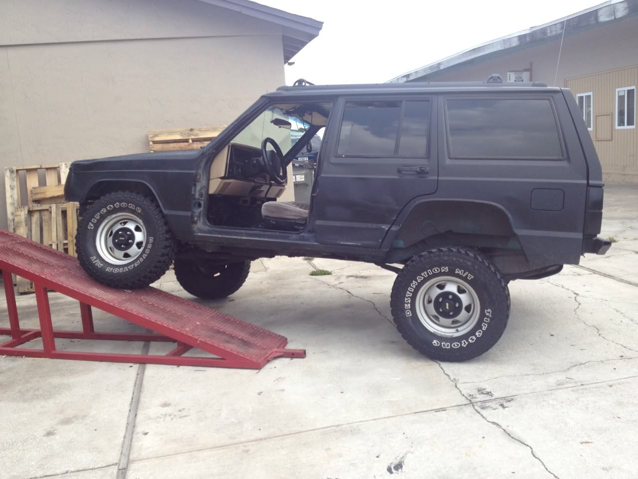

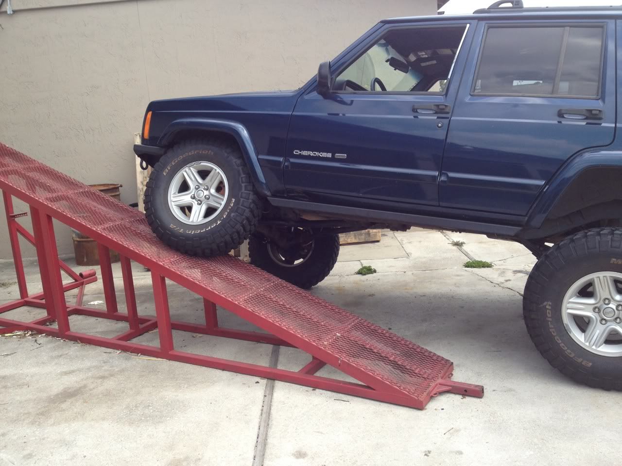

Some RTI ramp action today.
Brake lines are long enough
The rear is really holding me back.

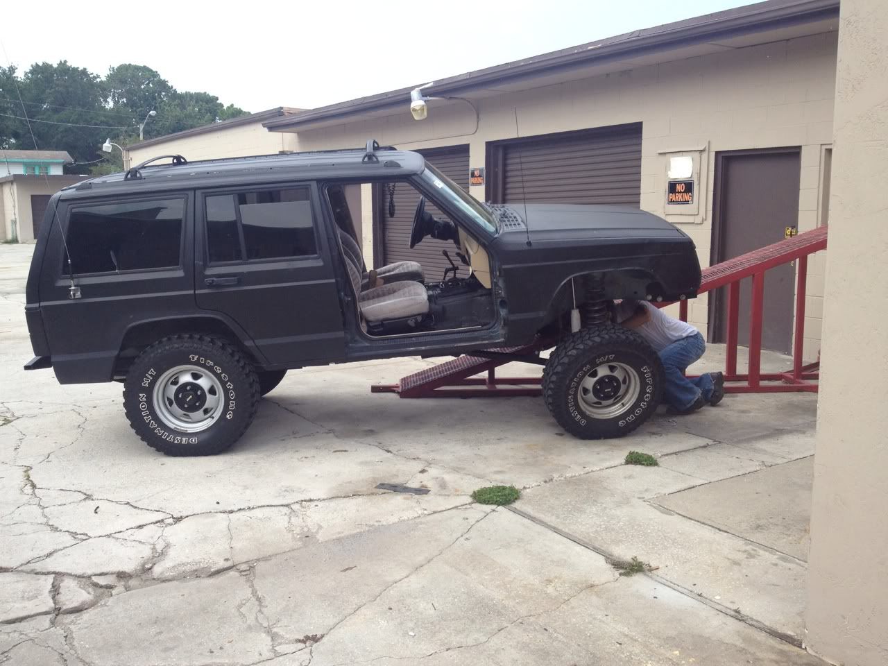

Kevin tried his XJ too

mu fuggus just showing up at my shop without me even being there?? lol
kevin needs to do something about those short *** shocks and brake lines...
and you need those LII slider boxes in!!
LOL Melvin was there and I was dropping Kevin off to pick up his Jeep.
He is going to buy my old brake lines, shackles, relocation brackets, and steering and some other things. I need to clean the garage out...

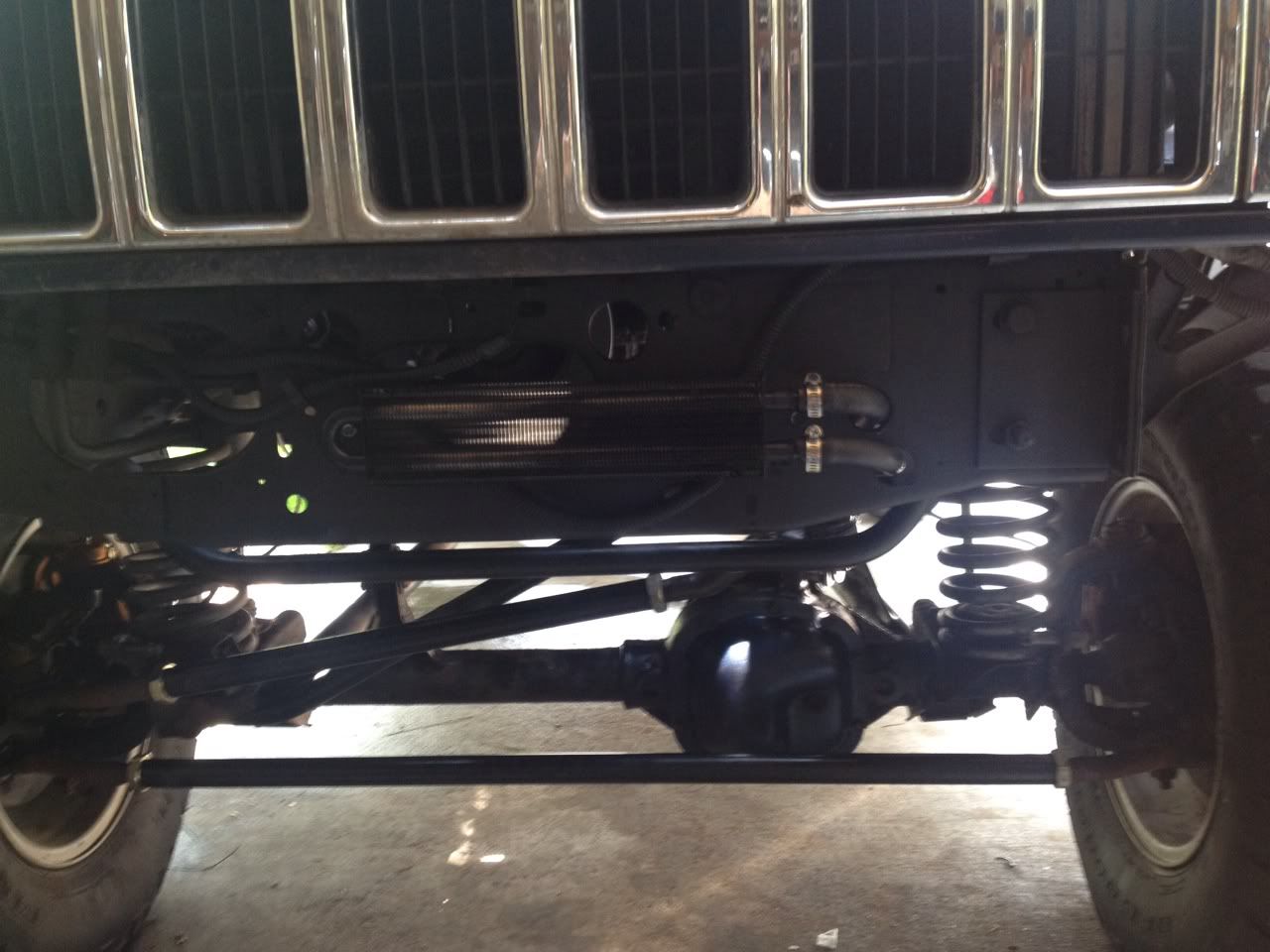

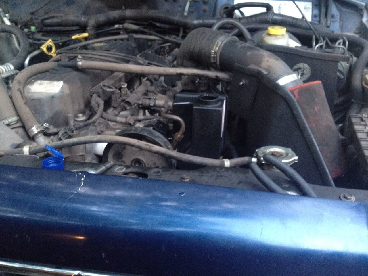

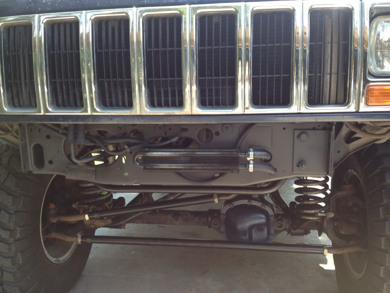

Installed my power steering cooler tonight. It gets really hot just turning the wheels back and forth in the driveway.

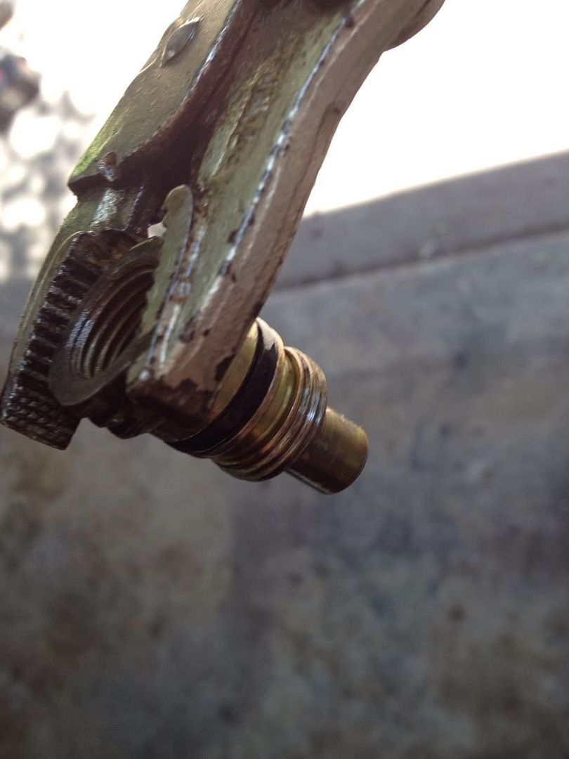

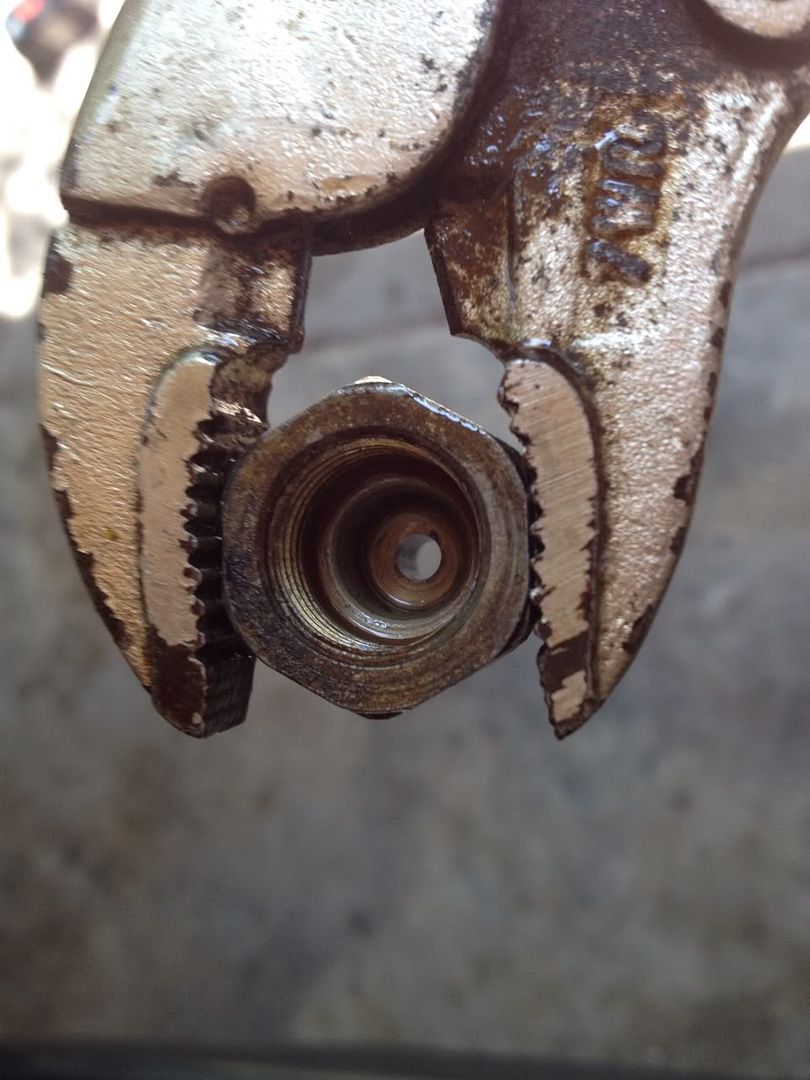

In an attempt to get a little more flow at idle I drilled the hose fitting out to 5/32", it seems to steer a lot easier at idle now.
And a better picture of cooler install.

I drilled the bottom hole a little larger so that the cooler hose won't be so tight in it.

Originally Posted by alexrule123 View Post
In an attempt to get a little more flow at idle I drilled the hose fitting out to 5/32"[/IMG]
Since you got some improvement, I may try this!
I would not go anymore than 5/32" because it is almost too sensitive at highway speed.
Also I got the idea from this site: http://westtexasoffroad.homestead.co...rsteering.html
