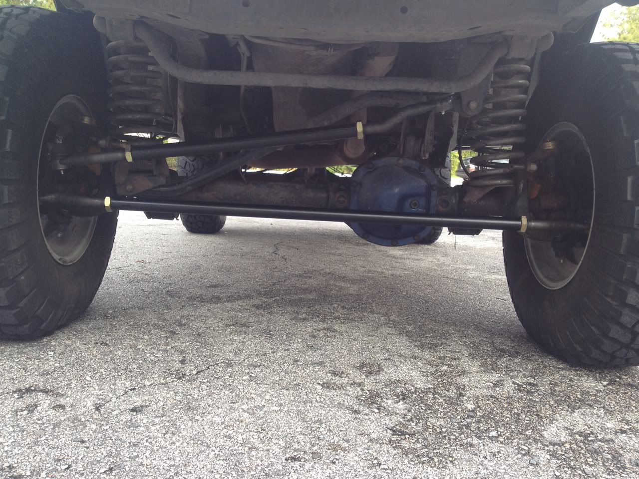

Installed links today, need to relocate track bar still. Also I am using a ZJ pitman arm.

Location: Miami

Looking good! What tie rod upgrade did you run? Do you have a complete parts list? Why did you need new unit bearings, were yours bad? I thought the 00-01 XJ's used the newer unit bearings.
Thanks!
I used the JKS rods for the drag link and tie rod. I had to get new hub bearings because I swapped the old style hubs over from my totaled xj since they were brand new at the time.
Parts:
'01 wheel hubs
WJ rotors and Calipers
Ceramic brake pads
WJ balljoints
JKS hub spacers
WJ knuckles
Moog WJ tie rod ends
JKS jam nuts for the steering links
JKS steering links
ZJ pitman arm
5/8" drill bit to drill the WJ rotors to 5x4.5 bolt pattern
