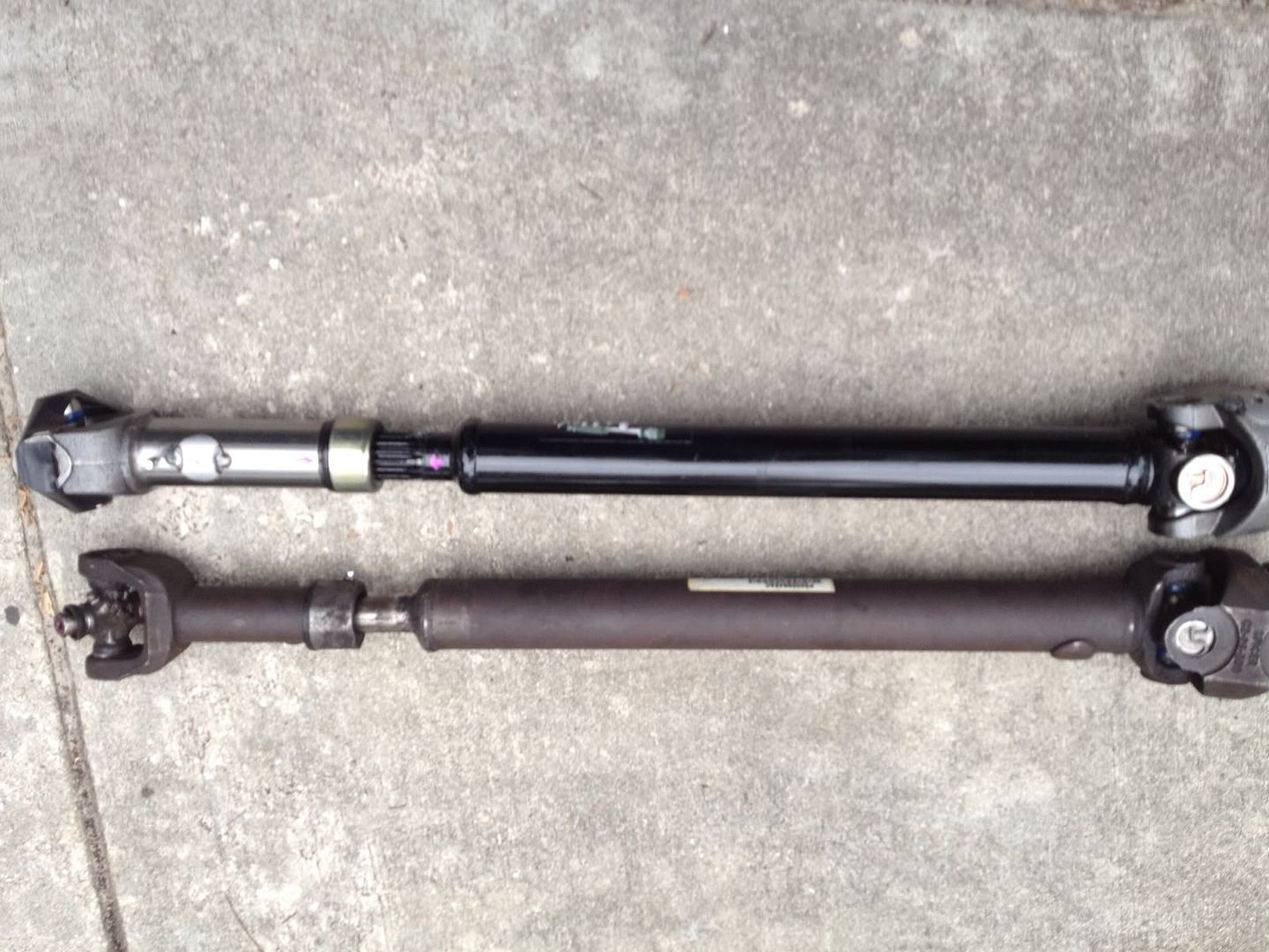

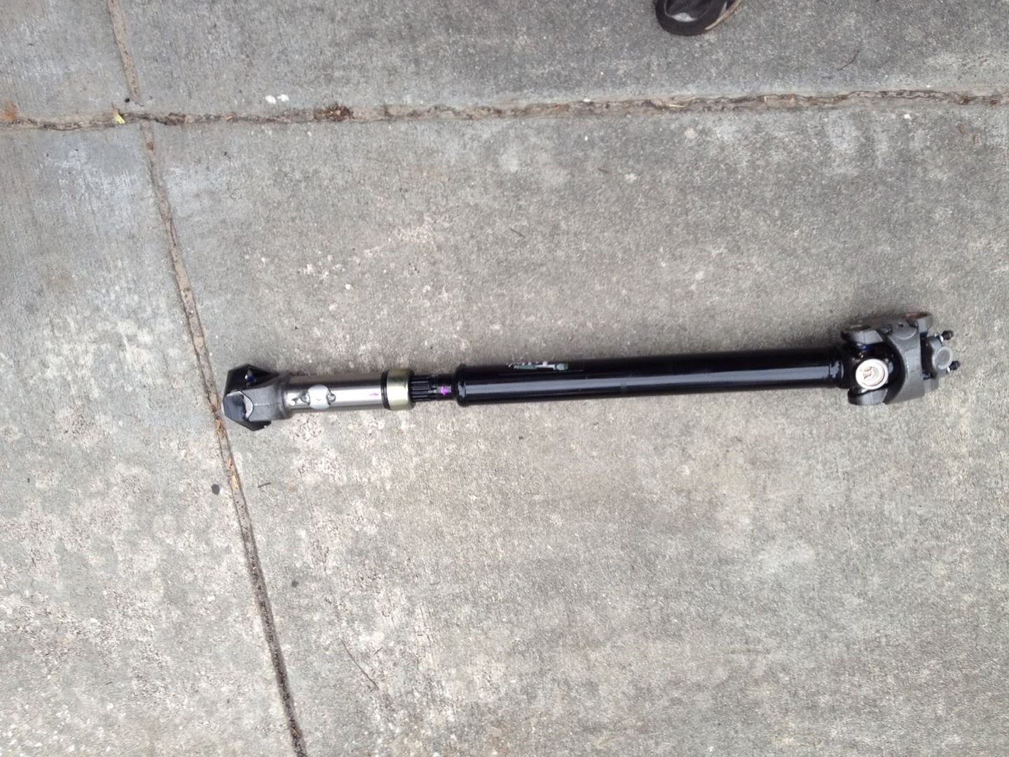

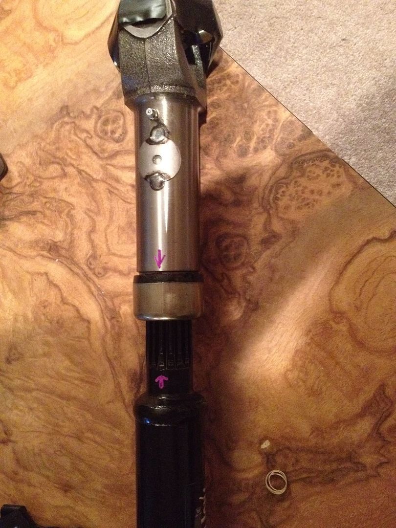

Got my new drive shaft from Tatton's Driveline in today. This thing is a beast and has all spicer u-joints in it. Took it up to 70mph and its smooth as glass...well if glass had km2s.

Nice shaft....
Is this the ebay one or did you order it straight from them?

I called them directly and talked to Curtis, he's really cool and took the time to make sure I was getting the correct shaft and that I measured correctly. I will be ordering my front drive shaft from him for sure.

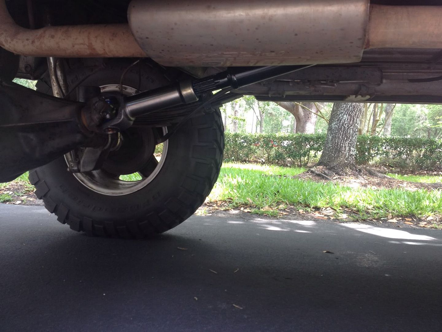

It cost $235 shipped, there is a shop locally that charges over $300 for the same thing.
Oh and another picture of it installed.

Shaft is a little short, could have been another inch longer IMO.. (ya ya.. that's what she said..)

Actually it has 7" of spline engagement and if you look closely there is only about 1" of exposed spline. I thought the same thing at first but look at how the splines tapper as they go towards the front.
Plus you need room for some compression

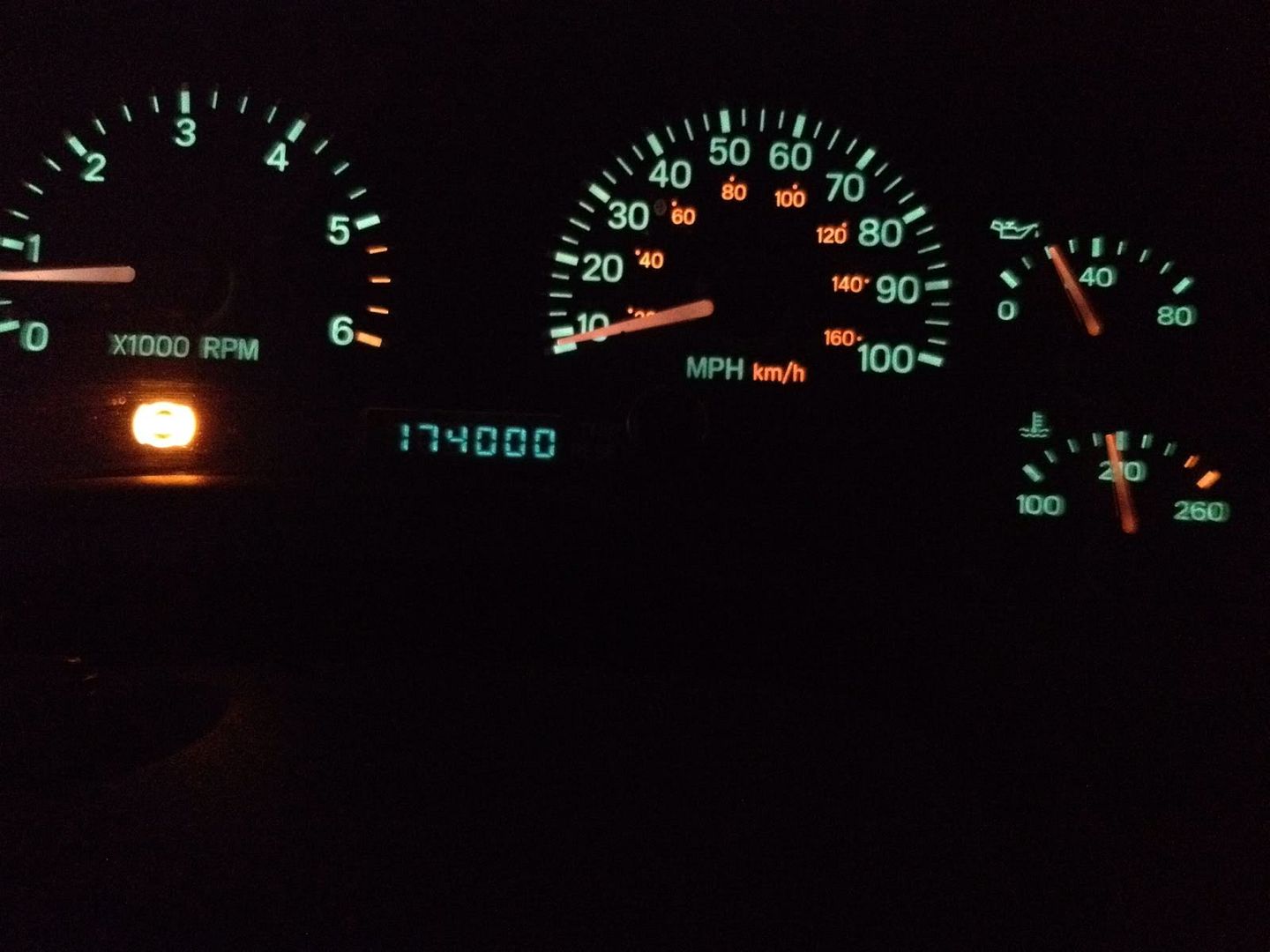

Hit 174,000 miles today.
