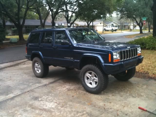

Went to osceola national forest over the weekend and went on some of the trails there. It was a lot of fun, more pictures later on when they are emailed to me.

^nice photo

Thanks, I am waiting on an even better one of me going through that mud to be emailed to me.

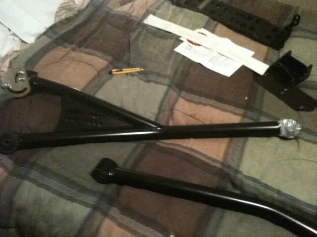

Well I was planning on installing the long arms this weekend, along with the new 5.5" coils but there is some hardware missing from the kit, bolts and such. IRO is going to send the missing pieces but I don't know how long they will take to arrive

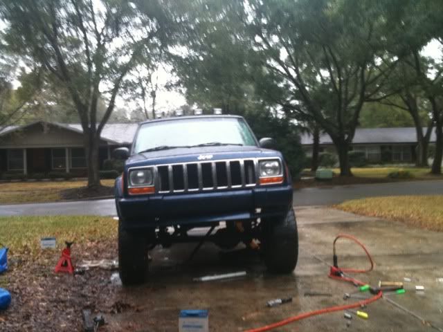

So I installed the IRO crossmember today but the front driveshft is actually hitting the cross member so I am at a loss I tried shifted the xmember around but that didn't fix it since there is very little room for play.

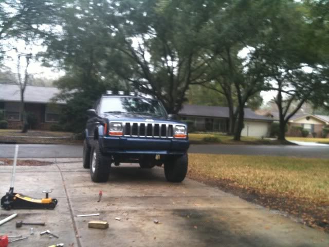

Finally got the front end done...took forever.
With the jack on the driver side frame rail

Lookin great, but did you not get an SYE/DS?

That's part of why i am still @ 4" in the back But with a 1" tcase drop and 4* shim and 1.5" shackle it should be drivable.
edit: I was running 4" of lift with no tcase drop, just the shims and had almost no vibes at highway speed.
