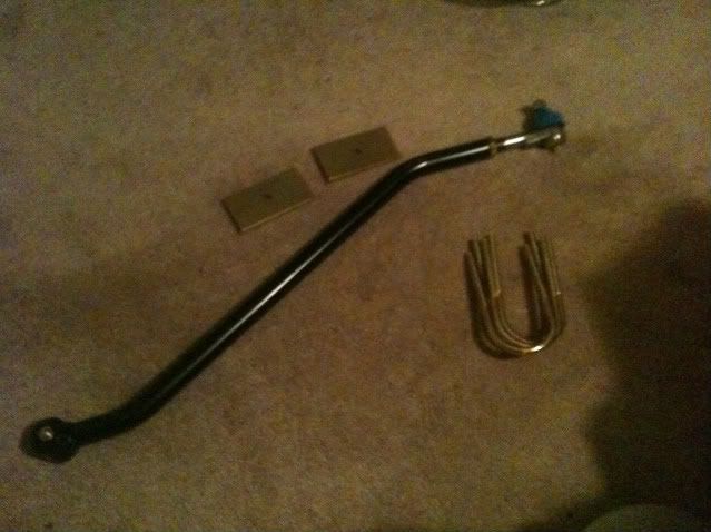

So I got some more stuff today.
Iron Rock Offroad adjustable track bar, shims and U-bolts

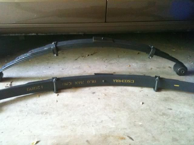

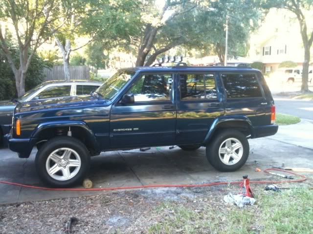

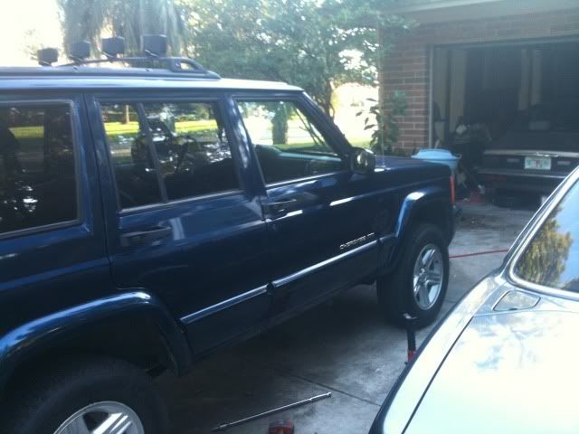

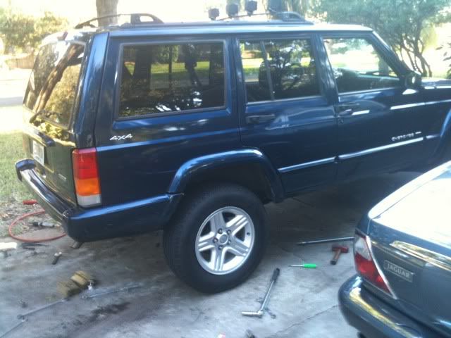

I Installed the OME springs today. In the middle of the job my impact gun decided to crap out
Here they are with the shims on them
And installed
I Think I have too much of a shim here

Looks good! How do the OME springs ride? I've got some 2" OME springs on order. What size tires do you plan on running?
They ride awesome compared to the AAL I had! They are almost, dare I say it, too soft I am planning on running 31s or maybe 32s if they will fit.

Nice! I see you have the NP242, did you get any vibes with the 3"? I'd also keep the stock wheels. They look great with that color.
I'd either go 245/75/R16 (30.5" x 9.6") or 265/75/R16 (31.6" x 10.4")

Without shims I would get some vibes around 50mph while accelerating but none above that, I took it up to 80 with no vibes. My friend has the same rear leaf springs and a NP242 and he got horrible vibes at 60mph+ but he has a C8.25 and I have a D35.

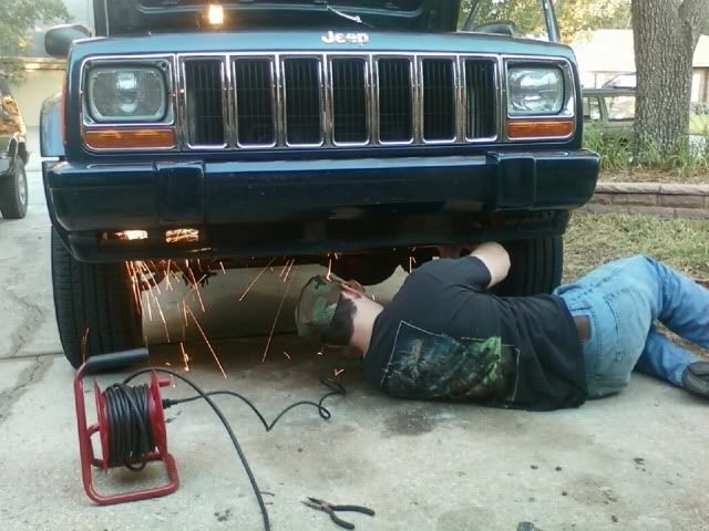

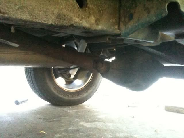

Installed the track bar today..what a pain the the butt. Everything that could go wrong did go wrong. Eventually I had to get a new to me frame side track bar mount since I couldn't get the old track bar off.
Angle grinder required below.
The issue I am running into now is the joint on the frame side will move up and down if I move the steering left and right. The castle nut has been torqued to 100ft/lbs but it still moves.

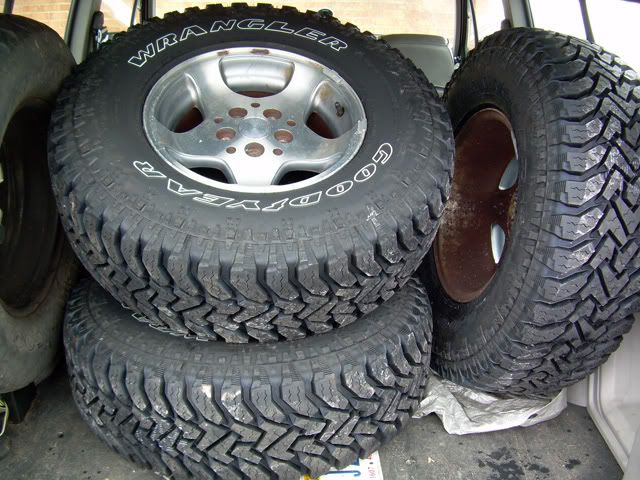

Just scored a slightly used set of Goodyear Wrangler authority a/t 265/75r16 tires for a good deal. It is too dark now for pictures but hopefully I can get them mounted tomorrow!
I pulled some pictures from the internet to show what they look like.

Looks Purdy. For an A/T tire they look really aggressive.
From that pic of you cutting, is there enough cherokee's in that pic? Think there were one or two short of a "Dealership" status.
