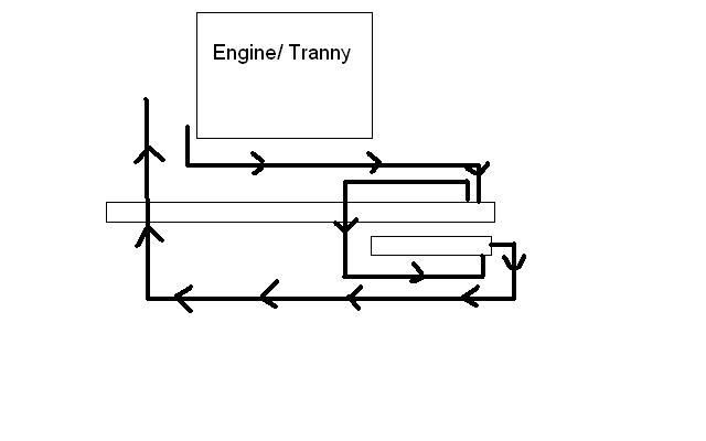

Originally Posted by jeepkid03 View Post
How did you hook up the tranny temp gauge and what kind did you get? I'm thinking of adding a cooler and would like to add a gauge at the same time.
I got an Auto Meter sport compact gauge from summit racing. http://www.summitracing.com/parts/ATM-3357/
And to make installing the sending unit much easier I got the Auto Meter Temperature Manifold Adapter. I just cut the factory hard line and put this on and called it a day. I tried one of the T-fittings from Lowes and that was a waste of time, it always leaked and eventually broke when I tightened it too much.
http://www.autometer.com/cat_accessoriesdetail.aspx?vid=165
This is basically how I hooked it up (it is an old picture from when I had my last xj):

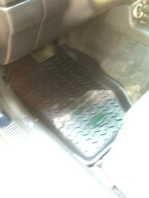

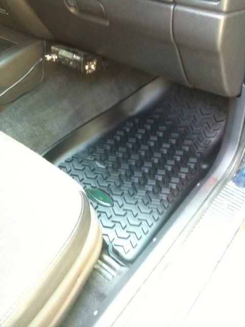

The front floor mats came in today.

you mind telling me where you got those front & rear floor mats???? i really like those. do they only come in black??
They only come in black here is the link.
http://www.quadratec.com/products/14254_7001_07.htm
-Mark
MCrock is offline
post #146 of 1718 Old 04-23-2011, 10:36 PM
UdownwitK
Location: Athens
Posts: 38
thanks. what about the rear mat?? your pic looks like its 1 piece. the website shows separate rear mats...
EDIT: it looks like the onepiece is from a company called Husky. is that the one you have??
UdownwitK is offline
post #147 of 1718 Old 04-23-2011, 10:48 PM
MCrock
Location: Fort Collins
Posts: 407
Yeah he has the one from husky.

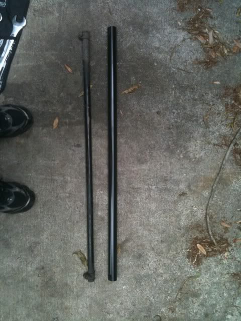

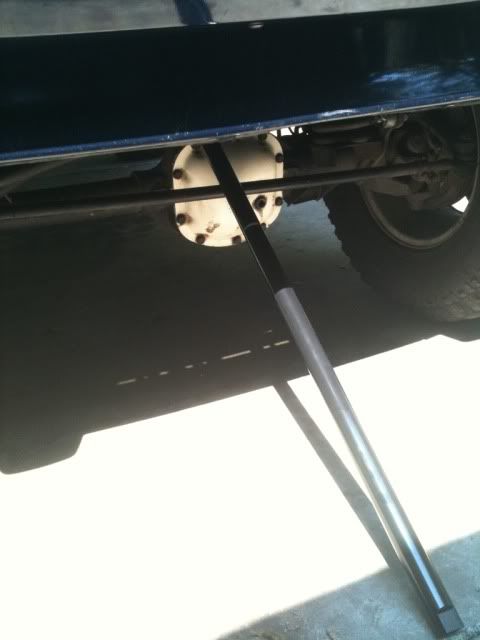

Posts: 7,340
Got the Iron Rock Offroad tie rod delivered today. Now to get the drag link from a v8 zj.

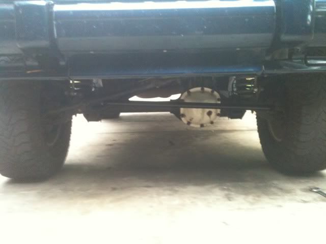

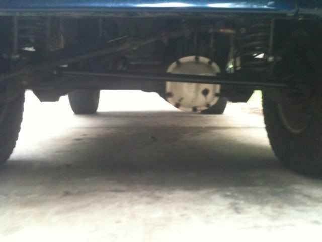

Posts: 7,340
I got the tie rod installed today.
