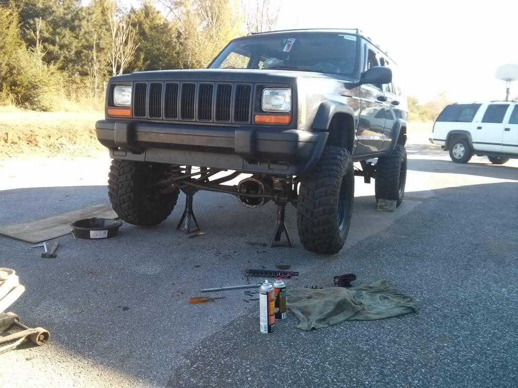

Having trouble with vibrations and grinding noises lately. Opened up the front differential to only find nothing. But I did notice that I had a lot of play between the ring and pinion. Backlash is probably way to much. But its weird because I had never previously opened the diff nor had I messed with the gears and never had a problem until about a month ago. If it continues I will have to disassemble the front again and wait till I get gears and a locker to put everything back in to have 4wd. Really wish my jeep didn't have these problems until I have the time. College is starting to get hefty on my time and dead week is approaching. But it is what it is.

Hey muddy, I had crazy grinding/vibration issues,I thought the same thing being the axles! But I finally tie it down one day putting on a trans drop kit, and found that a trans mount bolt wiggled loose and was causing crazy noises! Not sure is your issue wanted too share mine, I chased it down for months! It's easy to check and could save you time.I also cleaned the bolts and lock tite, so those suckers wouldn't come loose again! Btw rig is looking sick now! I'm really considering those iro long arms. How's the ride now with la's and bills?

Good suggestion, I'll look at it. It is starting to get pretty annoying and scaring me a bit. The thing is, it really started after I put the Baja Claws on and not sure if its from the claws being so aggressive. Will have to further investigate this weekend.
