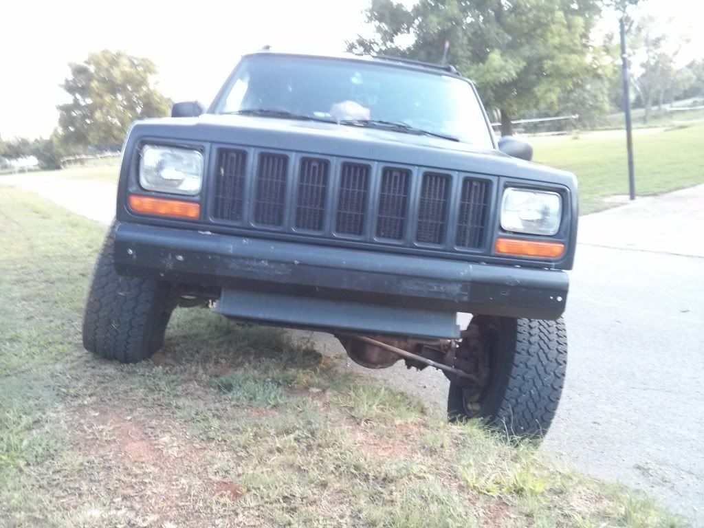

Flexed it out for the first time since the SYE install and redone rear. Its maxed out in the front with more possible shock travel but the rear is a different story. Shocks are limiting me in the rear. Once the long arms go on and I can fully max it out to take measurements, I will buy new shocks.

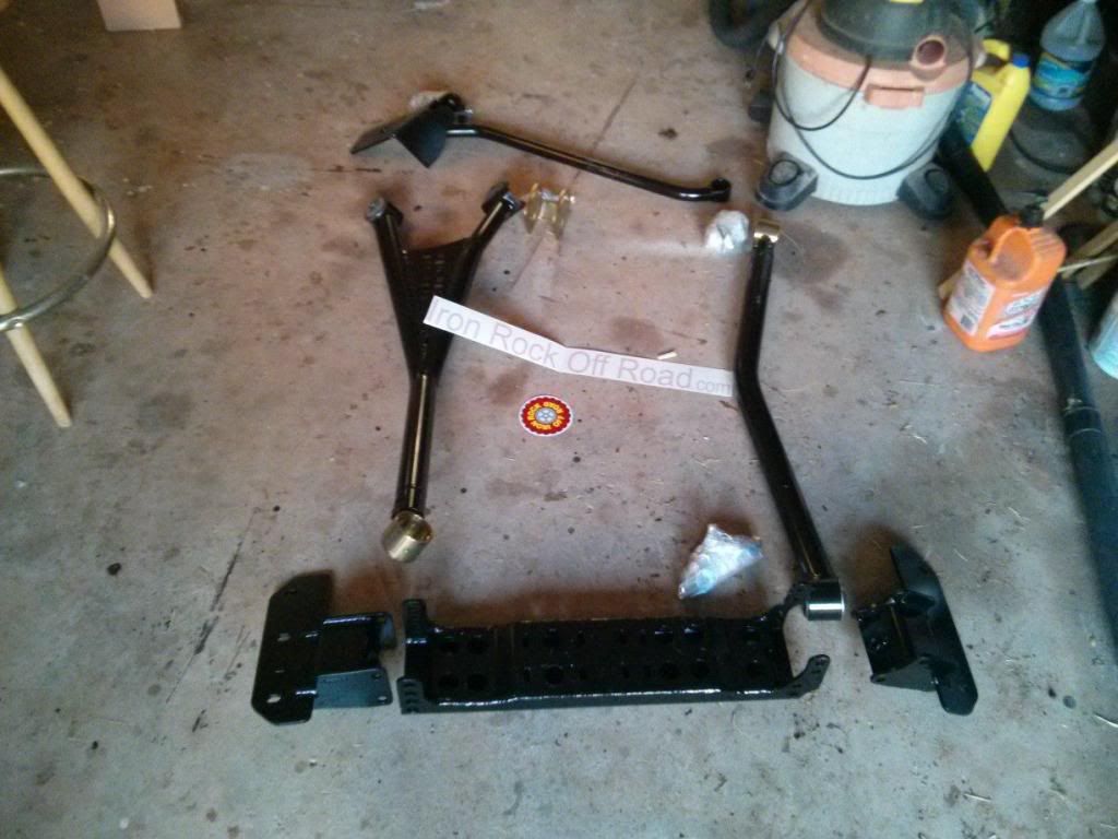

ya buddy! Look what came in today!

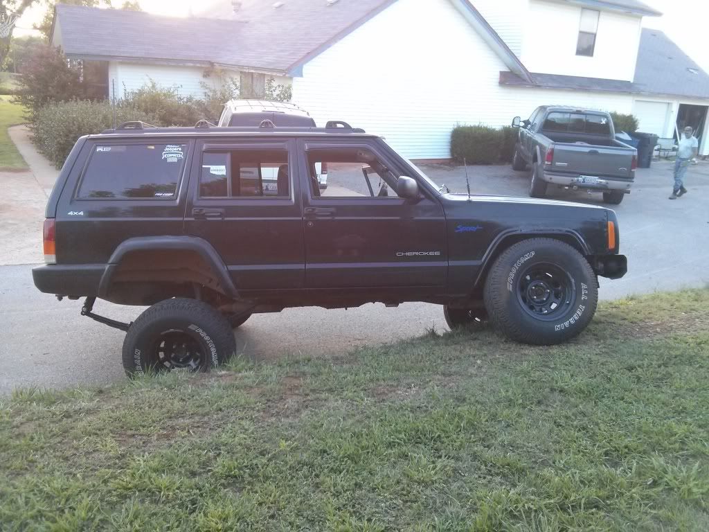

Got my IRO long arms on! It was another mod that took until the early morning hours to finish! I wanna say it was about 230 when I backed my jeep out and was drive able. Here's a before and after. Sorry about the second pic being dark.
Before:
After:
Haven't measured it to be completely correct but the RC 6.5 coils are probably putting me at almost 7".
The JK Rubicon shocks didn't work so i am borrowing my buddy's shocks that he had on his 6.5 X flex kit until I get new shocks.
After a long night it was then off to Tulsa for the flex competition and a little bit of night wheeling. This trip was the first long haul with the long arms since it was the very next day and not even 12 hours after I put the lift on. For the whole 2 and a half hour drive I was very caution as to what would happen since I hadn't got my jeep over 60 with the long arms. Turns out everything was just fine. Got up there and started taking my shocks off to measure what length my new ones need to be. The one thing that i didn't get, because of UPS' mistake, were my front brakelines and I needed them bad. unbolted the front lines and hoped that it was enough for me to flex to get measurements. And I think they were just enough.
If you look closely you can see my passenger brake line stretching like a guitar string. Also unseated the coil! I wanna say that is max and the measurements sound about right to my buddy who is also at 6.5 lift with LA. It scored 899 on a 20* RTI ramp. I say that my brake line could have been limiting me just a little.
