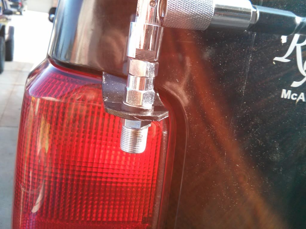

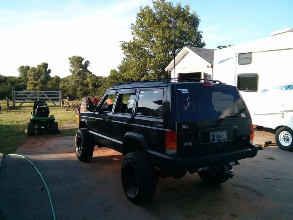

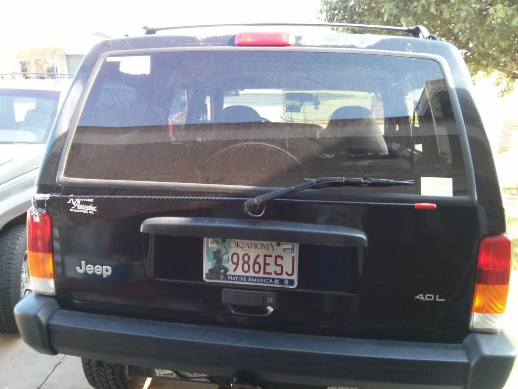

Rear is done! Only after a hassle with my damn old leafs. All 4 bolts were stuck onto the sleeves after I un-threaded them. But made quick work of them with a cutting wheel and grinder on the bolts and forced the eye's out. Worked out good for one side, the other was more difficult after prying out the leafs. While doing so I ended up stripping the threads off the front eye nut. So I had to cut a little trapezoid out from underneath the nut. Knocked the welded nut out and replaced it. After that is was a cake walk beside Rough Country's screw up on the relocators. Whoever welded the nuts on didn't weld them straight so it made it a pain in the ***. Just re-tapped the nuts and everything went in real easy. Started working on it around 5:00 and didn't get done till 1:30 in the morning. Now I just have to put the brake line in and do the SYE then its onto the front.

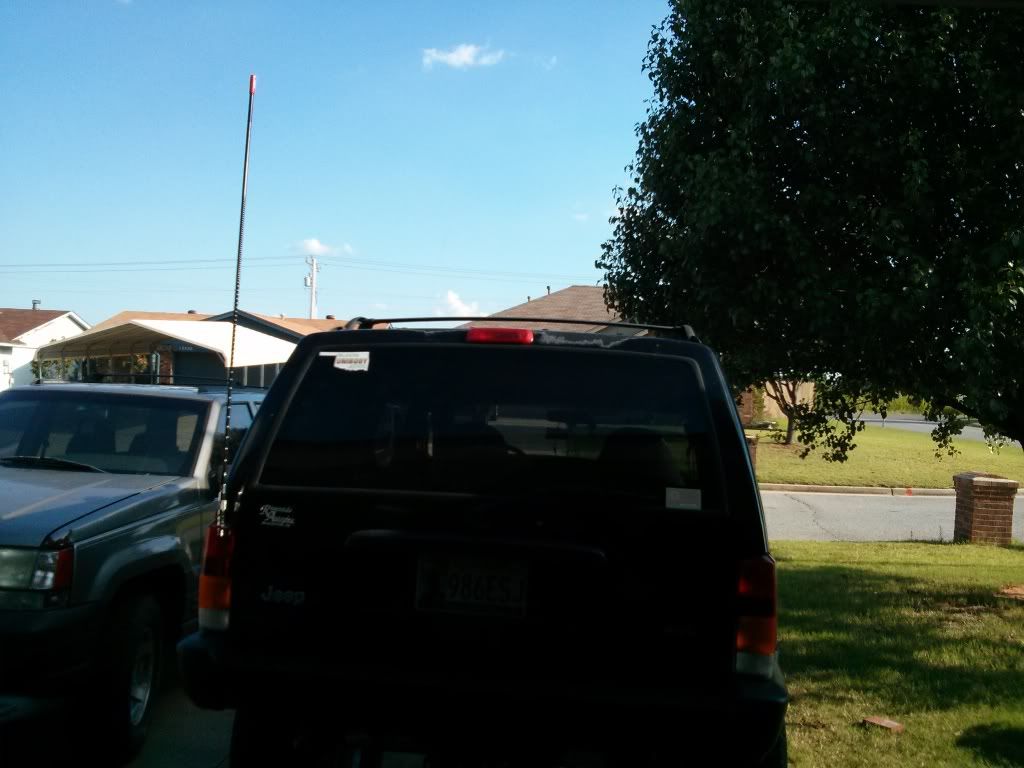

Also put my CB antenna on with a custom mount!
And if I want to go into a parking garage, if i fit, or park inside a house garage I will never hit the antenna on the roof! Also makes it so i will never break my antenna while wheeling.

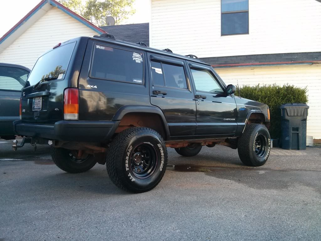

Forgot to mention that it was a pain in the *** to put the "recommended" OEM bushings into the Old Man Emu leafs. Had to use a socket and ball joint press kit to get them in.
I got 6.5" of lift (over stock, 2.5" over original lift) from the upgrade and can go up to 7.5 with the adjustable shackles and higher with the relocators. But for now I will stay at 6.5 and move it up when I get a bumper and other miscellaneous add on's to compensate for the weight.

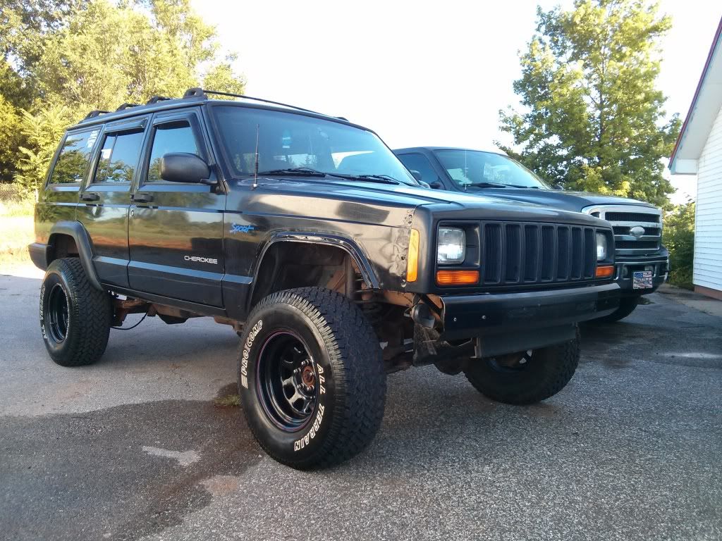

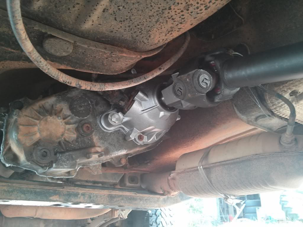

Ordered my SYE and got it from UPS last week. Just put it on yesterday!
Now I can flex and wheel again without the worry of my DS falling out!
I will say it went easier than it did my rear leafs but just a tedious job. Didn't get done till 1:30 in the morning again. Now its all about getting the front done and seeing what shocks I need. Hopefully I can have my jeep done before August 10th and be ready for one of my not so local oklahoma clubs flex competition they are having. $100 to the one who can score the best on a 20* RTI ramp!
Currently trying to find a long arm upgrade I like. Looking for one that has good crossmember set up.
Any suggestions from any onlookers?
