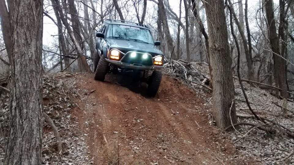

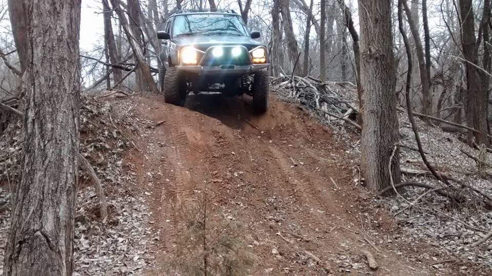

So I'm finally back and may be a little more active on the forum, or hope to be. Been really busy with college, work, and my personal life and not much has happened or changed on my jeep. Still haven't done my WJ knuckle swap but plan to do it soon, hopefully when i get the time. But I have gone wheeling a couple times. Here are some pics.
My buddy in his TJ sort of ran into a tree
Then i got a little stuck.
Broke my taillight and smashed in my hatch in that hole.
Then got some snow and had to take some pics
And my new wheeling partner and hunting dog who loves my jeep to the point where she lives in it when she can

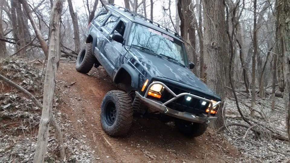

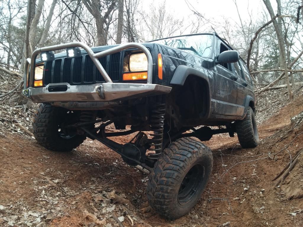

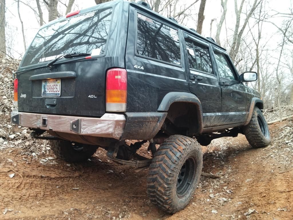

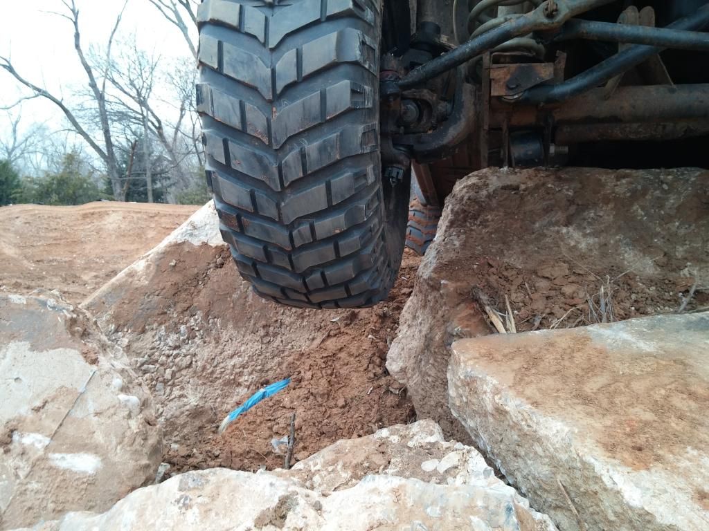

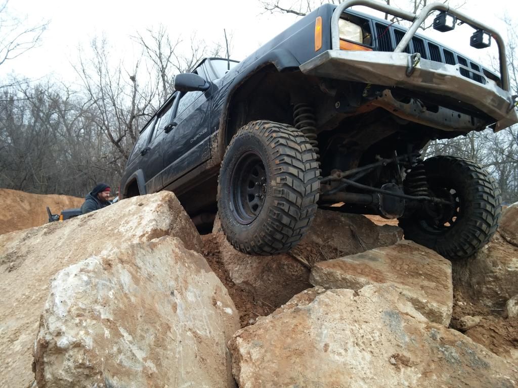

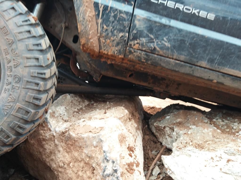

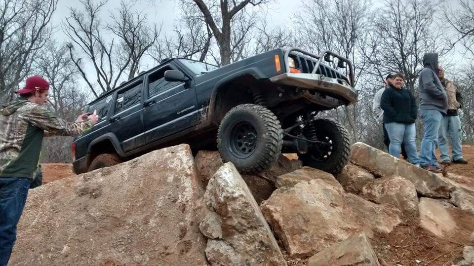

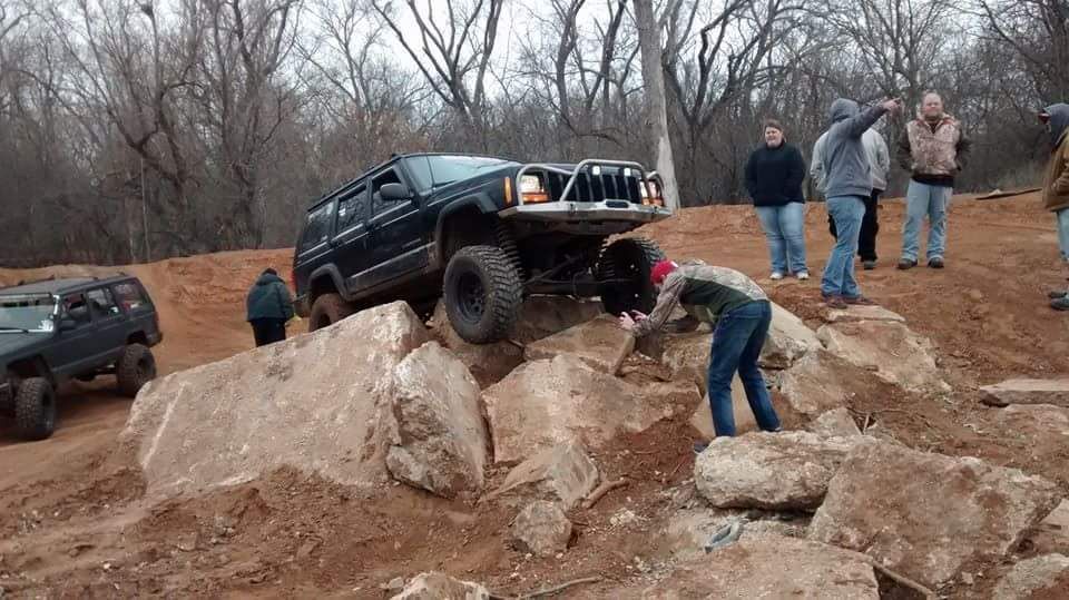

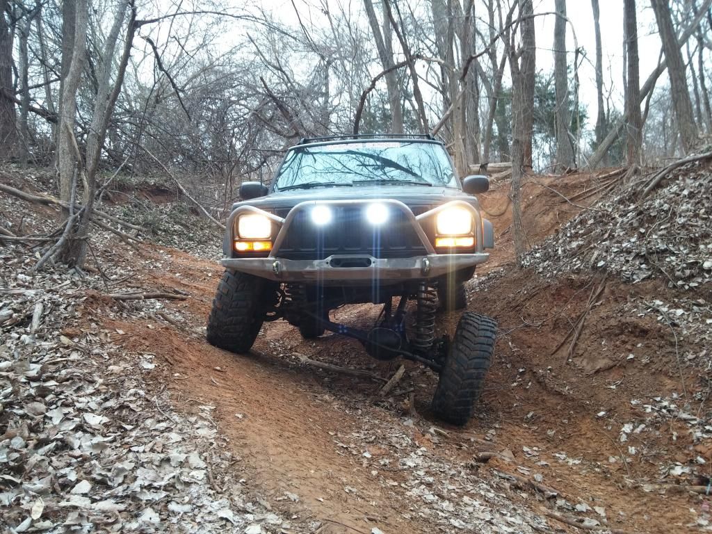

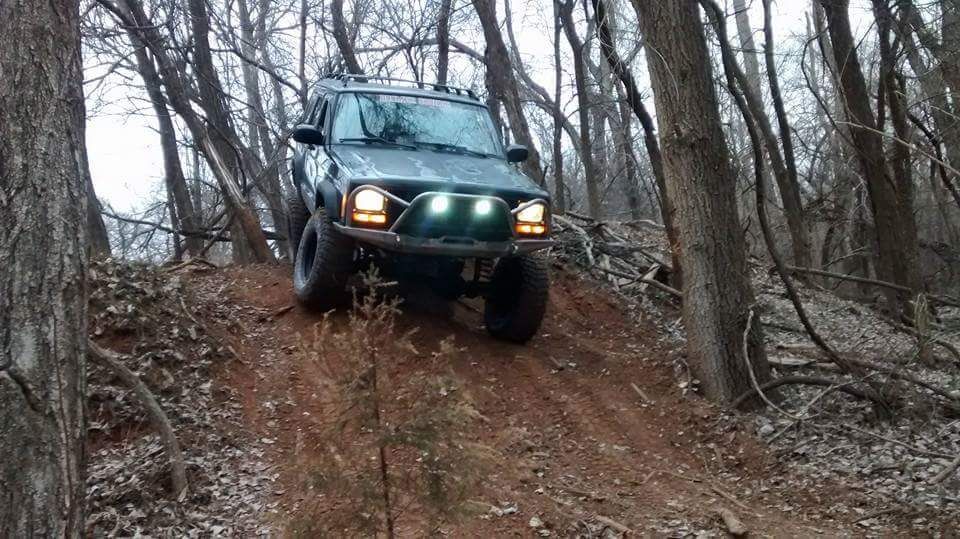

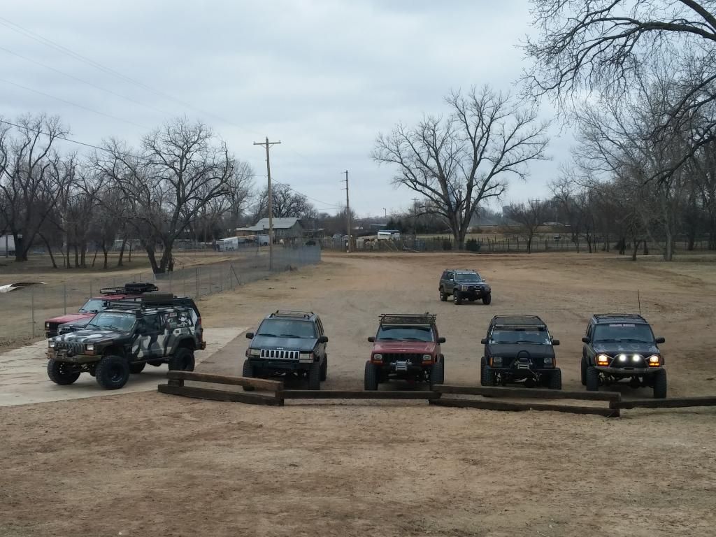

Went and did a quick little shake down run before i go wheeling again to some unknown terrain next weekend. Was our 3rd Annual Oklahoma Unibody Jeepers outing. Had a quite a few unibodies show up.

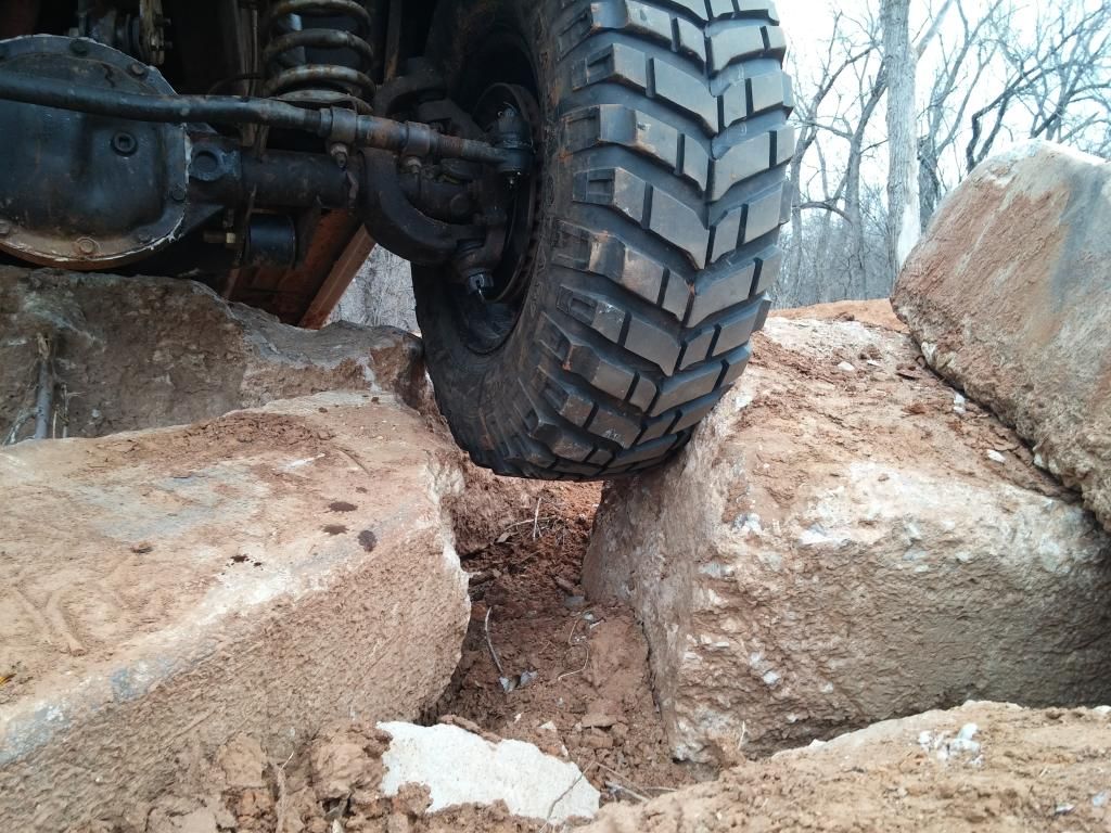

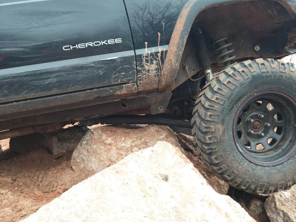

And got caught up on some rocks and scraped up my long arms real good.
Resting completely on the long arms and both front tires hanging in the air.

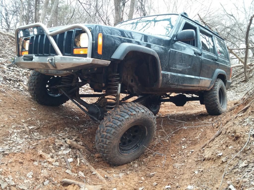

Then found a good little spot to get flexed out at. Pretty much max but have a tad more droop in the front. Rear has more droop but couldn't get it too.
Jeep ended up running and performing just fine. New ball joints held up great and no more popping! And the headgasket and freeze plug held up fine for the most part. Seems ready for some harder terrain in my opinion once I do do the headgasket, freeze plug, and rear main on Wednesday. On the way home the freeze plug and radiator cap did blow out and I lost most my fluid but limped it home to get some water in it to make it to work(AutoZone). Pulled the lower radiator hose to drain it all, its currently 5 degrees outside, and threw in some stop leak and new antifreeze till I get it all sorted out. Sucks that it would happen 48 hours before I would fix it though. But next step in build, fix the engine.

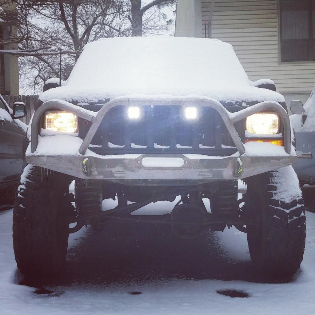

Got a little snow a few days ago. And some more today.

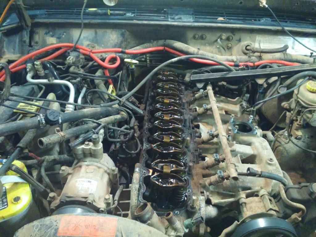

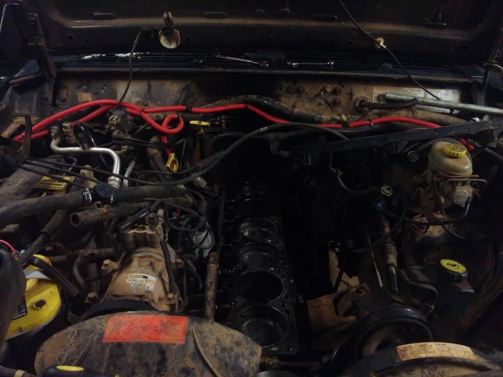

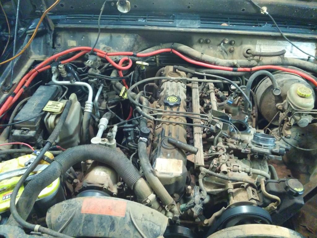

And I did the Headgasket and swapped out the rear freeze plug.
Everything went nice and smooth removing and reinstalling everything. Turned the key afterwards and it started right up on the first turn. Was so ecstatic. Let it burn through most the gaskets then shut it off for the night cause it was 2 in the morning. Started it the next morning and started right up. Then did an oil changed and hooked up the exhaust. Let it run for 10 more minutes after a short test drive then it died on me. Thought I royally screwed up and blew it all. Couldnt get it to turn over. It would just crank and crank and never turn over or fire on 1 cylinder. Spent 6 hours going over everything I did and cheking everything. I had a friend check the spark and he said it was fine; that was when we first started looking for the problem. Then I checked the spark 6 hours later and found out it was barely sparking. Figured the ignition coil was bad so I replaced it. Then boom, got it to fire on a cylinder or two. Just had to reset the timing cause we thought it might have skipped a tooth before hand. Got the timing right and it started right up. Its now running perfect and has never ran better. The coil picked the worst time to go out after replacing the headgasket.

Got more snow today! Went and played a little today and drove around to check out the roads. The Jeep started up perfect in the single digit temps earlier And it ran like a champ all day. I'm finally feeling really confident about my jeep after doing my Headgasket. This weekend I plan on finally re-installing the downstream O2 sensor that I've been putting off for a long time now.
Anyway here's a pic pic of my jeep when I was warming it up today.

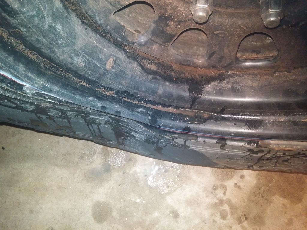

Got more snow today. Closed tonight at work and the roads had already started to ice and have snow build up here in OK. And with no plow/sand/salt trucks running around, the roads had gotten pretty bad at 9:30. Had some idiot pull out in front of me leaving me no room to stop or slow down for him. Ended up avoiding T-boning him but bent my rim in the process. Slid into a tall curb going at least 20 mph. Also bent my track bar or something because my axle is not centered anymore and is a good 2" to the driver side.
